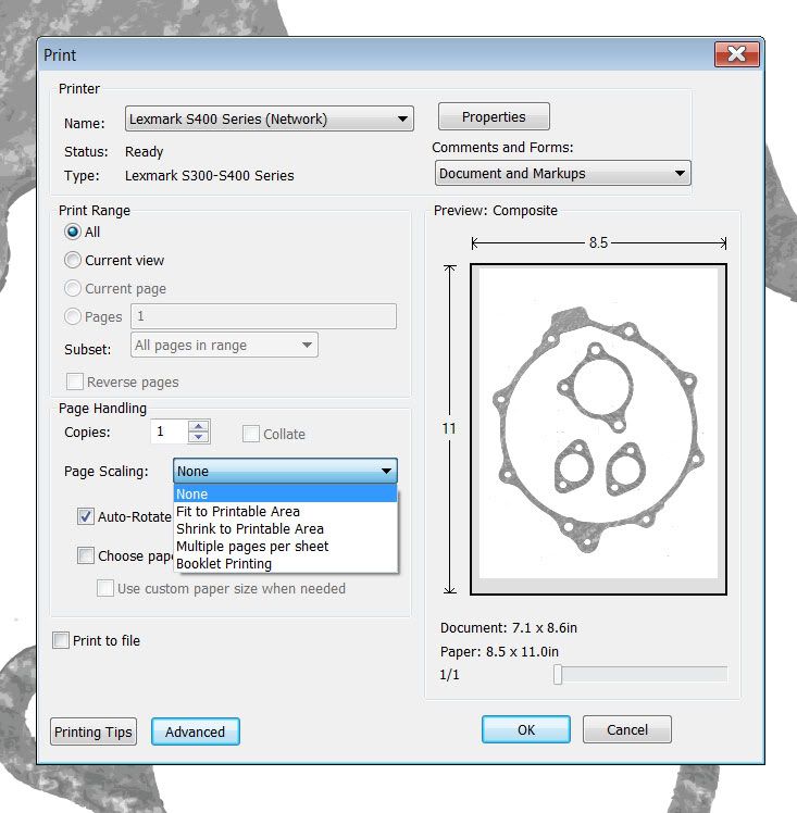

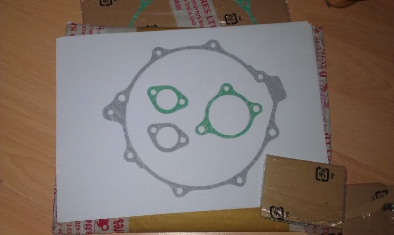

Right ive Stuck them together in one PDF, so its two CCT's a Clutch slave and the Gen gasket on one A4 print out
all you have to do then is cut out with a craft knife or blade
Just make sure page scale is set to none >
Cost of Gasket paper is very cheep on ebay in comparison to buying Factory made items and will be a lot quicker than an order from Dave Silvers that I can assure you!
As long as you tell your printer not to resize them etc, then they will print to scale, i have tested them and they line up perfect

Ahhh bit of a problem, just found out that when i try to print it from anything other than a .PSD file (photoshop) then scale goes well off, so unless you have photoshop you may have issues trying to get them to scale
So will link them as a .PSD file and if dont have photoshop you can nip round to the nerd on the estate armed with a USB stick and some A4 gasket paper
I could measure them so you could set scale, but i dont have a rule to hand and not going looking now.

seb421 wrote:Ahhh bit of a problem, just found out that when i try to print it from anything other than a .PSD file (photoshop) then scale goes well off, so unless you have photoshop you may have issues trying to get them to scale
yeh m8 thats why i suggested using some squared paper to copy / scan them onto... then regardless what size they come out, you will know the paper has 1/2cm squares so will be able to adjust it to scle easy :)

Right I've tidied the PSD files and converted them in Illustrator to vector PDF files making them considerably more compact. Just make sure the printer prints them out real size.

Wicky wrote:Right I've tidied the PSD files and converted them in Illustrator to vector PDF files making them considerably more compact. Just make sure the printer prints them out real size.
