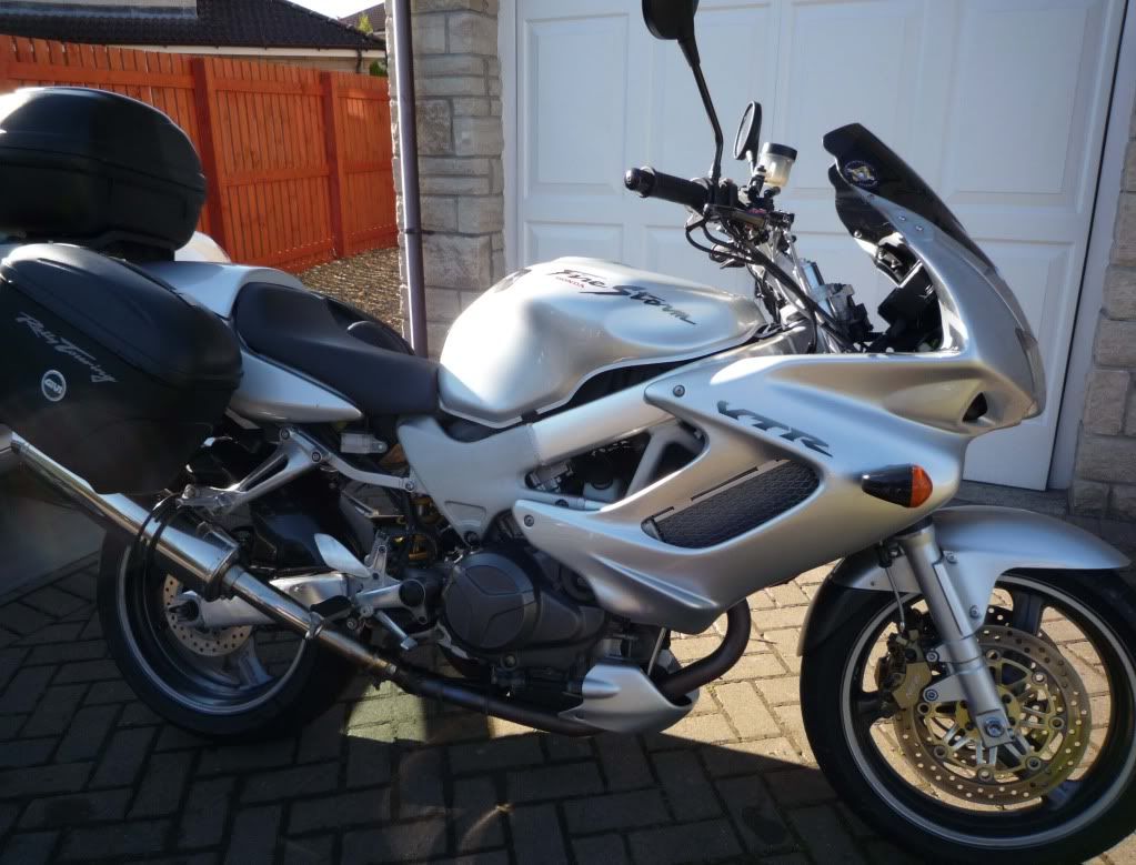

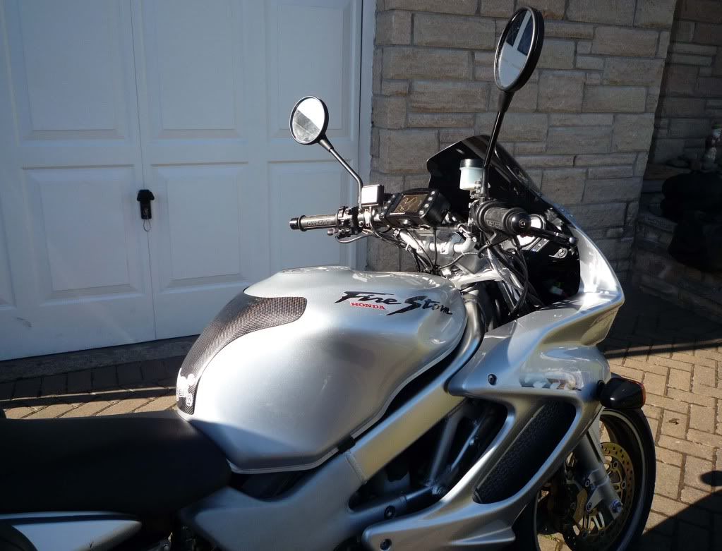

I've made a few mods to the bike since getting it last year. I never was keen on the bars, but liked the bike too much too sell it on. I decided to alter the bike to suit me and what I use the bike for ie. going to rallies and a bit of running abroad, looking forward to again going to Moto Clube Faro Rally on the storm. I took of the standard bars, drilled the top yoke and bolted on risers, 3" up and 2" back. To this I put on some Renthal Superbike bars with Oxford heated grips. A bar across the handlebars made fitting the satnav easy. Changed the brake lines too. Cables all are standard length. Added a set of Z900 mirrors so I could see behind me. Seating position is now for me just right.

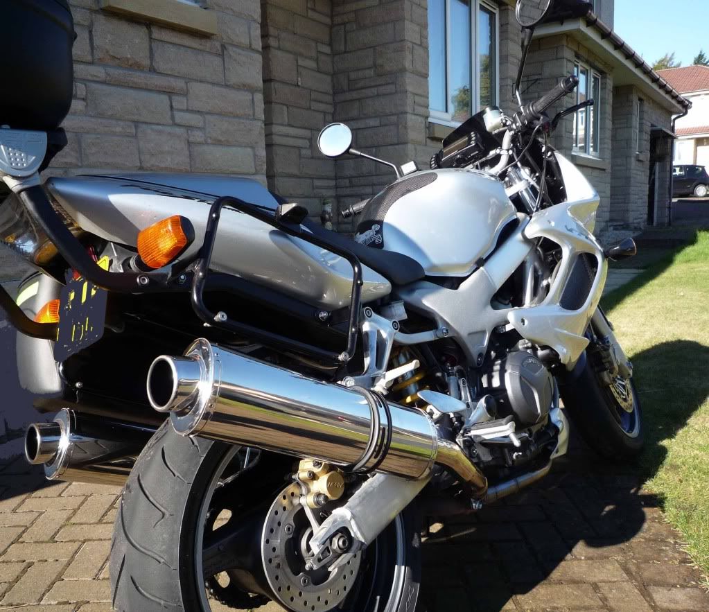

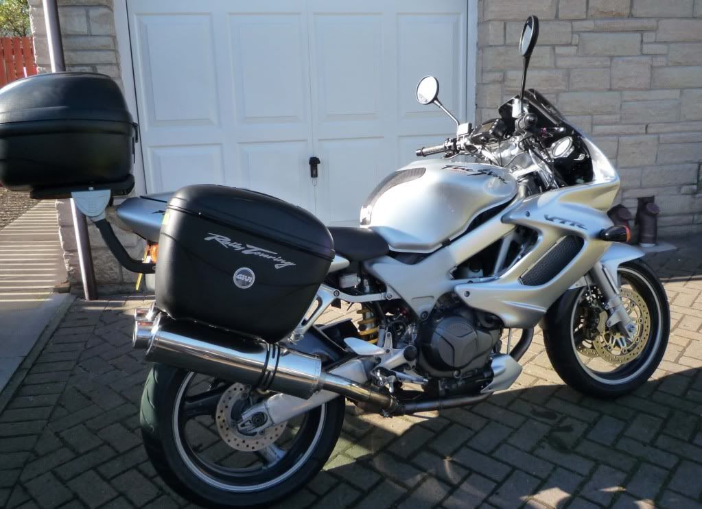

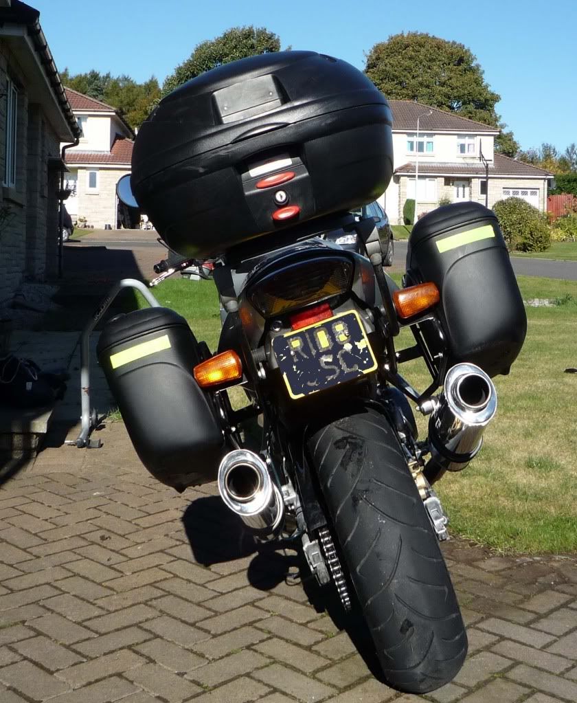

At the rear I bought some rails so I could fit a topbox on. I know it looks a bit too far to the rear, however if I put it any further forward I cannot lift the seat. For the boxes I bought some second hand Givi rails from a Bandit 600. I cut off the brackets and fabricatecd some new ones, had them welded up and hey ho. I chose the smaller cruiser panniers because I never have a passenger on so there is ample room for my bits in them. Top loading too, I like that. Also the sweep of the exhausts meant I am a bit restricted on the box height.
All in all I'm really pleased with how it has turned out, just been on a 1100 miles run from Scotland to Cardiff and Derby with no issues at all.
I know my mods will not be to everyone's taste, but if we were all the same how would that be.

looks great mate your ideas are just what im thinking of the same as you i love the bike so much but it not comfortable for me and i do want to start doing distance and abroad where did you get your risers mate and the bars? :thumbup:

toonarmy wrote:looks great mate your ideas are just what im thinking of the same as you i love the bike so much but it not comfortable for me and i do want to start doing distance and abroad where did you get your risers mate and the bars? :thumbup:
http://www.ebay.co.uk/itm/3-pull-back-B ... 27cb8abaaa
These are the risers I used. One thing though, you cannot lift the tank off with the risers coming back so far, you will need to undoe the risers from under the yoke first. The seller also sells other sizes though.
The bars are Renthal superbike bars. Thanks for the comments..

lumpyv wrote:brilliant, i like the look of that . if and when i dont fancy dropped bars thats just what i would like to do. do the footpegs feel like they are in the correct place relative to the new bars?
The footpegs are good for me, I tend to ride with my toes on the pegs as opposed to the flat of the boot.
