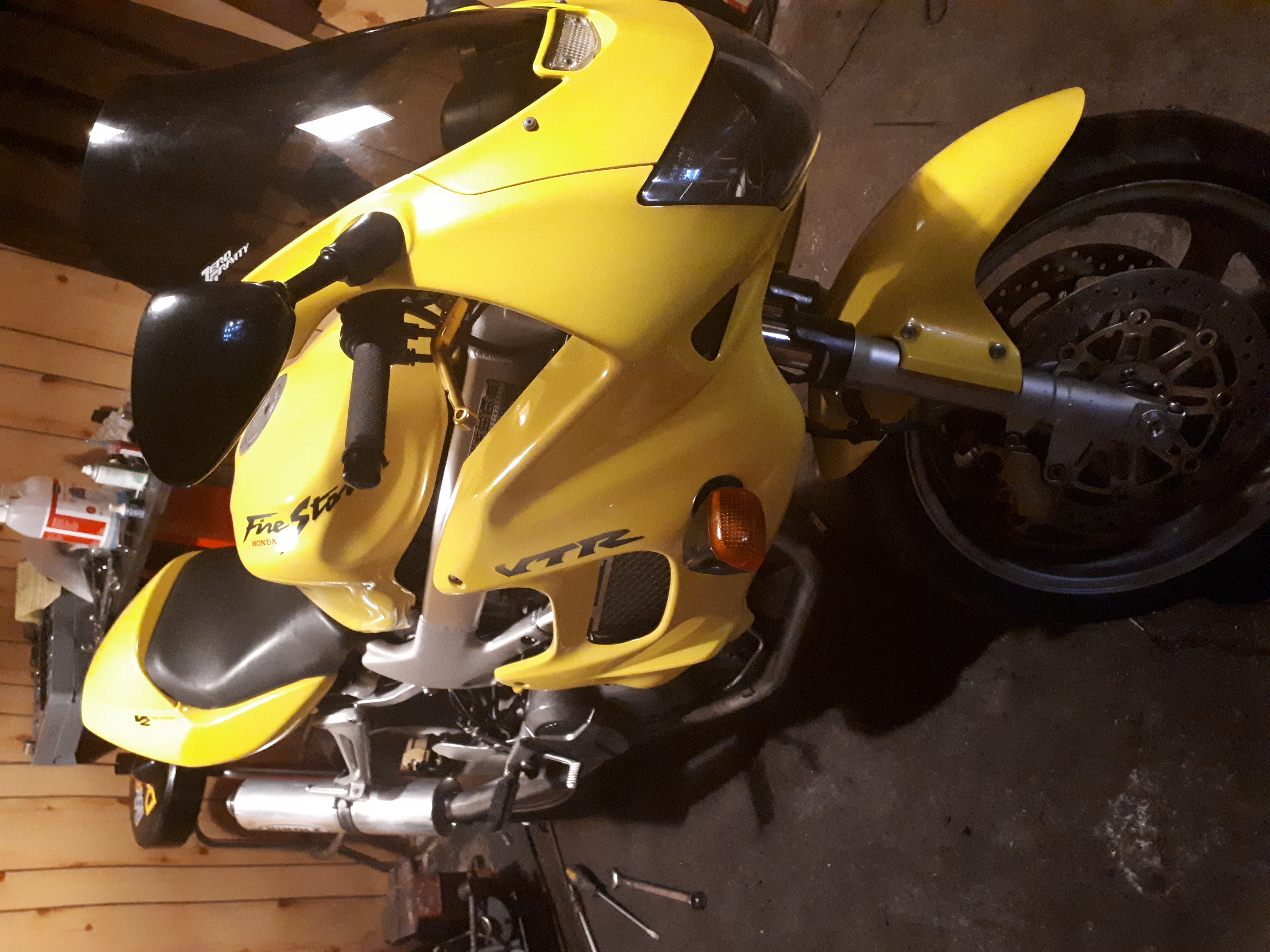

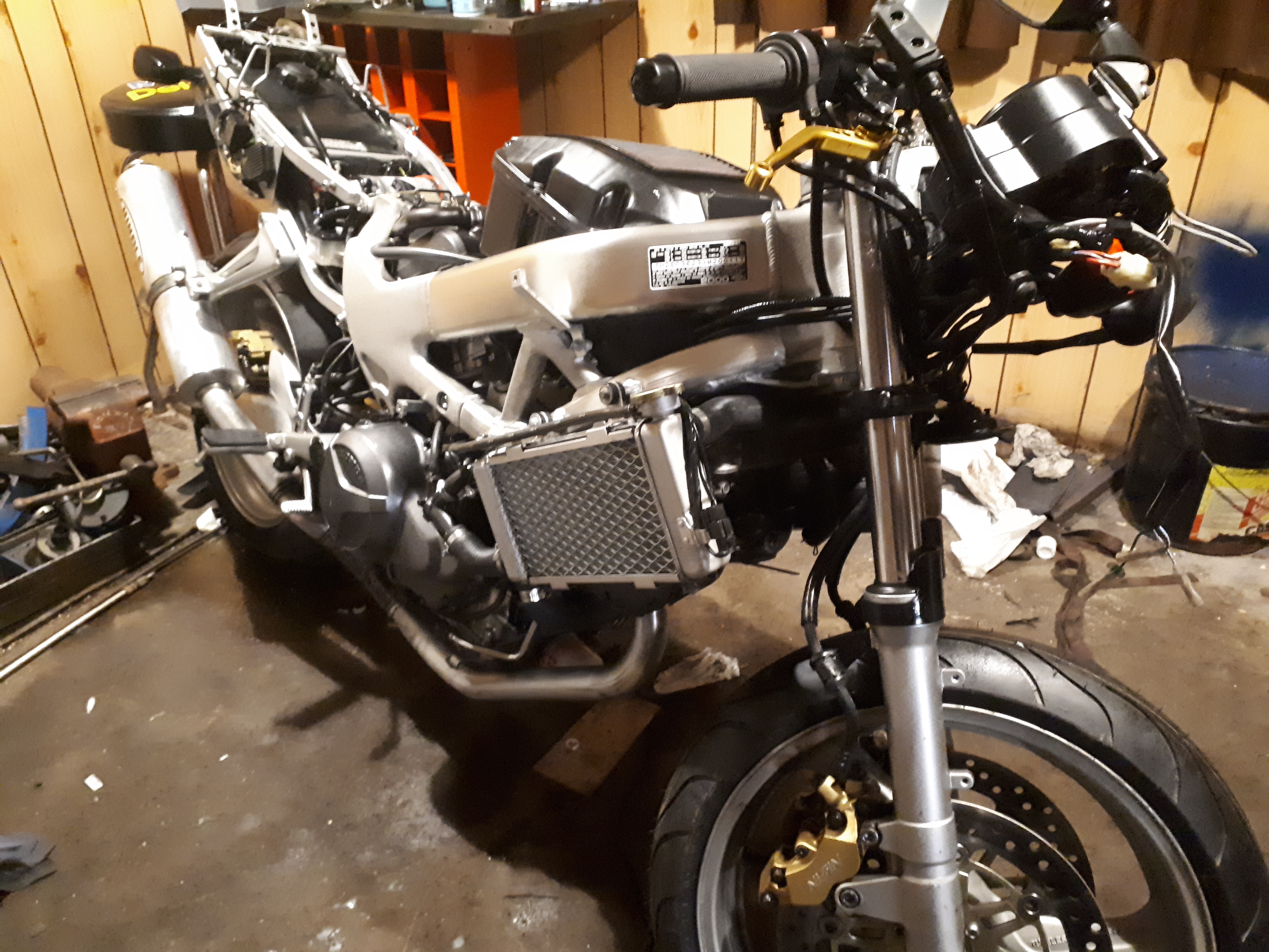

Hi all, I've been doing some major work on the storm this winter. Here's what was done
Engine:

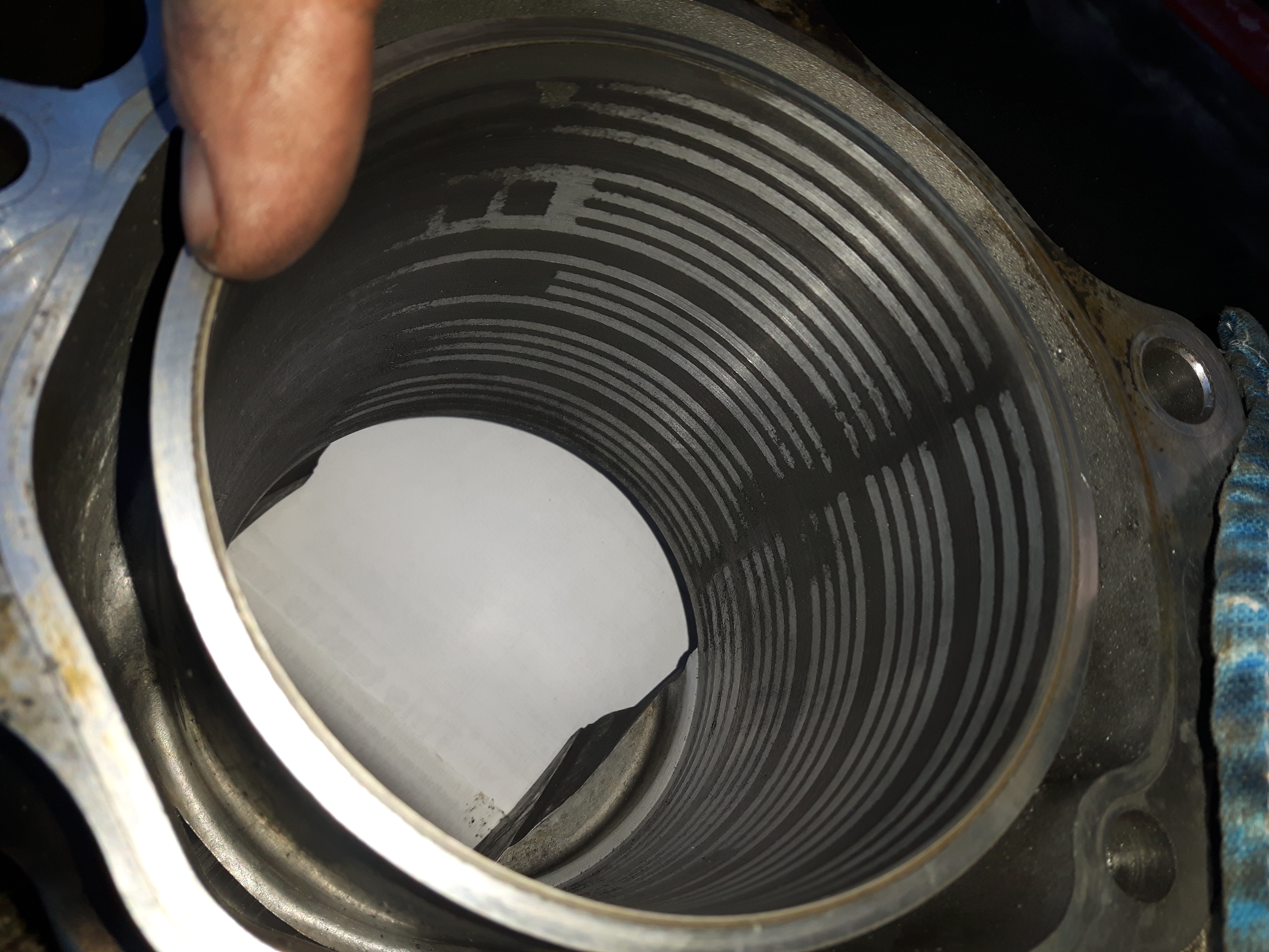

-Engine resleeved with ductile iron bores and bored to 99mm
-Custom 99mm JE 11.5/1 pistons (11.7 with the extra mm)
-Lightened Flywheel.. No idea how much lighter, but it looks like you couldn't take any more off.

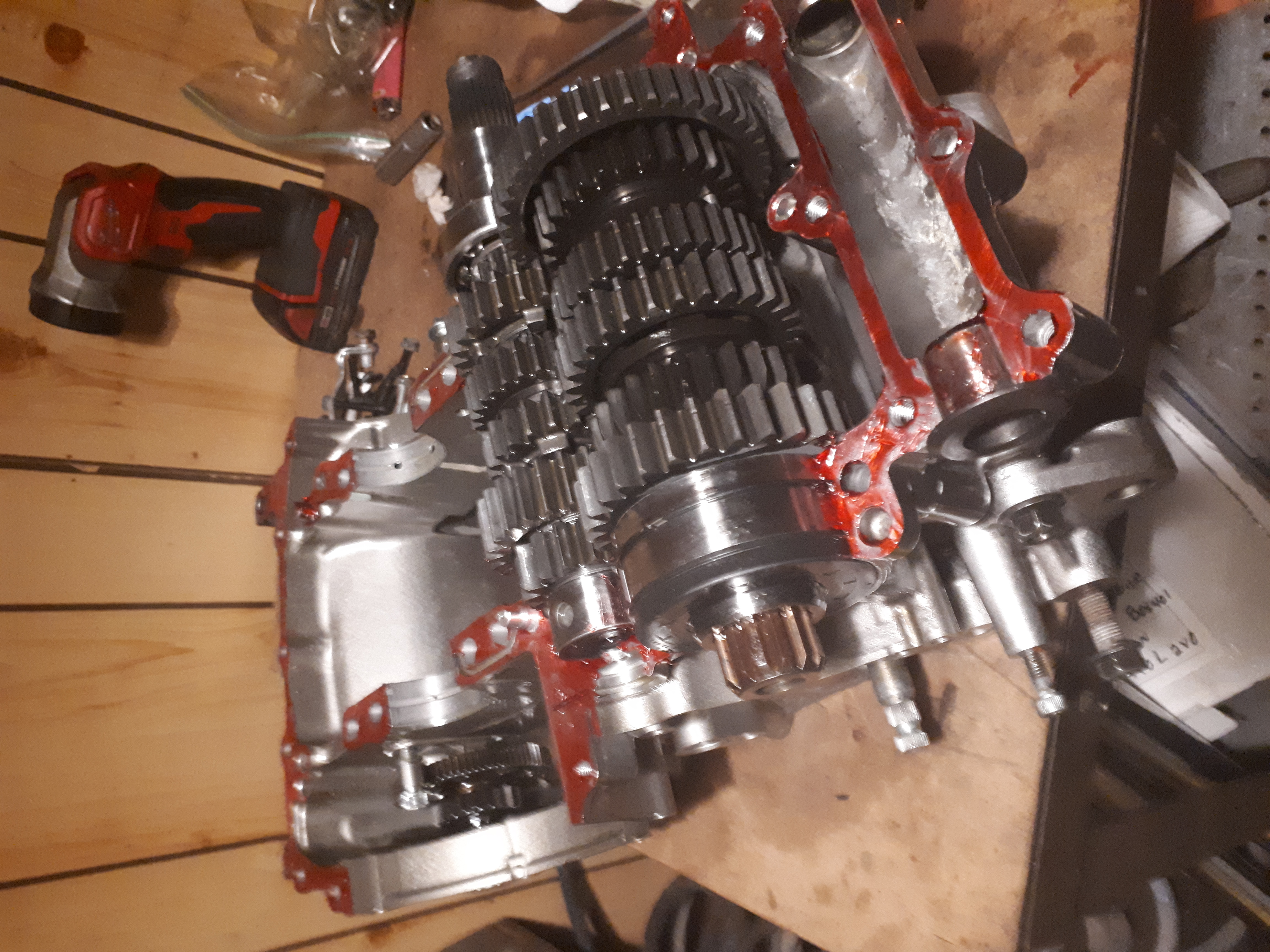

-EBC clutch plates and stiffer springs
-Every single bearing in the engine and tranny.. because I was in there.
Ignition:
-cbr stick coils

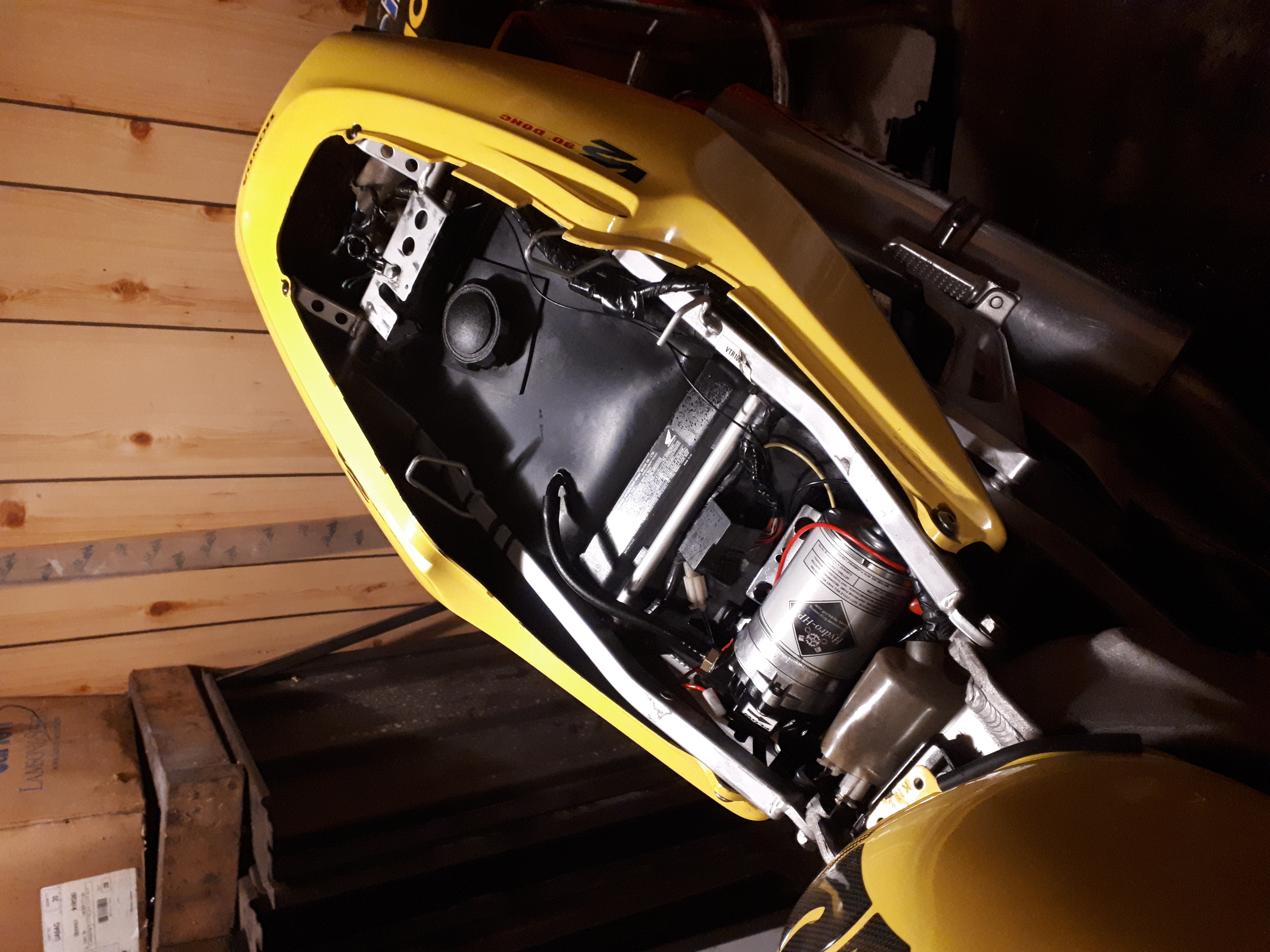

-programable ignitech tci ignition module
-Lithium battery
Handling:
10mm Spacer on rear shock
Thicker fork oil to stiffen dampening on front
All brakes serviced
New rubber
Adjustable levers
Fueling:
Airbox mod, filter in lid

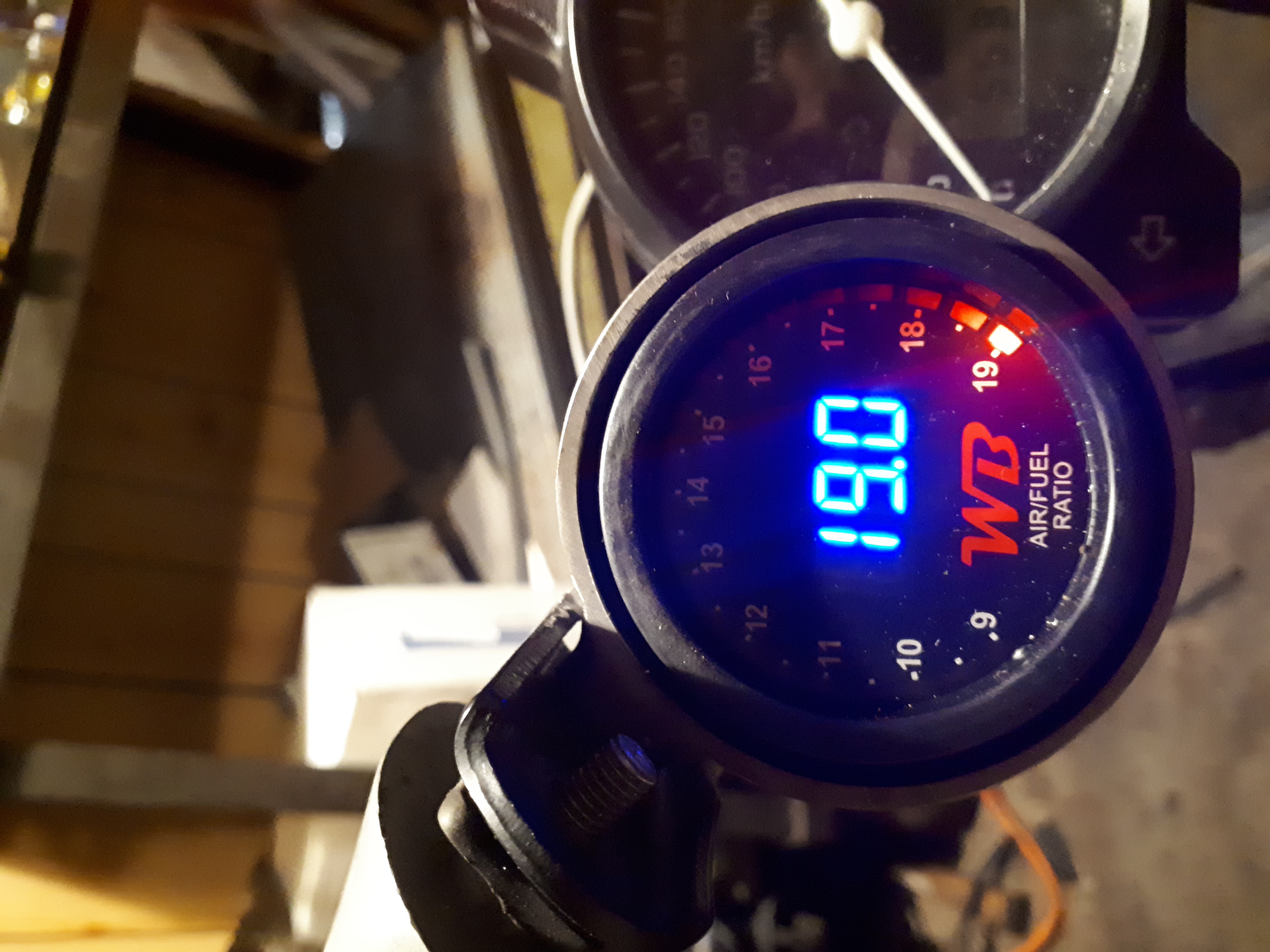

Wideband sensor with gauge
Meth injection to keep things cool and run 87 octane fuel..
Now the never ending fine tuning begins
