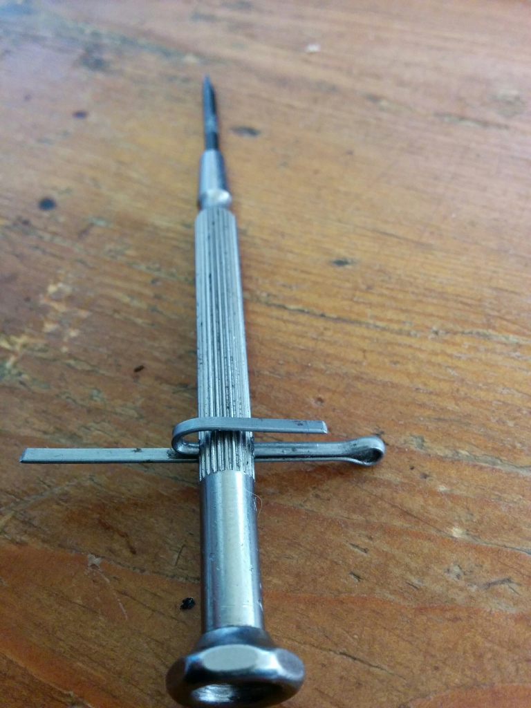

Just completed the stopper mod without using a locking key. Just used a modified jewelers screwdriver. Drilled it for a clevis pin which makes it easier to turn and count the turns.
The rear was a bit of a bugger but the front was easy. Used the shank of an 8mm steel bolt, 10mm long at the front, 9mm long at the rear.
To get the length turn the "key" clockwise until it reaches full retraction. Count the number of turns and fractions of a turn. The worm thread is quite coarse and one whole turn is 5mm of movement. With the CCT now removed and the roll pin and plunger head removed clamp it in a vice. With one hand turn the key to fully retract and then let it out the counted number of turns. With the other hand drop some dial calipers down the hollow plunger rod and note the distance. Take 5mm off that (the distance the plunger head goes into the plunger rod) and you have the nominal length of the stopper rod. Then take a 1/4 or 1/2 turn (1.25mm or 2.5mm) off that and cut your stopper rod.
You have to screw in the plunger rod (clockwise turns of the "key") to get the plunger rod to retract and the CCT body to seat before you tighten up the bolts. Easy on the front, a bugger on the rear. Job done.
The Honda manual calls for 17 ftlbs on these allen screws. I couldn't bring myself to give them that much but hopefully they wont back out.

Re: CCT (Cam Chain Tensioner) Fail Safe Mod. (aka Stopper Mo
KermitLeFrog wrote:Just completed the stopper mod without using a locking key. Just used a modified jewelers screwdriver. Drilled it for a clevis pin which makes it easier to turn and count the turns.

Good on you Ian for trying something different that worked, and taking the time to explain how you did that :thumbup:
The only real downside for me is the bit about fully retracting the CCT plunger, as that creates more tension on the CCT spring. So for me I would rather stick with using a CCT locking key for that reason, and they are not really that hard to make,

sirch345 wrote: The only real downside for me is the bit about fully retracting the CCT plunger, as that creates more tension on the CCT spring. So for me I would rather stick with using a CCT locking key for that reason, and they are not really that hard to make,
I agree. The locking key would have made it much easier and will def use one the next time. One possible advantage of fully retracting the plunger is that, if the spring does have a weak point, a crack or such like, that's when it's most likely to break. If the spring is in good shape it should be unaffected by a full retraction as that would be within the design limits.
