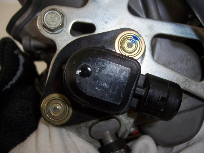

I went out to the shed after reading your post on the TPS adjustment. Slapped the multimeter on the terminals and received a reading of 794Ω as below.
I then was able to reset it to approx. 500Ω without having to file out the slots in the TPS and without having to use the special tool to loosen the two screws holding it in place - replaced them with hex head screws.
It was quite a simple job really, I thought it would be a bit more involved than it was.

Did mine today, bent the left leg a bit and set to 495ohms no problem
Went to halfrauds and made up spade connectors to get a good connection

Tip for doing this quickly....No need to take carbys off. Leave harness connected to TPS. Remove connector from ecu located left rear under seat. Probe corresponding wires with multimeter there and adjust TPS. Takes about 5mins.

When I did mine I just used little crocodile clips, lifted the tank and connected up and adjusted as required. Defo no need to remove carbs.

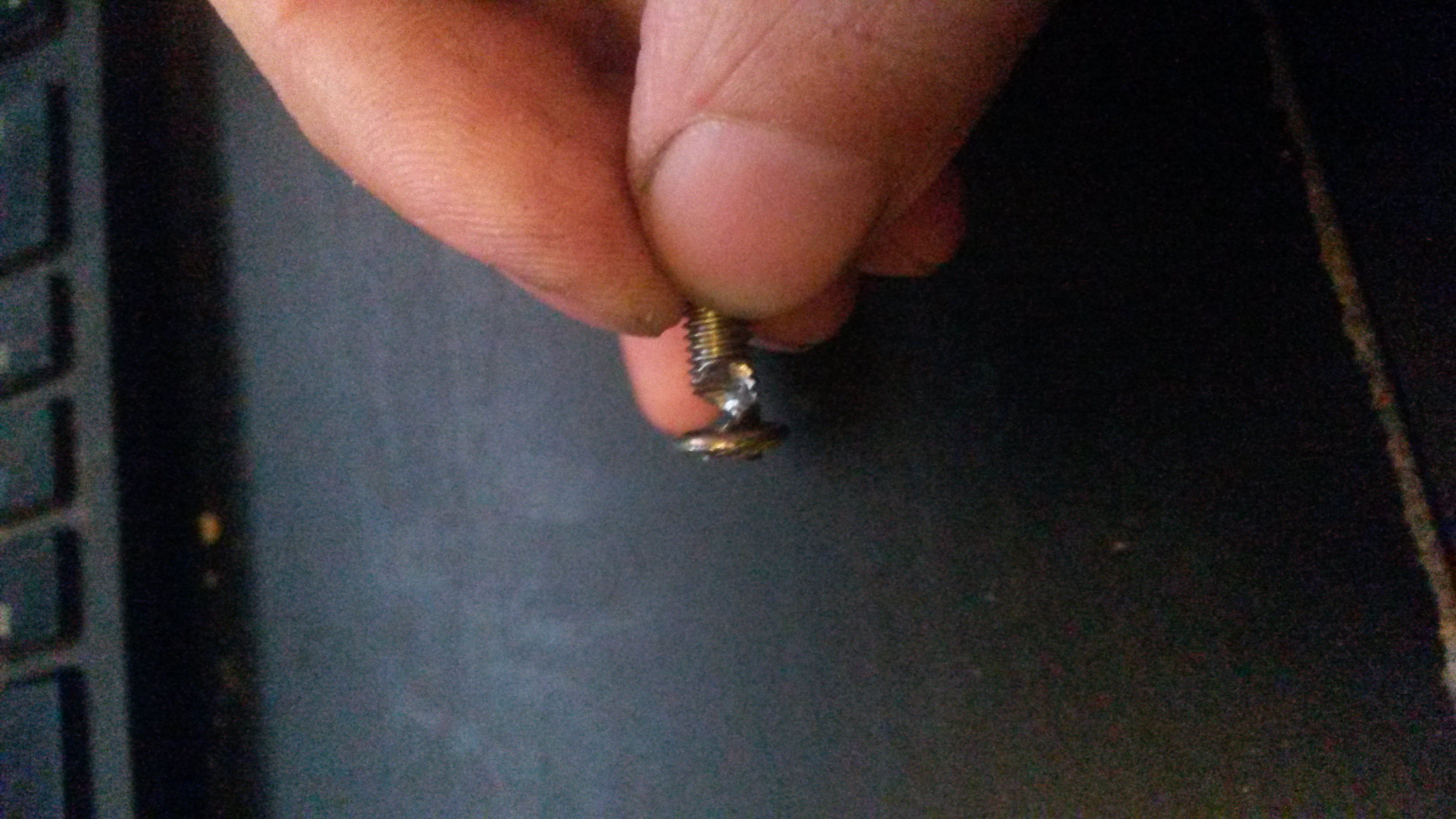

Mine has shear bolts from the factory, I was wondering what size the bolts are so I can go to the hardware store and buy new ones before I drill them out. Currently my truck is in the shop so I can't drill them out and take them with me to the store because My VTR is my only ride currently

They shouldn't be shear bolts, they should be security bolts, like a torx bolt with a pin in the middle, you need a security bit to undo them.

IDK if its because its a US California bike but they are shear bolts

Yeah they really don't want you messing with it. It took me almost an hour to get them off :Argue 1: it was set to 846 ohms and the lowest I could set it was 532 ohms.
if anyone else has this problem drill it down the center that way it will loosen itself when the head of the screw starts to bend up under the pressure then you can unscrew it by hand
The bolt size is M5 .80
