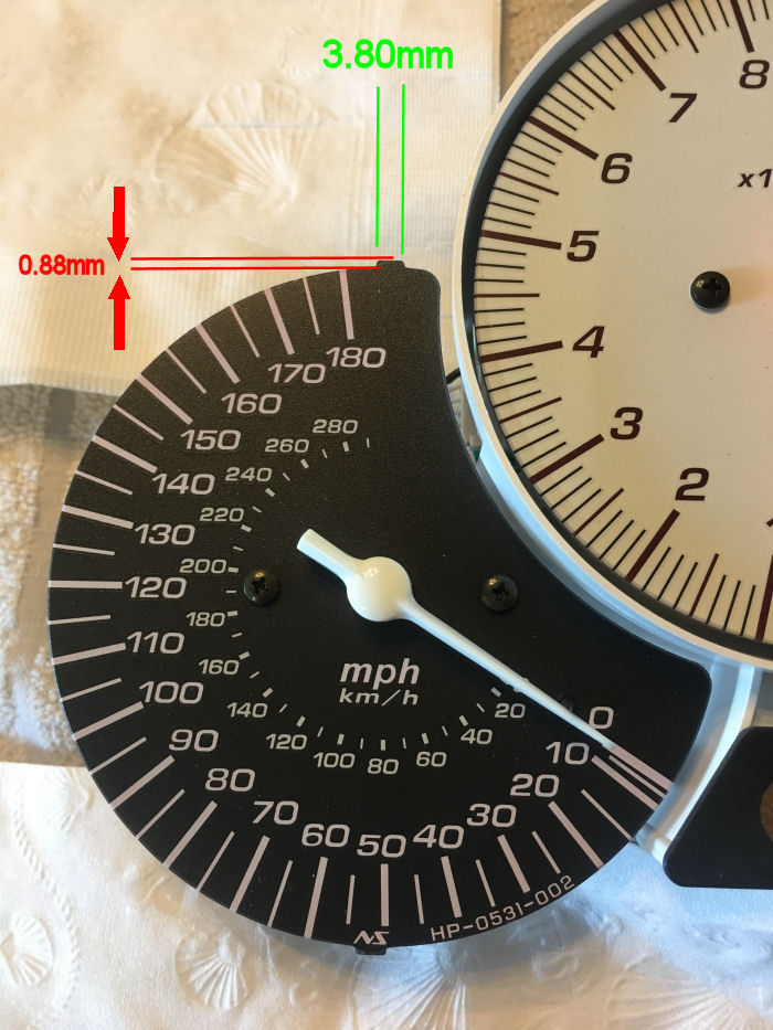

What's the diameter of the speedo face plate in millimetres?
Once I have that I can work out a vector drawing in Illustrator
Re: speedo face removal & replace
86.41mm measured by a pair of Mitutoyo calipers.

and there's a tab at the top how much does that stick out?

Do we need the location of the two tabs as well?

If you can just take an overhead view picture square on of the speedo plate (if it can be taken out) agianst a white background then I can figure out the tabs placement and size.

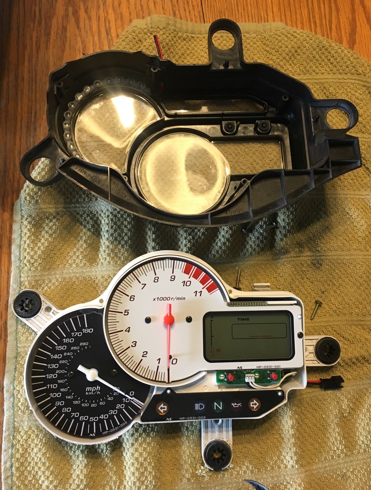

Have this for now

That's all I need

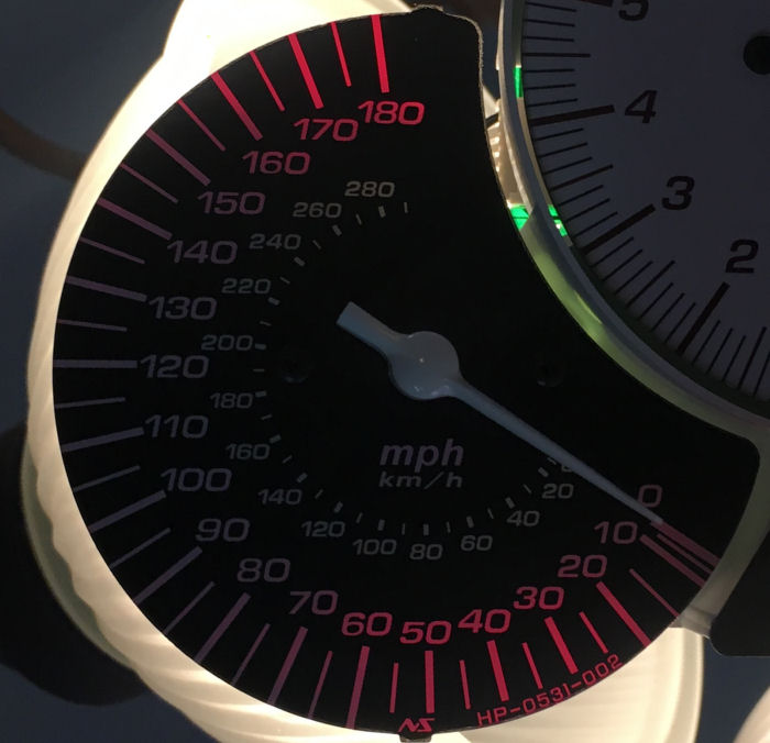

Lastly what the colour of the white hatches and numbers when lit from behind? Red?
Here's the standard speedo modified but retaining the OEM range
Next I'll make the 180 - the new 160 and rejig the spacing for the interim speeds

Nice job...looking good.
Red backing works for my set up as I have bright LED replacement lights and the top mounted LED lights as well.
The upgraded back lighting alone did little for me on this later gauge because of the plastic colorization.
I think a mat clear backing would work as well as users can get any color back lighting T5 LEDs they want.

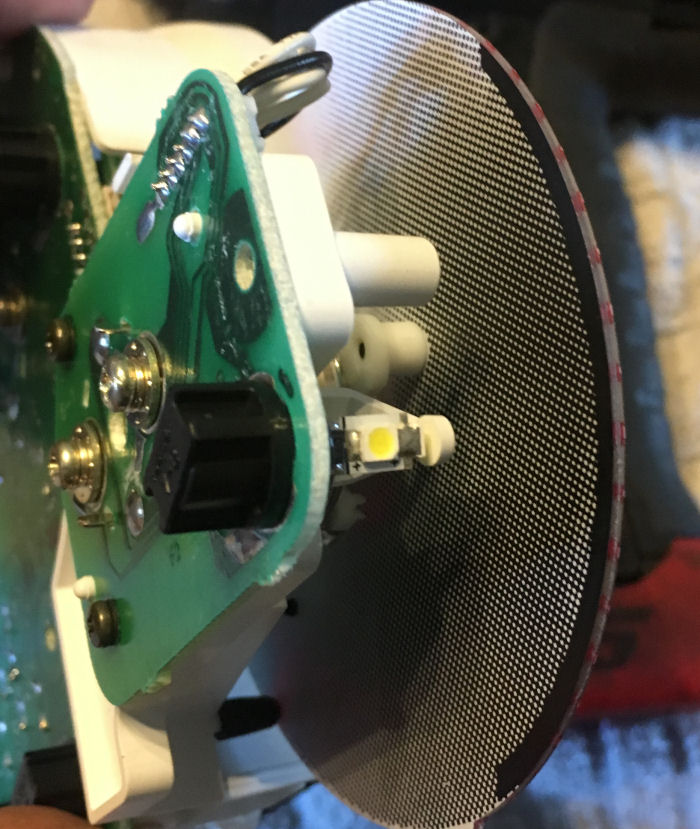

The dodgy b8stard used only one light for illuminating the speedo face from he rear
And the face seems to be a clear plastic base with a layered mask set up.
The back side as a white and varying spaced black dot matrix I assume is to diffuse and evenly distribute light though the face from the one light bulb. Then on the front side it appears to be a red layer and white layer mask on top, so the face numbers appear white unless back lit and it is dark out side. Mat black mask for me I think on the face...
and red translucent plastic if its available as I have gotten used to the red back lighting and front side white LED light at night . If the red plastic is not on hand, do it in clear and I'll pick up a few LEDs in different brightness and colors and see if it works.
With only one OEM light bump lighting from the lower left edge, it will be interesting to see how it looks without the layered set up Honda used.
