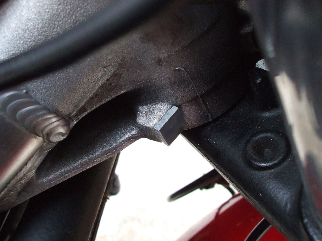

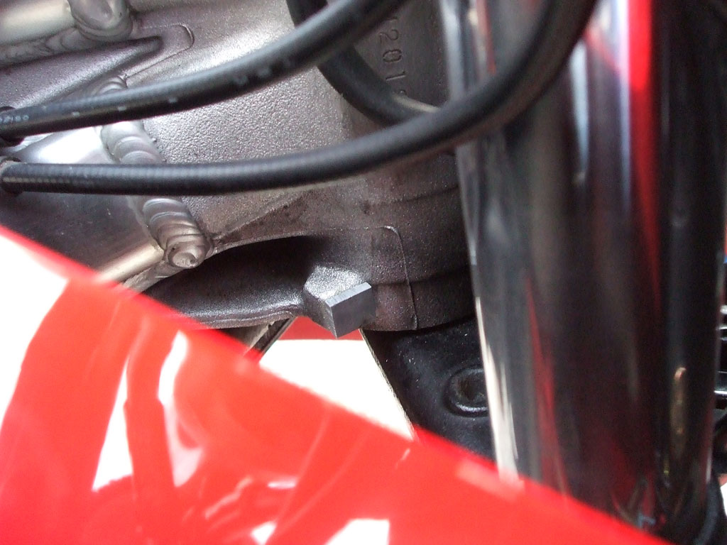

I've been meaning to add a couple of photo's, so I took some :)
I used a Contact Adhesive to fix the steering stops in place, I preferred that to Araldite as you don't need to secure the stops in place waiting for the glue to go off, although that side of it is up to you.
I fitted my stops when the fairing was off.

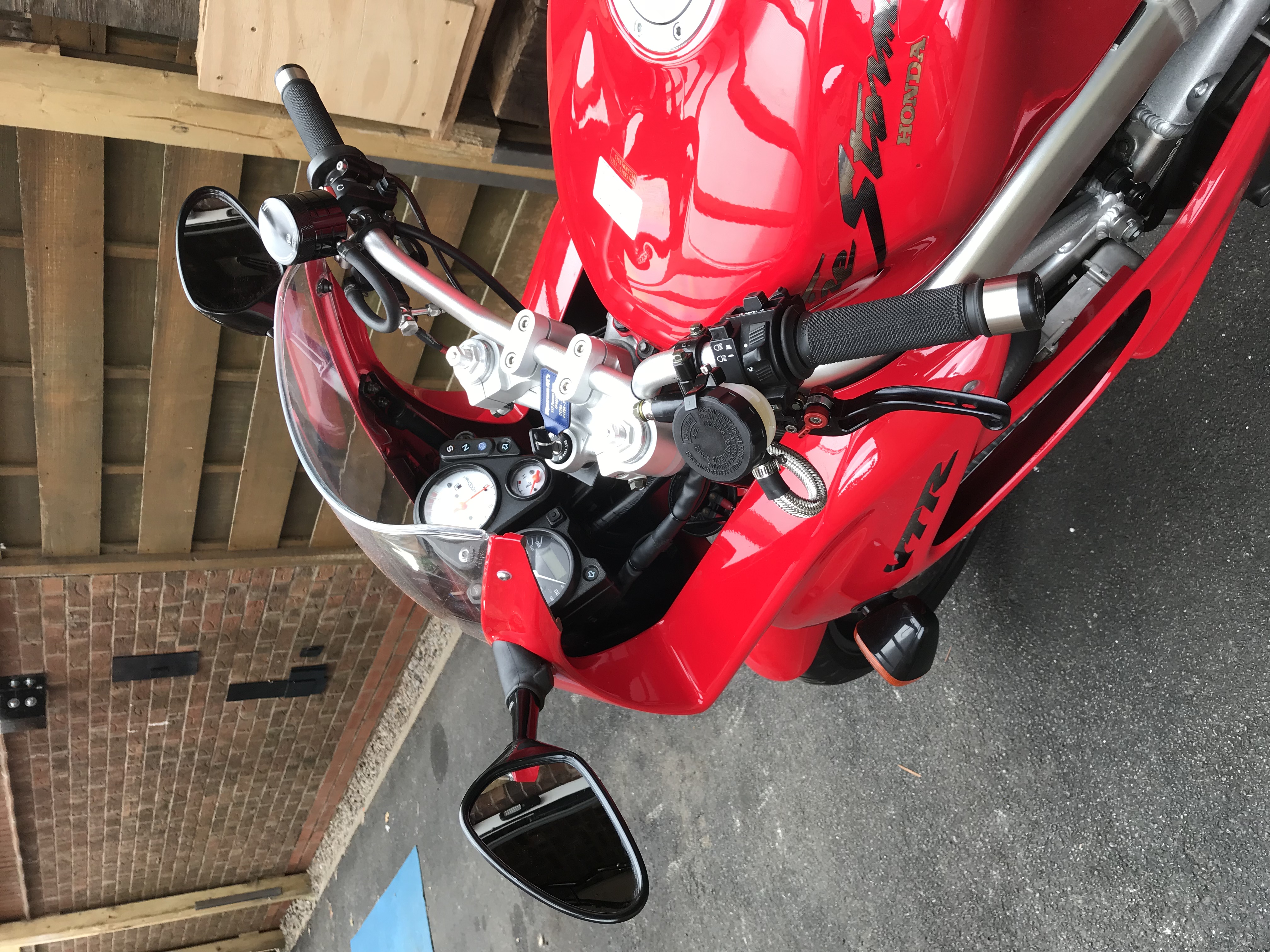

All done, fitted bandit master cylinder instead of fixed Storm item.
Posts: 16557
Re: Renthal Flat bar handlebar conversion.
good work ..... but now you need to sort the mirrors, as I bet you can only see your arms now
Posts: 21744
Chrisd wrote: Wed Jun 20, 2018 9:31 pm All done, fitted bandit master cylinder instead of fixed Storm item.BD4A878B-7B6A-4296-8172-DBC102580A82.jpeg
Nice work, well done :thumbup:
Do you mean you fitted Suzuki Bandit master cylinders (if so which Bandit) or is there a company who supply those parts with the name Bandit :?:

Hi, purchased some R6 Mirrors they work fine also the whole levers and master from a Bandit. Any will fit but I don’t think all had a clutch slave so as long as it does.... sorted
Posts: 21744
Chrisd wrote: Thu Jul 12, 2018 5:37 pm Hi, purchased some R6 Mirrors they work fine also the whole levers and master from a Bandit. Any will fit but I don’t think all had a clutch slave so as long as it does.... sorted
Thanks for the info on the levers and master cylinders, I've found them on Ebay now :thumbup:
Good to hear the R6 mirrors suit you,

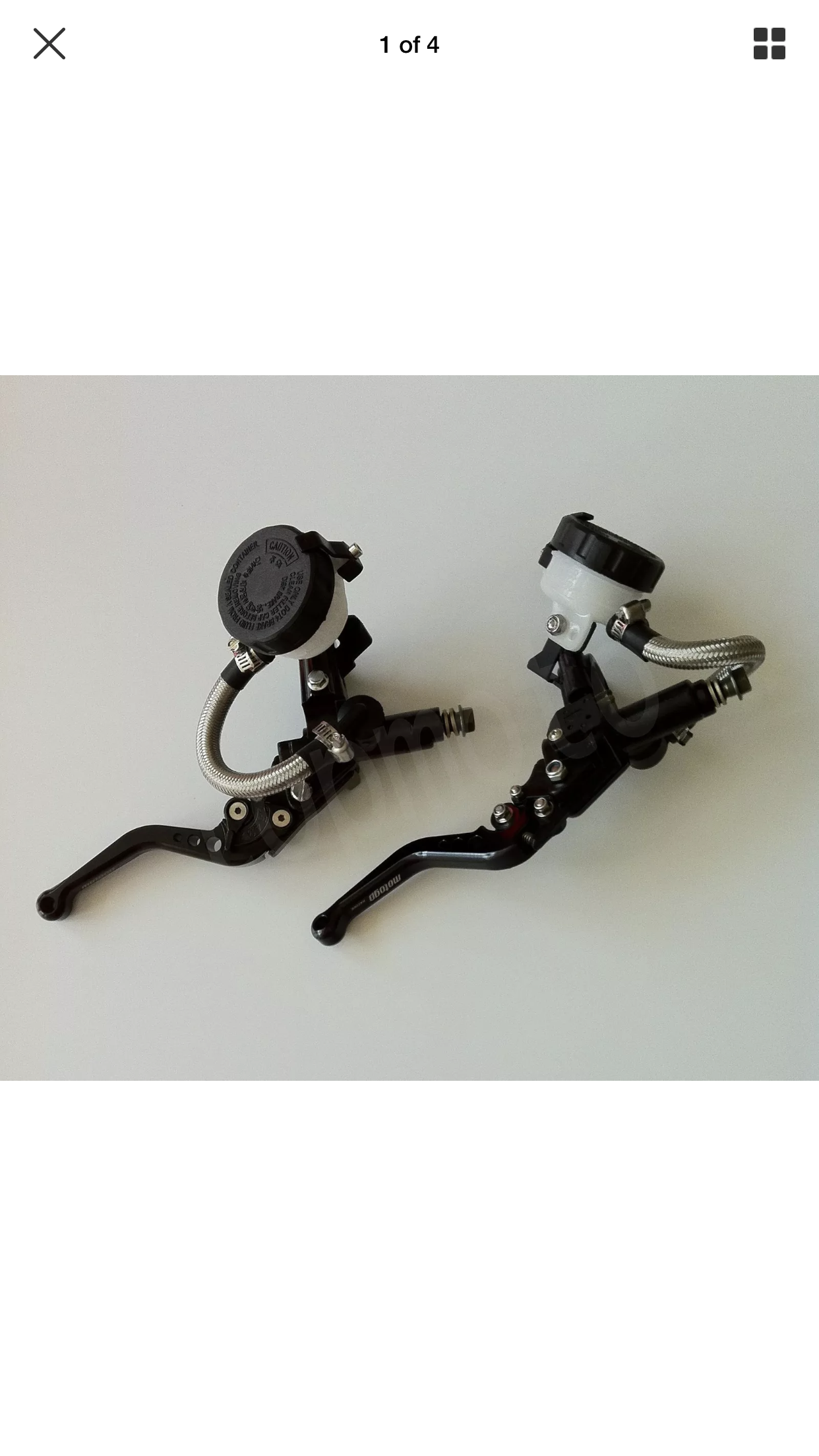

Thinking I might take the plunge and buy one of these
https://www.ebay.co.uk/itm/Abm-Superbik ... 4137862114
Anything I need to watch out for? Can get spacers from work to bring the steering stoppers in, but I'm still unsure about location of the clutch and brake reservoirs.
Is it possible to get remote ones? Or extend them inwards somewhat?
