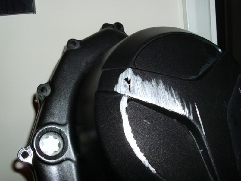

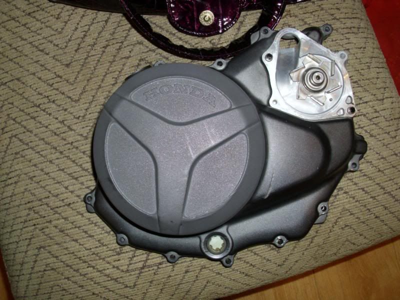

so its stripped down and I have this:
Luckily found all the other bits inside , so whats the best way to fix it? thinking chemical metal of some sort
or found a used one for£75.00 + vat
What should I do?????
Qualified Hetas engineer pm for information...
bluesman
Posts: 526
Joined: Sun Jul 25, 2004 3:53 pm
Re: Roads still not at their best , trust me!
Post by bluesman »
this is one of very few parts on Storm that are cast magnesium alloy.
You can plug it with various substances but it won't be perfect.
You can weld it but you need guy who knows that he is doing VERY well.
Buy one off eBay and stick carbon cover on it. This is route I am taking.

Bike is now up and running chemical metal worked a treat,

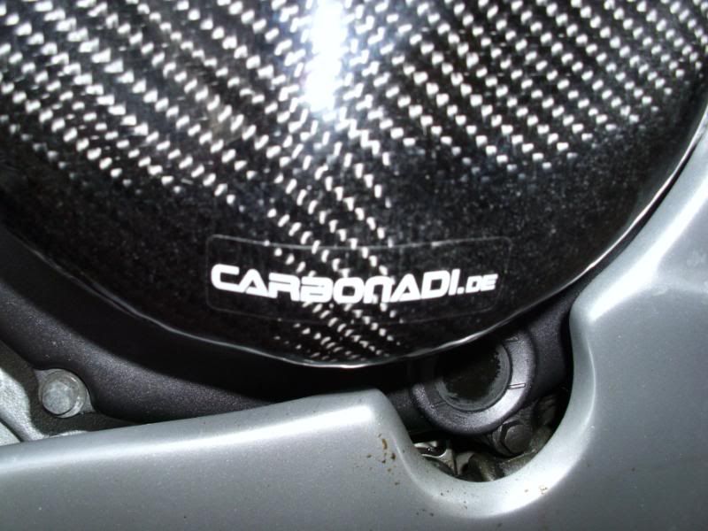

Carbonadi cover is on its way from ebay, will post up some pics once finished.

So out came the chemical metal , a metal file and some paint and was left with this:
Took it out for a few hours and the repair held out, then this arrived, £37.00 inc postage from ebay!
So bike is fixed!! just need to get the spare fairing painted then its back to its best again!

nice repair job.
thing is it's cheaper to get a new casing than the carbon protector lol :biggrin

benny hedges wrote:nice repair job.
Really? the cheapest I found was £75.00 second hand!
