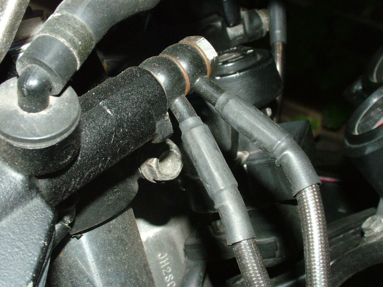

ok, fitted new braided lines to me bike.
the calipers have new seals, all new copper washers, new master cylinder, bleedable banjo bolt and still the lever pulls right back to the grip.
I have a two line system fitted. I have tried doing each one separately and they are rock hard but together not any good. there is no air coming out of the calipers or master cylinder. PLEEEEEEEASE HELP :roll:

How are you doing each one separate. Wouldn't you not need to disconnect one calliper at the master cylinder which would require a single banjo bolt the bleeding. Test one and then the other.
Have you put a copper washer either side of each banjo at the master cylinder. That's 3 in total.... washer, banjo,washer,banjo, washer. Bolt goes through the lot.

thats exactly what I did. fitted one line at a time and tested the caliper and they were great. Yes I have all the copper washers in place. I have a banjo bolt that I can bleed too. Would a 3 line system be better than a 2 line system?

The only thing I can think off, it's the bleeding with two lines connected that is the issue. As you have no issues with the single banjo bolt and single line then the only other thing is the double banjo bleeder bolt. Which one did you fit? I recently fitted a Venhill double banjo bleeder bolt with no problems. It's possibly either the bolt or you still have trapped air in the lines.

yeah it's a venhill one :D
