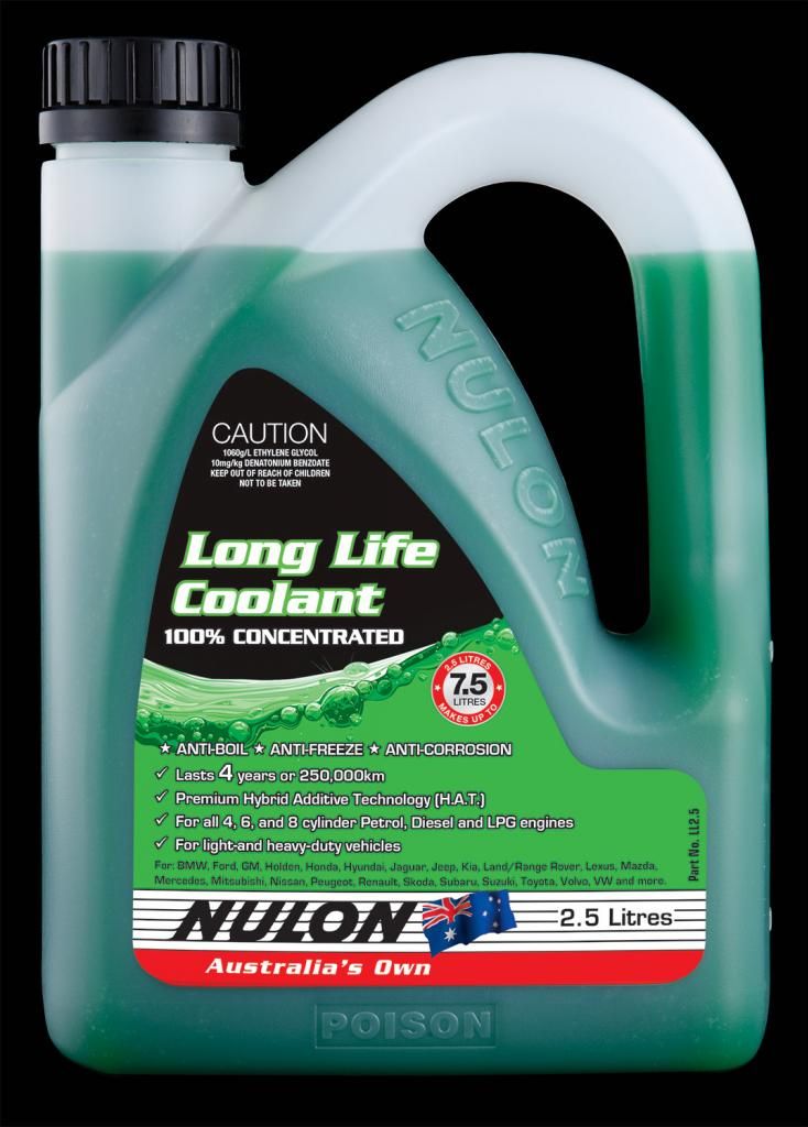

This is the coolant I ended up choosing which is an OAT type A as listed here in Australia. I know it's no good to you guys as it is an Australian product. It does say on the front it is ok for ALL vehicles and on the reverse side it says it is GOOD for motorcycles.
Thanks for all help offered.

Re: Which Coolant Should I use?
Hybrid Additive Technology (HAT) whatever that means. Ethylene glycol mixed with Denatonium Benzoate :roll: , jeez no wonder things get confusing. It sounds like were putting our motors on drugs. That's it I'm off to the Auto dealers now.......

cybercarl wrote:Hybrid Additive Technology (HAT) whatever that means. Ethylene glycol mixed with Denatonium Benzoate :roll: , jeez no wonder things get confusing. It sounds like were putting our motors on drugs. That's it I'm off to the Auto dealers now.......

Another interesting issue is the instructions on the reverse side of the Nulon container which tells you not to premix the solution with water, but to pour the appropriate amount of Nulon into the radiator and then add the water to the radiator separately. THOUGHTS!!

it is all getting pretty confusing, more so now that some of the manufacturers are going back to green eg the pic above and also the stuff I took out of mine was like a luminous green so as it was put in by the Honda main dealer I’m assuming Honda coolant is green to, a few years ago it was quite simple green/blue was the traditional/conventional stuff and the red/orange was the new gear now it seems you can’t even rely on the colour to help you avoid making a potentially damaging mistake.
