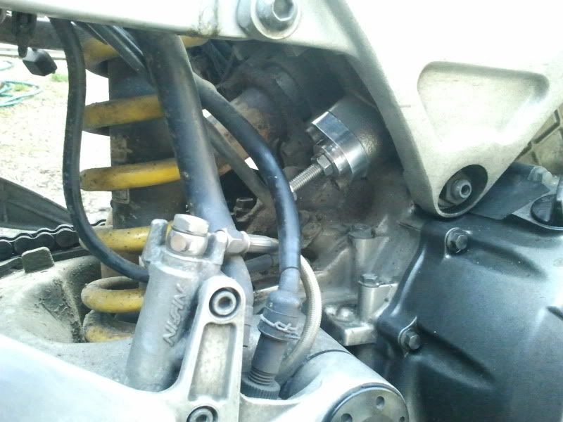

All done! :D
Bit scary on the first push of the starter but all good! No death rattles any more! :)

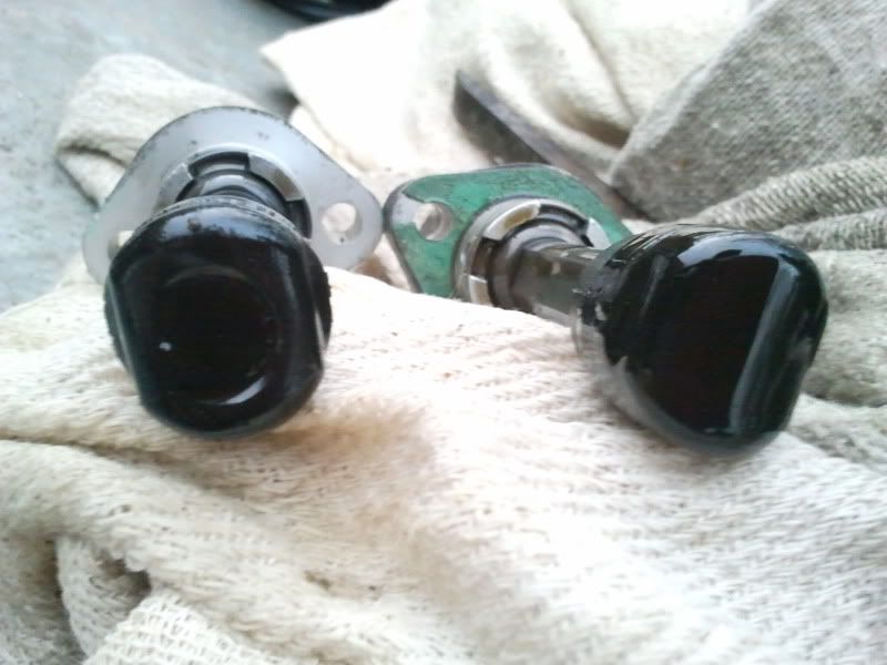

The old nasty ones!! Anyone want them before they are consigned to the Great Dodgy Honda Bits part of Hell? :lol:
There was no metal cap on the front one (Left in the pic)! I presume this is NOT normal? You can see the wear on the rubber bit.

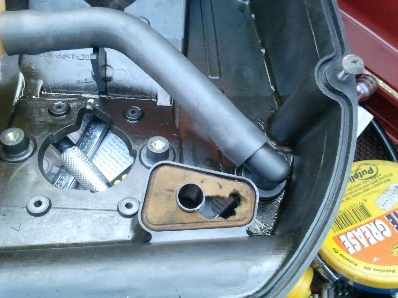

Also, I spotted this when I took off the airbox cover...
Can I buy this anywhere or do I just chop up an old kitchen sponge?

playerone
Posts: 1177
Re: Big scary day tomorrow (Sat 14/1)
Post by playerone »
I'm sure bazza will take them off ur hands as he converts them :thumbup:
Posts: 16290
It's not uncommon to see the end cap missing.
People replace them but don't know that you have to swap the end cap over to the new one.
It's a dead giveaway when you see on e with a circular mark on the end.

i've got a couple of spare sponges for the airbox mate, if you can wait a couple of weeks for me to get back to england, i'll post them to you.
