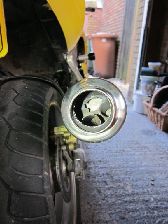

Hi 'y'all. Ive had a partial bafflectomy on my standard cans for a while now. I decided that this is the time to go full!!
No I bought a 57mm round saw which is perfect for getting inside the main exhaust opening, and it did the job in about 10 secs. Then (as expected) the baffle, although detached from the plate that I had just drilled, it was still pretty solid, so, as I had read on here, I took a hammer to it and hit the inner pipe (end of baffle) and this has now come loose, allowing me to spin baffle around in place.
Only problem now is that the baffle won't come out - it will go backward and forward about 4-6cm and spin around but not out. Ive tried pulling it with pliers, monkey wrench and I'm now fresh out of ideas??? HELP!!

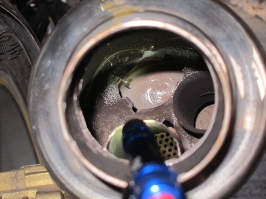

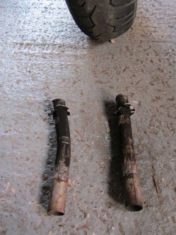

These are the baffles post surgery!! The problem I had was the weld join (1/3 the way up, from dirty to clean in pic) preventing baffles coming out after I had hammered them in to brake weld!!
Here you can see the welded plate that I had to chip away at to allow baffle to come forward - I used a long normal screwdriver and a hammer!! Just chipped away and made hole bigger - oh and a torch came in handy!!

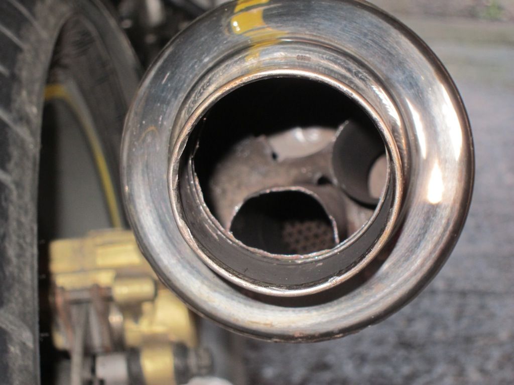

Another pic of the weld join inside

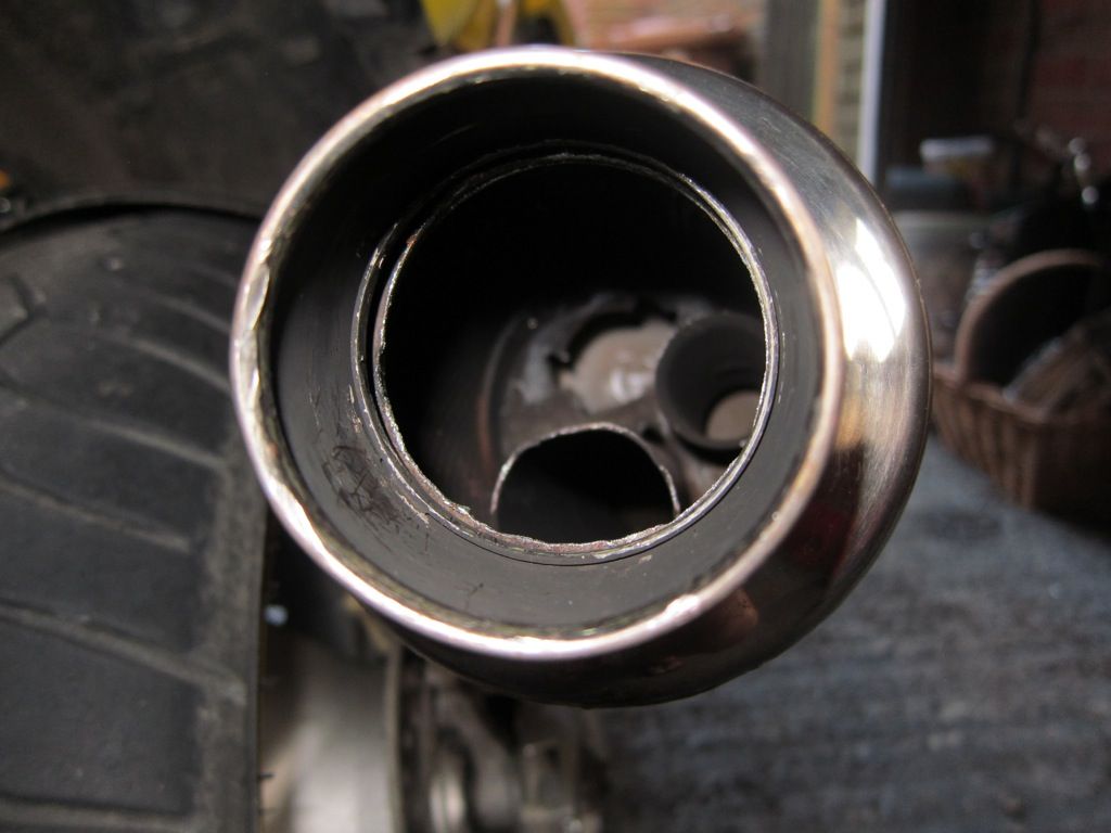

More pics
More
Last one!!
All done now. Shame but because its after "children to bed time" I'm not allowed to listen to the results of my labours!!! Tomorrow will be a nice day!!
