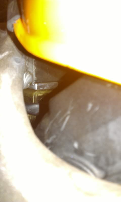

Can just see the see the nice square one here
