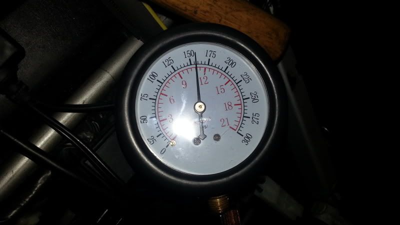

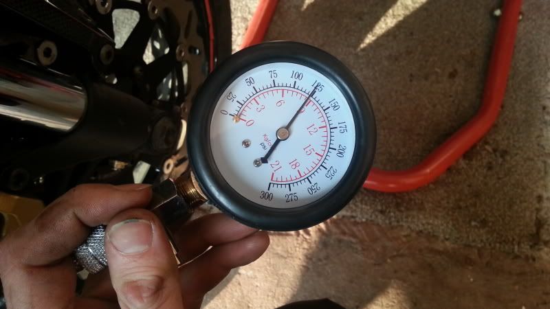

Tested today after cleaning it ready to tackle what i hoped was the stem seals... looks to be rings
TEST Engine not up to running temp but not cold either
Rear
Front

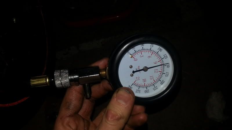

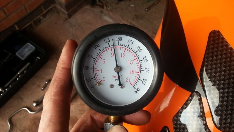

I then later did the engine oil down the head method, i used a tablespoon not a tea spoon as i miss read type :problem:
engine was cold for this one so would be a higher reading if warm, popkat suggested adding 5%
http://www.vtr1000.org/phpBB3/viewtopic ... 34#p248254
Rear
Front
Just trying to find the book value for compression now and see how bad this reading is....

1 had 150 back and front on a cold engine. i think the book is 164 psi hot

AMCQ46 wrote:1 had 150 back and front on a cold engine. i think the book is 164 psi hot
are you saying you had that mate?
the 150 readings on mine are with oil run into the heads
to see if the seals or rings was worn
Posts: 16742
Re: Tested Compression
Yes, 150psi, no oil and cold engine... It was my 30,000 mile replacement

how much power would you expect to loose using my engine?
lets say 130 psi front if hot
and 140 psi rear
book value says 164
how much life would you expect the engine to have left in it? its on 42k now
Posts: 16276
You won't lose much on outright top end horsepower, because ring/bore wear has less effect at higher revs.
If you consider that there's only a fraction of a second for compressed and burning gas to leak down past three ring sets, (all with end gaps 120 degrees apart if it's been built right) you're not going to lose much compression at all.
But at lower revs you lose proportionally more.
I actually manage to start and ride home (5 miles or so) a Honda single that had a 5mm hole in the piston crown, which admittedly wouldn't run at less than 6,000 but ran, nonetheless.
Now that WAS a bit down on power.....
Point is, the engine will still develop most of its power, you'll notice torque dropping off, but incrementally and gradually, so it's not really noticeable as a day-to-day change.
It's only when you put in a rebuilt or nearly new engine that you can feel the difference- it's certainly noticeable then.
Lastly, it's rare that you actually use full power on the road, maybe 1% of the time? So if it's only noticeable at full revs, and it's rarely used at those revs, most of the time it's fine.
I think on balance if it's not using too much oil I'd put up with it, and refurb another engine ready to go in as time and funds allow. As ever, the cost of refurbishing an engine is out of proportion to the value of the bike, so you might be better off financially picking up another bike, swapping your good bits over, and either selling the clunker on to Marty as yet another for his collection or breaking it.
