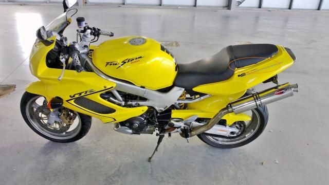

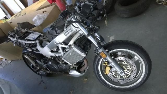

OK, so there's an unsightly gap between my seat cushion and the fairing, it seems to have gotten more pronounced as time has moved on. With the addition of a seat hump it just looks silly and people stop,point and laugh, that could just be at me too I suppose. Nothing obvious is wrong, but now as the bike is partially stripped it would be a great time to rectify this....any ideas?

Ok, now to find a pre-stripped pic (of the bike ha ha)

Re: Seat gap...if you know what I mean
Fit a rear seat hump
Without hump
You could try putting some spacers under the the rear of the tail fairing where the two mounting screws are. I think it would be simpler to adjust the fairing rather than the seat.

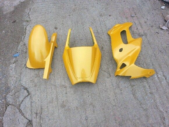

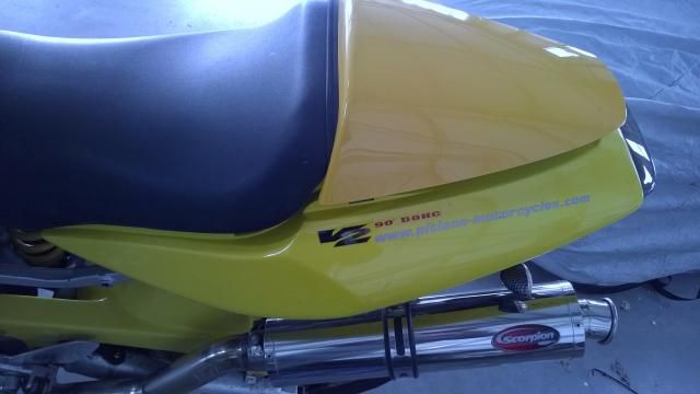

Have a seat hump ! OK so I think the seat was popped in this one (and yes its a different colour)
Panels re-sprayed in yummy liquid yellow metallic

I had this problem. I found that the rear fairing was sitting too low. The black plastic undertray flange sits under the fairing plastics. Then the fairing is then raised enough to meet the seat properly.
Posts: 16733
Like Carl said, you can put some plastic spacers between the fairing and the subframe under the 2 screws that are right at the back under the seat
