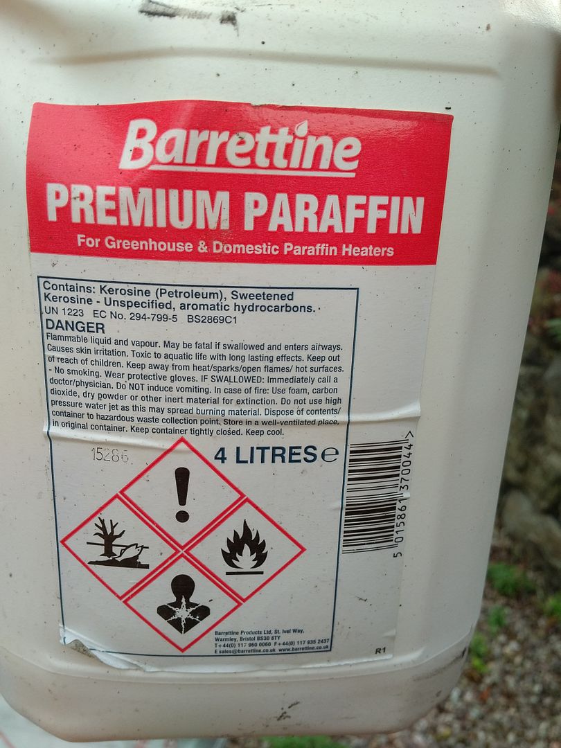

The only other explanation I can think of is that the kerosene came from a kind of bargain store and does list '5% unspecified aromatic hydrocarbons' amongst the ingredients. As I say I've used the stuff on previous chains with no problem but haven't cleaned it nearly as frequently as gear oil sort of does this for you most of the time.

Here's a picture of the label of the stuff I was using

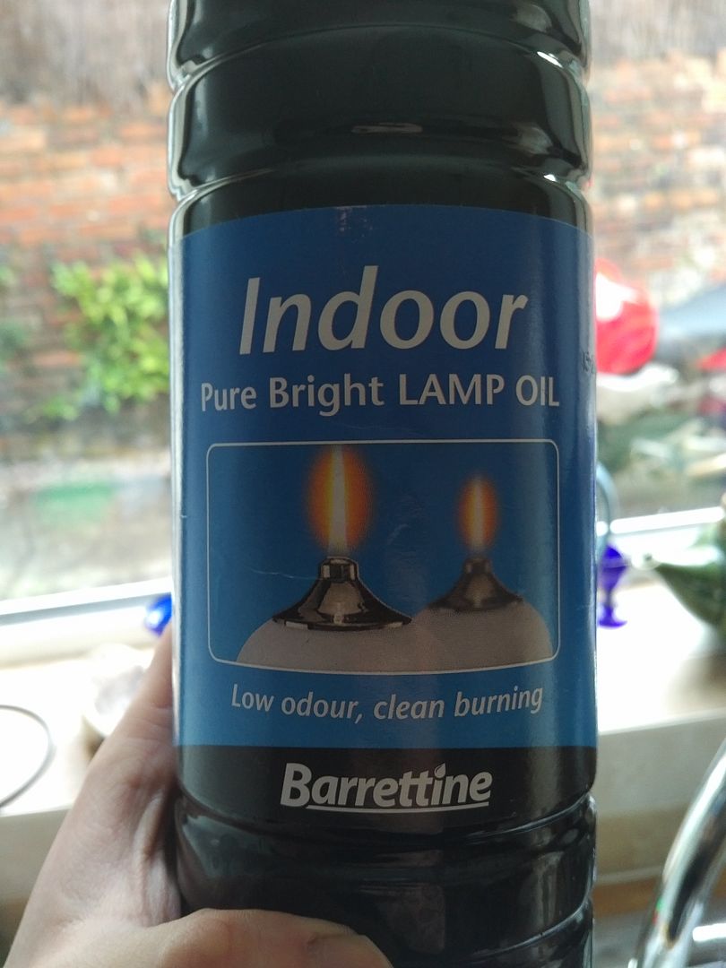

Whereas I think possibly what Haynes mean is something along the lines of this
The former reeks of, well, oil refineries, the latter is odourless. Don't know if that means anything.
