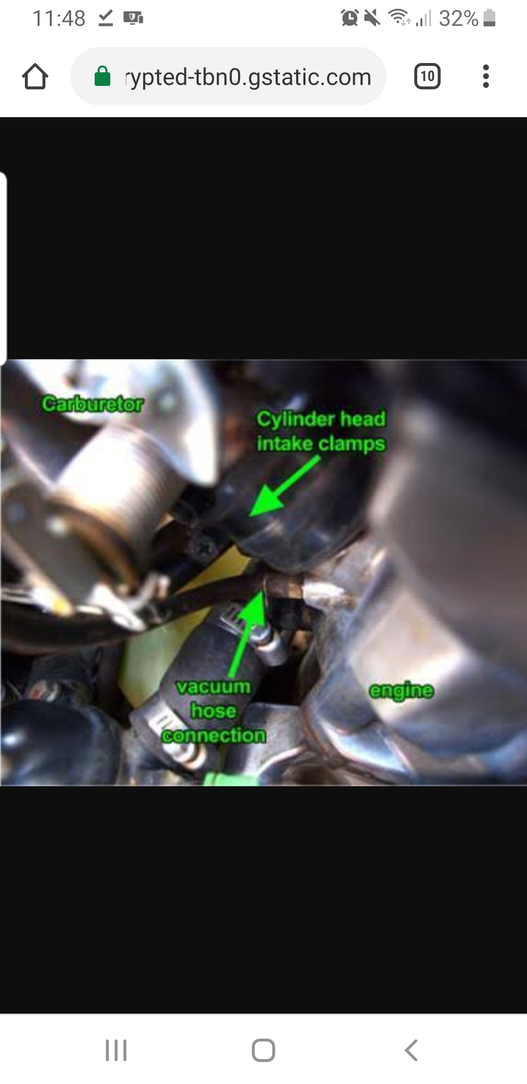

Hi guys, name's Mike, new to the forum. Bought a vtr1000 and been riding it to work, all going great until I find a small puddle of fuel under the bike and it struggled to start, took maybe 6-8 tries. Limped it home and it wanted to stall half the time, had to keep the gas open slightly at red lights to keep it going.
So I lifted up the tank and found fuel coming out of the vacuum hose (see pic, where it says vacuum hose connection) and strangely when I tried to turn the fuel tap to the off position, fuel would leak out of the tap around the edge of where it turns.
Would this be a busted fuel tap leaking fuel into the vacuum hose?
Likely yes, and so the cylinder is getting raw fuel.
With engine off, remove the hoses from the fuel petcock, see if you get fuel dripping to confirm...If so, rebuild the petcock using the OEM part set COVER SET, PETCOCK 16953-ML0-034

Took a hose off and fuel pissed out, even with fuel tap turned to the off position. I can use the all balls repair kit instead of genuine Honda yes?
