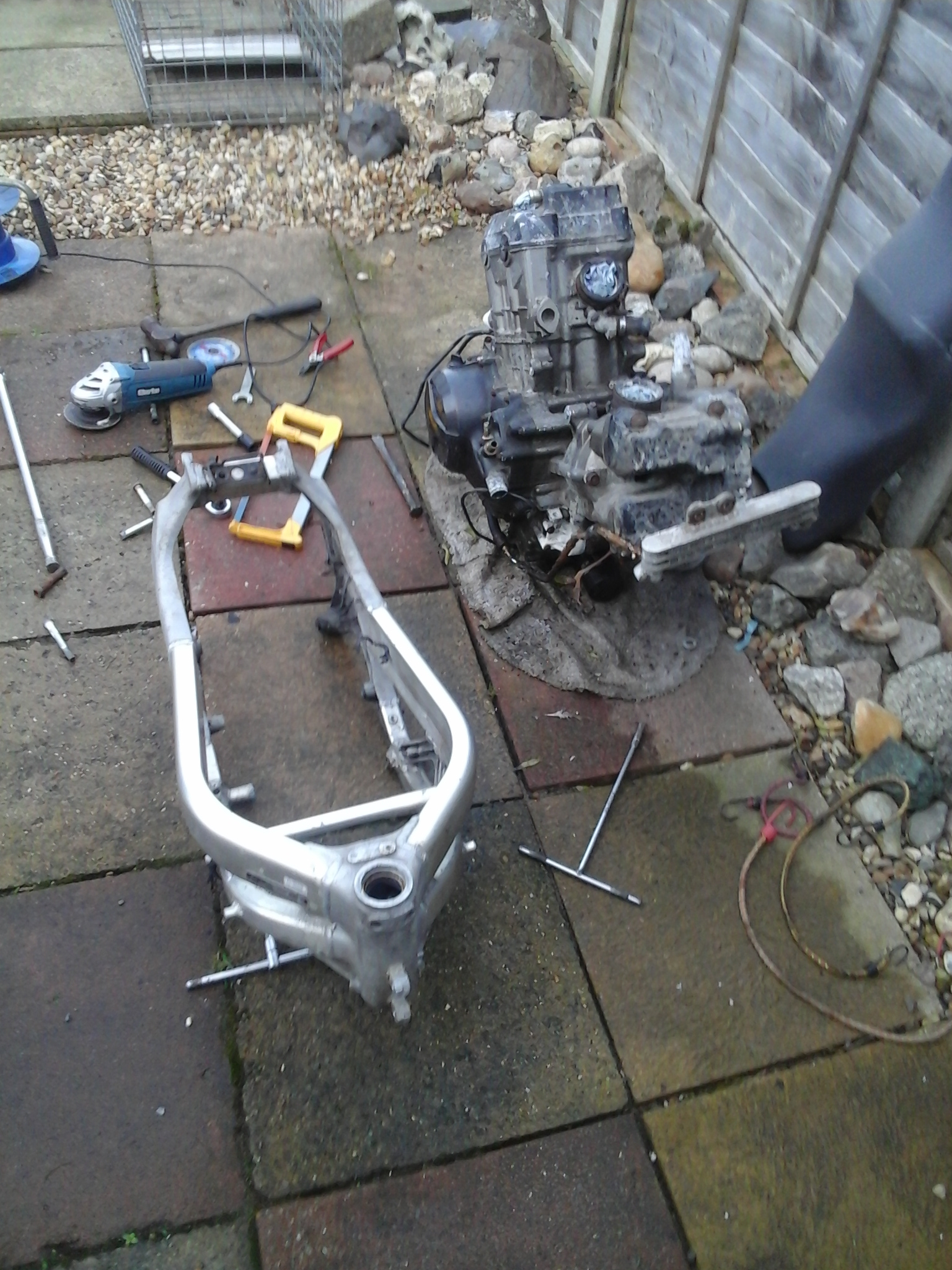

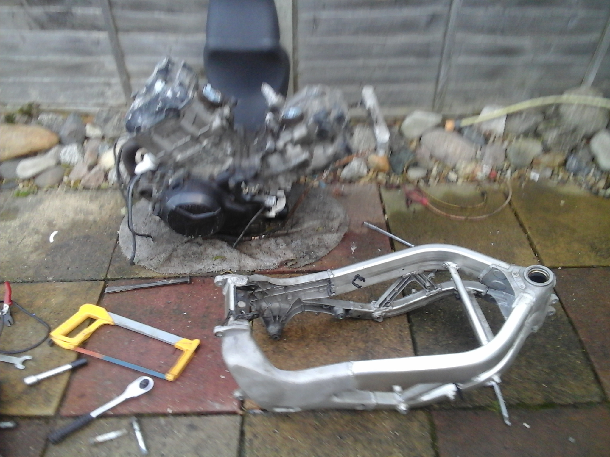

Pulled 3 others out of the MacCave to access tools for...
World War Rusty the Storm. The Battle of the Engine Bolt...
Having previously strategically out manoeuvred the beast with lashings of Plus Gas & successfully removed the castle nuts.
Today saw the deployment of the big guns... well the grinder.
Both mid bolts came out with out a fight.
The rear engine bolt put up a little resistance but surendered to extra leverage & a hammer & punch to get it moving... Slipped it out no problem.
So the top bolt... So I started on the left & used the grinder to cut through the spacer between the frame & motor, once that was through it meant the frame slid sideways giving a gap between the frame & engine mount...Unfortunatly I coudn't use the grinder as the disc was so low I didn't have room to get it in...Brake out the hand saw, found the best blade I had...( Make note I need to shop for some blades & cutting discs...) & cut through in about 10 mins...
Unbolted the oil cooler...
It's over the war is over. Rusty the Storm has unconditionally surrendered to the overwhelming forces at my disposal.
So it's out without any damage to the frame...Shame there are several snapped off bolts tho... :lol: :lol:
So anyone in need of a spare frame or an engine for spares ?

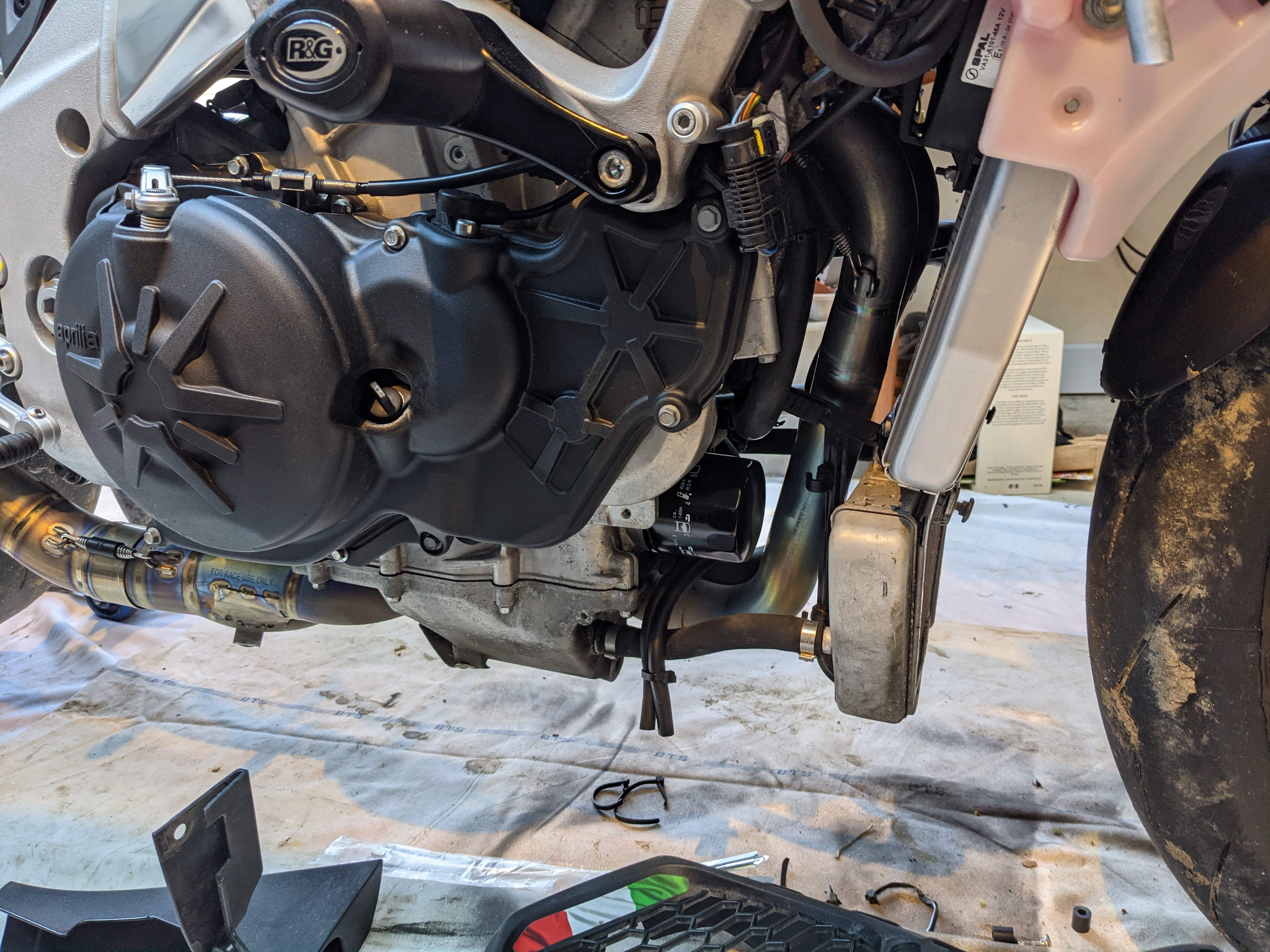

Brought the Tuono indoors, it's too cold to work outdoors.
The plan was to wrap the downpipes.
Access is somewhat limited:
There is very little clearance between the two downpipes, and so I had to give the idea up.

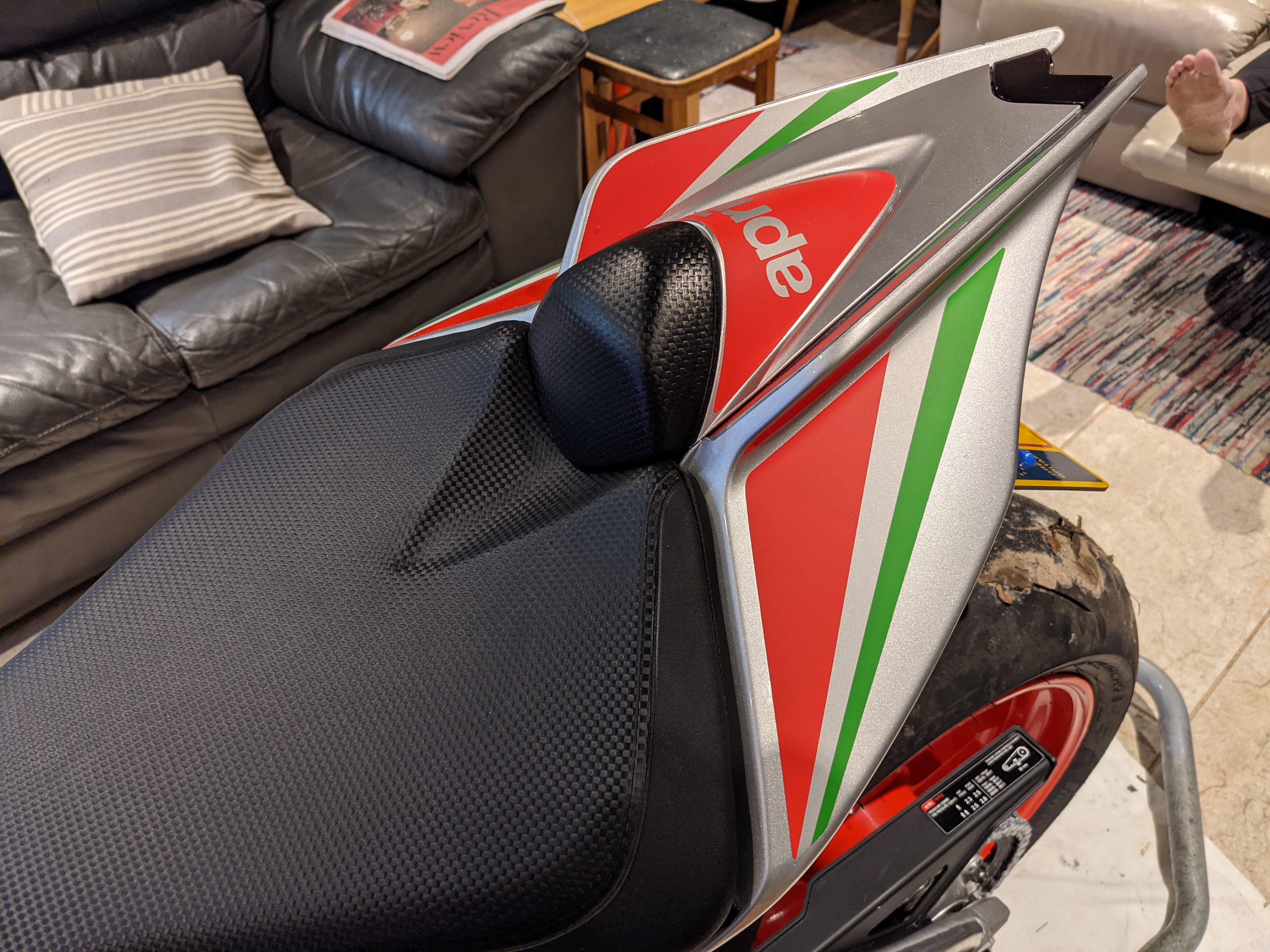

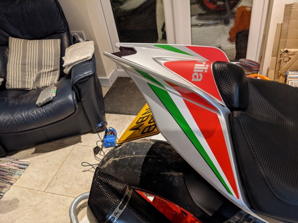

The last job was to add some tail stickers. As standard, my 2019 bike didn't have the full set, and there was a scratch on the tail paint. The 2020 tail design had what I thought were better design stickers, in eluding a bit of green.
So I bought a set and stuck them on; they're mostly straight. The tail cover sticker ended up with a small pinhole; so I'll replace that at some stage, but it'll do for now.
