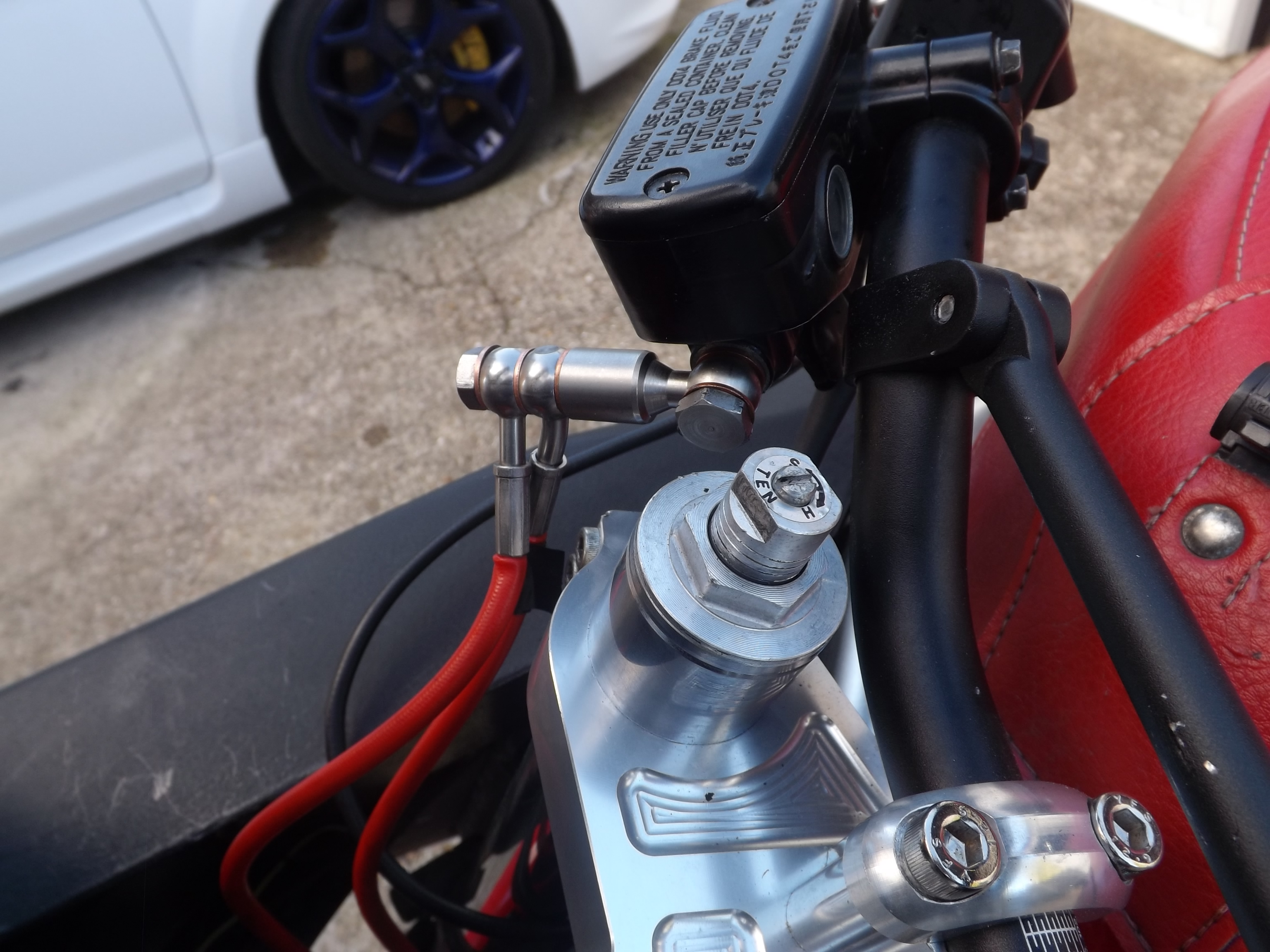

Fitting a F4i master cylinder to The Murvinator... A recent evil bay purchace... :thumbup:
With the double banjo on it was touching the fork top & so limiting the angle of the dangle...
So fitted an adapter & now there is plenty of clearence.

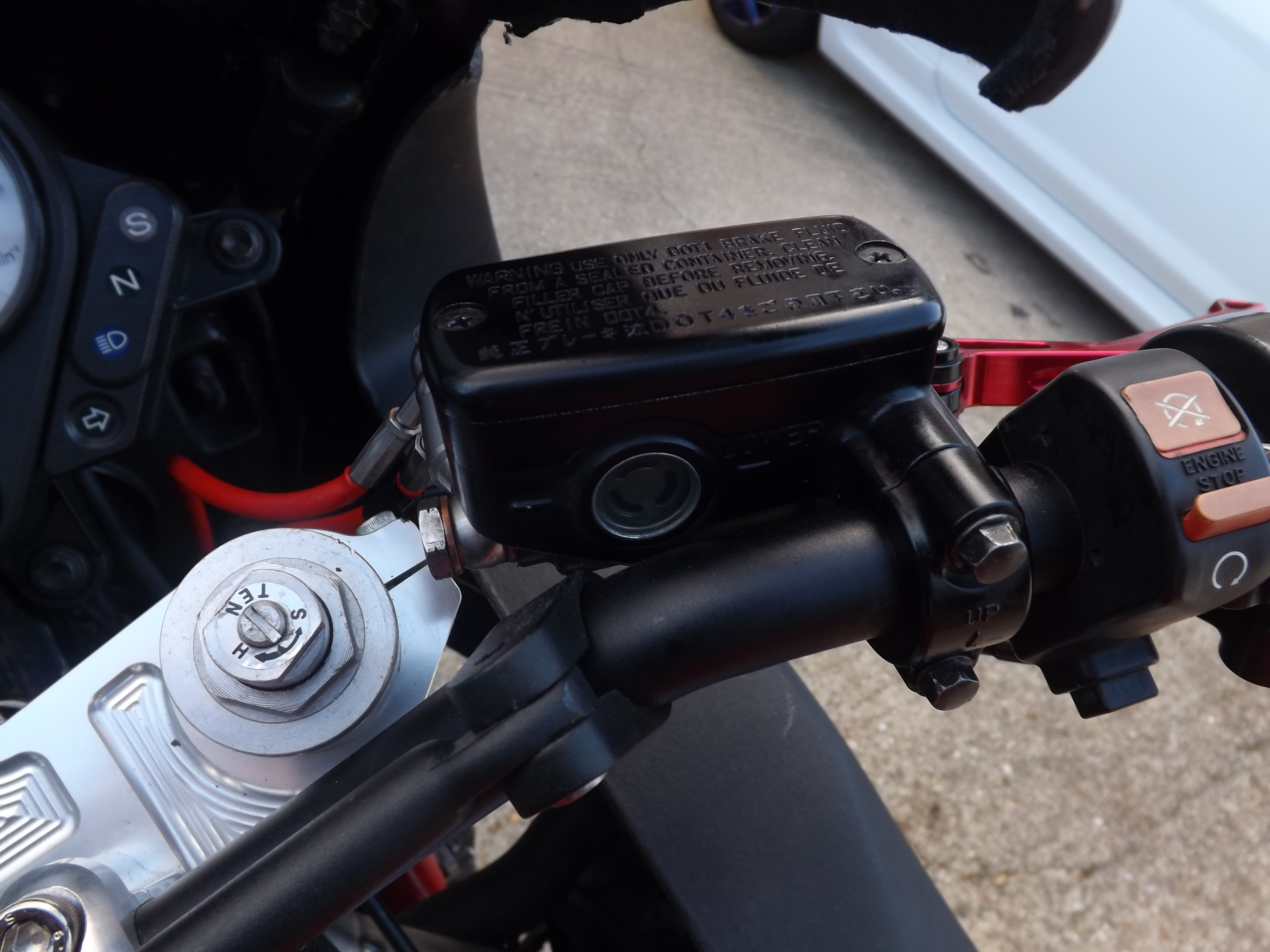

This has now aloud a bit move adjustment to the bars as well so starter button & hooter dont touch the tank on full lock..needs a tad more off the fairing as it is touching the switchgear on the top on full lock... Pass the dremmel... :lol: :lol:

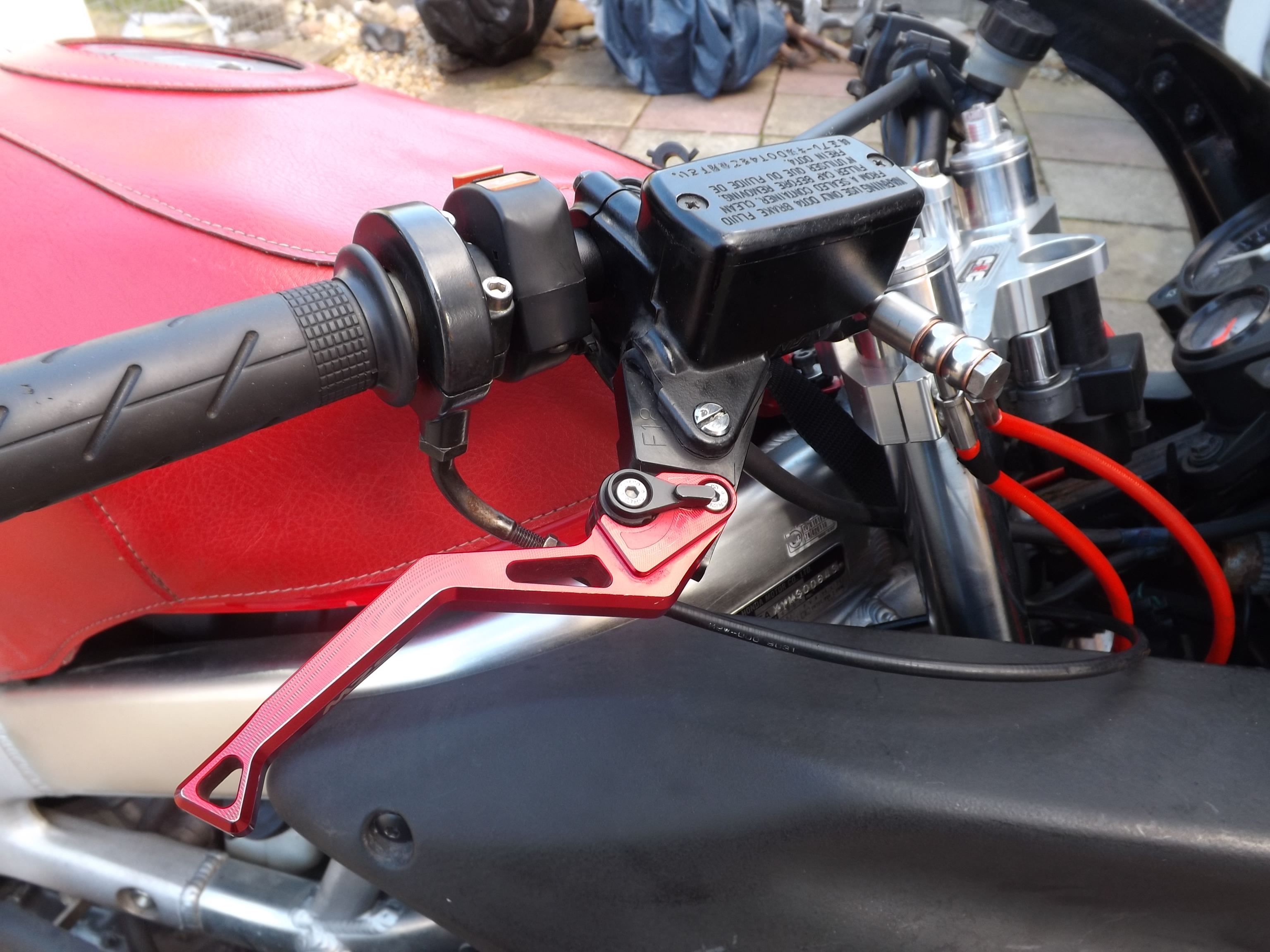

The M/C came with a shorty red lever which is a bit of an eyefull will have to keep me eye out for something else... Yes loads on ebay but the F4i clutch is a cable...So that buggers up buying a pair... :roll:
Nice ehhh ? :lol: :lol: Not...
It'll do for now, currently running a std clutch lever so the deff don't match... Thankfully I don't suffer too badly from OCD... :lol: :lol:

I'm on the lookout for a Blackbird Clutch m/c but need one with a lever. They dont look the same as a Storm one to me...correct me if I'm wrong ...
Blackbird clutch lever is the same part no as the late Storm one...
They are both different to the early Storm part number...
However the VFR800 is the same part number for the clutch M/C...so that gives more options... :thumbup:
