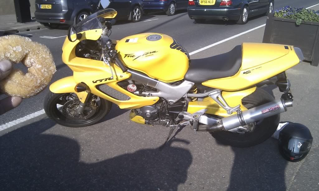

rode to southend for some doughnuts
:Beer Popcorn: :thumbup:
looked at my forks when i got home as she felt odd and there both leaking 0o
was fine earlier
didnt do any mischief

Darknomad wrote:rode to southend for some doughnuts
was fine earlier
didn't your forks get done at the workshop day ?
Darknomad
Posts: 277
Post by Darknomad »
yeah lol
i just ordered a new set of seals oil and dust
i hope to get em sorted before the storm meet
east london/essex [leyton ]
Posts: 16288
They shouldn't be leaking already, they went in without any probs, and weren't damaged when fitted, so don't know why that's occurred.
Let me know when the new seals arrive and we can have a look, unless now you've seen it done you're ok to play by yourself?
