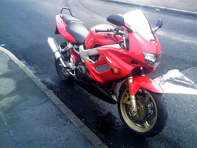

I played with my spare red one at last; it's been sitting on the patio looking at me for a couple of months or so.
The so-called "mechanic" that was meant to be sorting it couldn't find why it wouldn't start, a couple of problems was all it was.....
1- the transfer gear set between the starter motor and the sprag clutch was slipping, it should be locked solid.
Haven't seen that before, but as I had a spare one, and it wasn't the starter motor or the sprag clutch......
2 It's red.
Still, it runs fine now, just a couple of tidying up bits and pieces to go, and an oil change and it'll be up for sale.
Tidy, and although it's an import, one owner, tidy plastics, unmolested and fitted, as you would expect, with manual CCT's!
Oh, and good rubber, Diablos with very little wear.
On an S plate, so early-ish.
I'll be looking for £1500, given the prices they're fetching just now, should be ready in a week.
And it'll have a lovely set of cans on......
