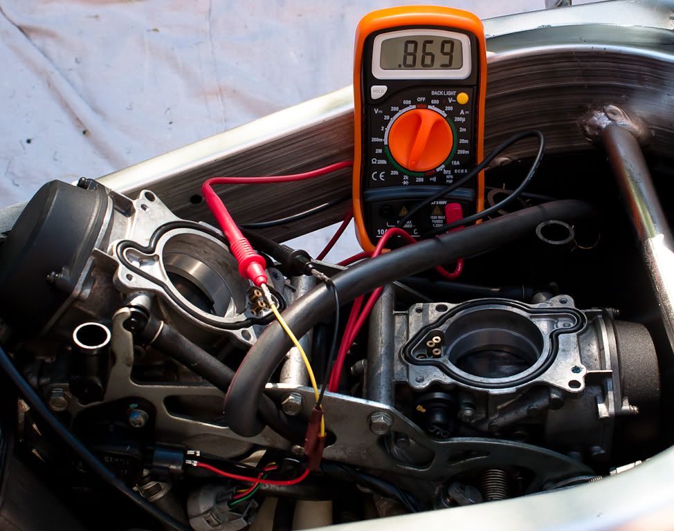

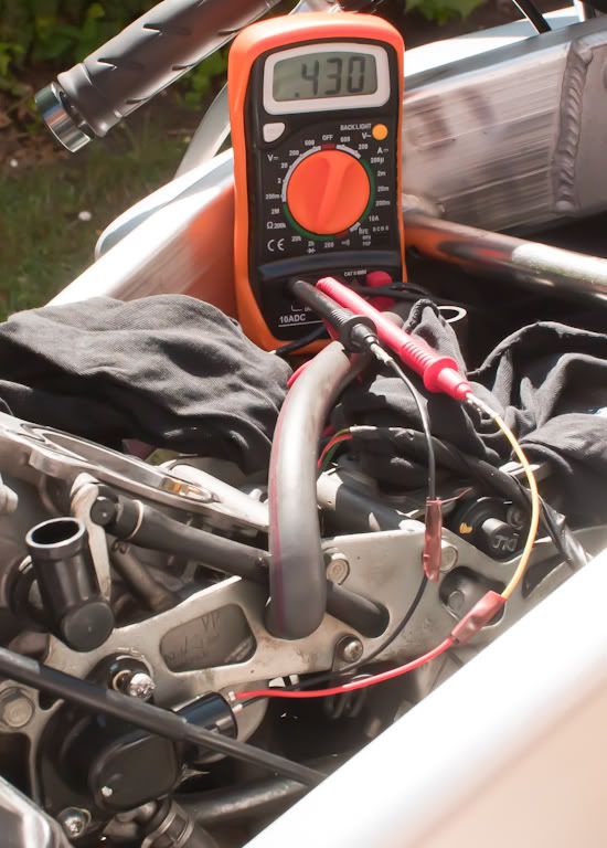

Anyways, got the TPS done! Cheers for the pep talk Benny "man up, ya poof" :clap:
Before:
After:
Took ALOT to get it to 430, so we'll see if Ive fooked it later :D
Before:
After:
Took ALOT to get it to 430, so we'll see if Ive fooked it later :D[/quote]
How did you get it down to 430 mate, i couldn't get mine below 450. :?:

Post by Eclectic »
Benny suggested in another thread to use a Dremel to wind out the holes so you can get a bit of extra twist on the body of the TPS. Well, I didnt have a bit in my Dremel box small enough to get in the hole, so I used an SS drill bit in my battery drill and slowly wound the holes out, a little a a time and rechecking the value till I got it to 430.
I can definetly say throttle response seems much-o improved, only had time for a little run before the good lady left for work, but pulled the biggest wheelie Ive done yet! In the panic of having the wheel so high I dropped the throttle, and as I was waering jeans I crushed more than just the head bearings :Ball Kick:
EDIT, infact, if you look at the before pic and the blue marks, then the after pic, youll see just how far I had to move it!! 8O

i see it now mate, i'll have to ask benny if there's much difference between 450 and 430 apart from the obvious 20ohms lol.

regarding the tps resistance.... i just went along with mik.str's setting as he's had good results with it as have lads over on superchicken.com
if you test the resistance with the sensor detatched from the carbs, it's starting point is 430 ohms, so it makes sense to fit it at it's lowest resistance.
the icm calculates ignition advance from this setting (and temp & rpm)
