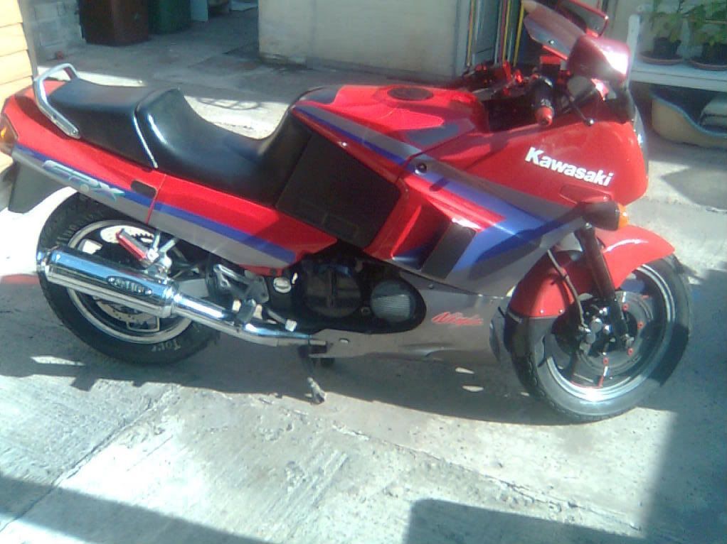

it's been a good reliable winter bike and dispite being covered in road salt for the last 3 winters it's in really good nick...not too expensive if i binned it either
Posts: 16291
tattoo wrote:moved everything about and dug the winter bike out
i've never had to put a spanner on her except for servicing....not bad for a 93/K reg...17000 miles and only £300 3yrs ago :thumbup:
Won't go far without the chain on!

so thats why it wouldn't move then :lol: ....it's stood 6months so took the chain off to soak in hot oil..
