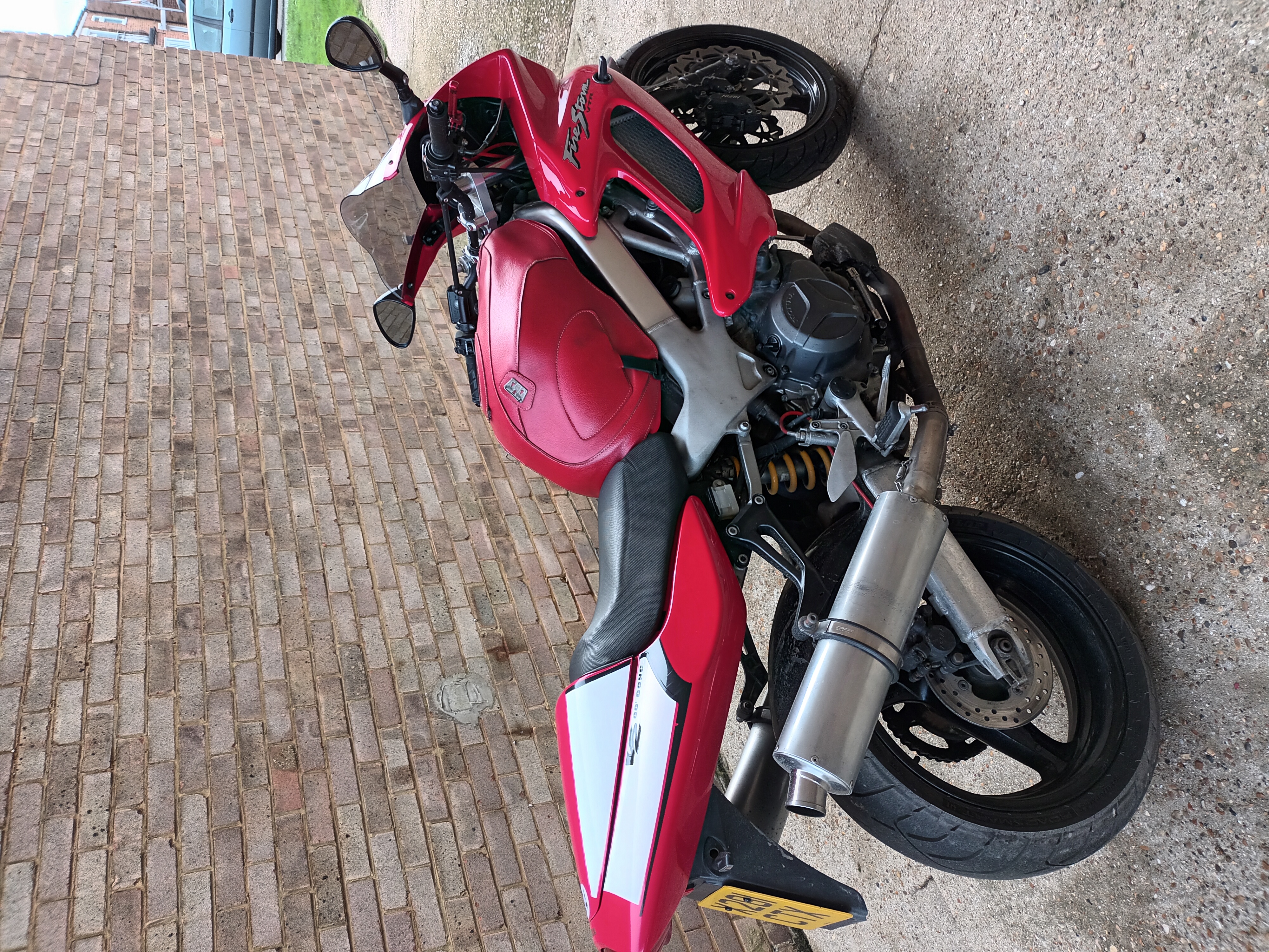

Posts: 18036
Well yesterday...
Took The Murvinator out for a spin...Dryish roads stretched it's legs & mine 60 ish miles.
We may have broken some speed limits along the way... :wink:
