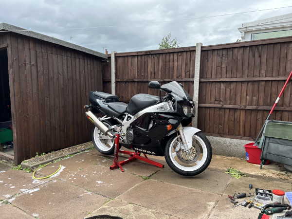

Hope you get to the bottom of it mate. ImageImage
Washed the colour off it !!
Now it’s even faster
Posts: 22397
lloydie wrote: Sun Jul 28, 2024 2:56 pm Washed the colour off it !!
That's what you get for using the pressure washer on full power :lol: :lol:
Good to hear from you Lloydie :thumbup: :thumbup:
I can't believe how much different your blade looks in stealth black :eh:
