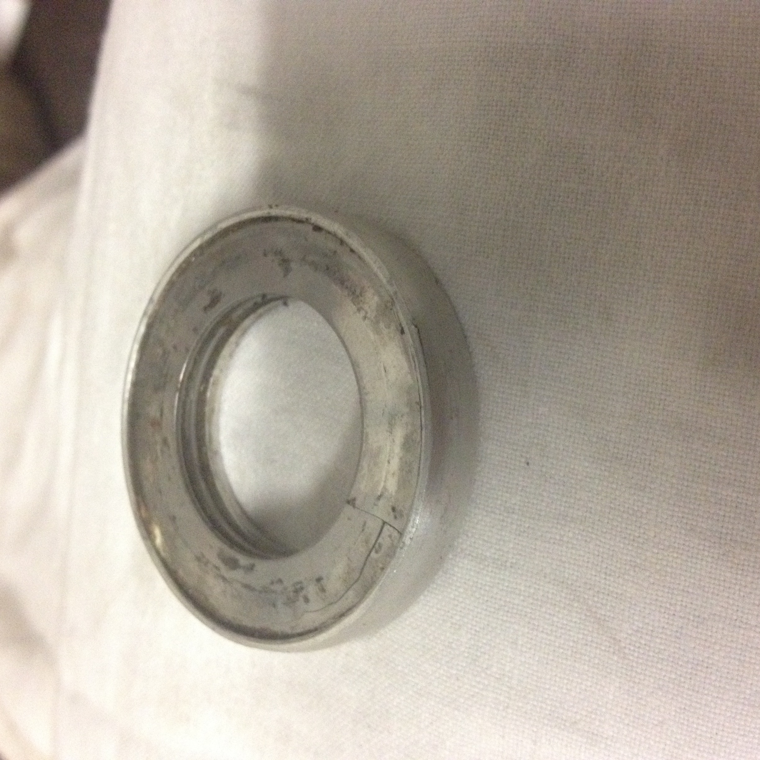

oh dear lord the thought of a spin round donny :clap: :clap: :clap: .. i do want to get the spondon arm back in but iv a bit of work to get that back in like the strange bearings that fit between the swinger and the ears and the question of do i trust that dam rear dymag ever again or rather the carrier??
what do the bearings look like i had some made up for a spondon swinging arm 2 years ago
If it's like my Spondon arm they are a flat needle type bearing and sit in a shallow cap.
Rob you can get new Dymags, a little expensive though. Maybe you could send your wheel off to Dymag for them to check and sort the carrier ?

as for the bearings. i havnt got the old ones as they were seized on the sleeve that runs from the ears into the swingarm :confused ..they had to be cut out.

The Bearings you need wear made by Spondon in house
As long a you know the size of the gap needing filled you can get the flat roller type and spacers for the bearing to run
The spacers can be different sizes
Which leaves you making up two cups for these to sit in
All you need is a fairy with a lathe to do this bit

Spondon swinging arm bearing
Posts: 7834
Re: a bit of spondoness.
that looks just like the boys i need :D
