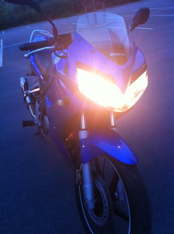

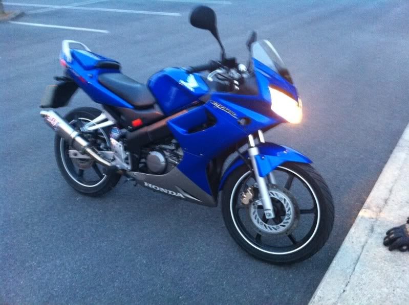

So I took tony's advice and bought the bike I had seen on ebay, in the hope that at worst, I could strip the 180 kit, fit the original 125 cylinder (came with it) and get a bit of money back...the bike also came fitted with a full Yoshimura stainless exhaust and the standard one too, with a viper end can. At worst, that stainless system will sell for a couple hundred, so not done bad I think. With it on, the bike actually sounds quite nice on tick over.
I have just ridden it all the way home from near Whitby to Huddersfield, about 100 miles. To be perfectly honest, it was actually quite fun. It is so unbelievably light compared to the VTR, I almost came off it at the first corner as I threw it into the corner and it turned much quicker and much sharper than I expected. The brakes are really good on it, the back brake is actually much more powerful than the back brake on my VTR. The tyres are really good too, they get so hot and sticky. Much more so than mine :evil:
The guy who we bought it from was sound enough and was honest with us when he said the 180 kit he fitted made bugger all difference to the power...now im guessing that with a standard carb, it wont be getting enough fuel to make a difference? Can anyone confirm?
If that is the case, and bearing in mind all I know about a carb is literally that it mixes air and fuel (never even seen inside one I dont think), would replacing it add more power, or can I modify the existing one? And is it something anyone can do or am I best taking it to a shop?
Well here it is:

looks clean. love the blue.
To adjust air fuel ratio, you will need to change the jets in the carb. You do not need a new carb to change the amount of fuel mixed with the air. engines are jetted differently depending on what air filter and what exhaust system it has on it. It is something you could do yourself as you can buy different sized jets online quite easily. although picking the right one might be difficult. they do sell jet kits so you can try out different sizes but, it is a pain in the ass to change them, you have to take the carb apart to do so. there are people online you may be able to find that have jetted a similar setup would be your best bet, but if you got the money and you want it done right, take it to shop that is skilled in jetting carbs, when a bike is jetted correctly it makes all the difference. so many people fool with the jets and throw everything way off dont know what they are doing. its all science really.

looks great, and she looks quite confident in the car park .

Looking very nice, jealous, though, as I'm looking for something similar for my daughter in August, once she's 17.
Just because it's a 125 doesn't mean it can't go on a dyno, and the carb can be set up properly.
I don't quite agree that it's just jet changes; it might be necessary to gain the maximum power increase to go up 2mm on throat size.
Haynes will tell you the standard size, and then have a dig round a big breaker to find something of the correct throat size that could be persuaded to fit.
The jets on a 2mm diameter bigger carb should be closer to the sizes needed, but will still need setting up.
But you might find it won't tick over smoothly, or rev out properly until it's been set up on a dyno, though.
Lastly it'll need a less restrictive end can to utilise the extra airflow from the big bore and the K+N.
