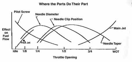

carbs and how they do it

cool.

That's a good diagram
Don't know if it is the same on the Honda CV flatslides, but on my dirtbikes you also have an effect of the slide cutaway at 1/8 to 1/4 throttle

Slide cutaway makes a big difference, especially with 2 strokes on round slide carbs.... Ive had good results from altering the angle...
On the cv,s youve also got air bleed and several types have accelerator pumps which basically fire a squirt of juice into the venturi to eliminate weak mix when you snap the throttle open.
Getting it right is very much a black art!
