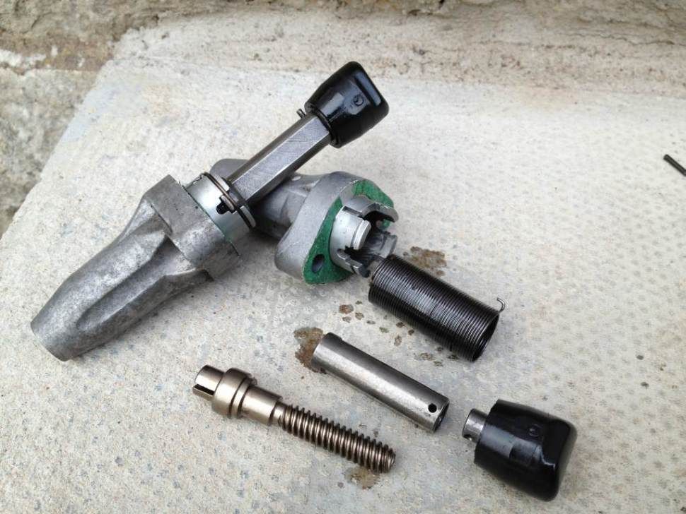

Ahh, now I'm assuming (correct accordingly) that Bazza converts the auto's to manuals?
Can see how that would be very cost affective and mechanically effective all at the same time. Is anyone able to explain the procedure or have an illustration of the internals by any chance?
I'm not death to power tools... If it breaks, it's obviously NOT a power tool!!!
Re: MCCT's. Best place to buy anyone?
Basically its a coach bolt through the centre of the old housing with some adjusting and locking bolts. If you search for "coach bolt" that will give you a lead on how its done
Bleh wrote:Ahh, now I'm assuming (correct accordingly) that Bazza converts the auto's to manuals?
And here's what the internals look like on a standard Honda CCT.

Looking at that, my assumption is the bolt has a bearing around its neck? The plunger just slides up and down the bolt controlled by relevant tension on the spring?!
So is the spring is the most commonly failing part through fatigue? No surprise considering how the coil of thin wire is under considerable stress constantly.
Looking at it, I'm more intrigued to see what size thread you'd get away with at the tip of the tensioner... Just gut it, drill it and feed a relevant sized quality SS bolt down there (length dependent with unwanted flex/ vibration in mind) whilst still taking advantage of the plunger...
Reading a mod post, the the mod is a piece of 8mm bar or so some say. Would you know if it's a 9mm thread with 1mm pitch or 10mm with 2mm pitch etc etc? Just wondering because the un-threaded diameter seems to be 8mm on the plunger, what type/ size of thread would be needed if gutting the tensioner and would there be relevant thread to be safe?
But, looks aside, this could be a substantially affordable and viable method that even the simplest DIY'ers could benefit from... Could be a good step-by-step topic for all to share...
