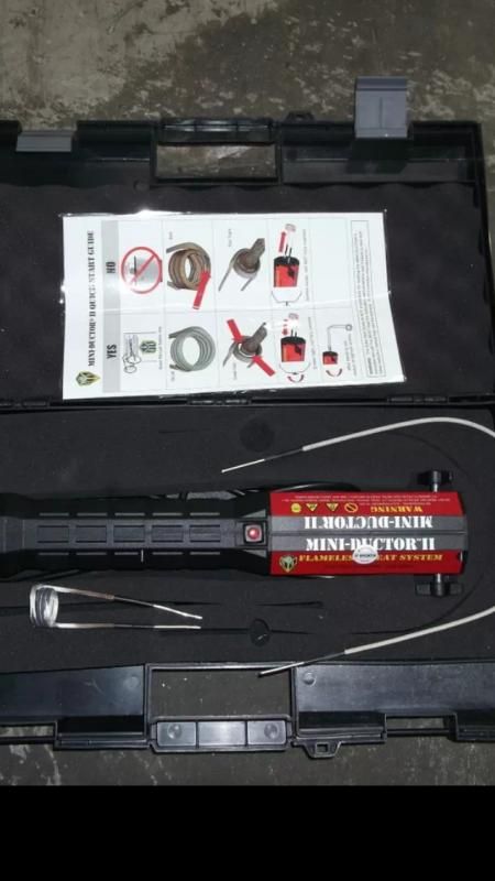

Yes, but the mine detector might be overkill.

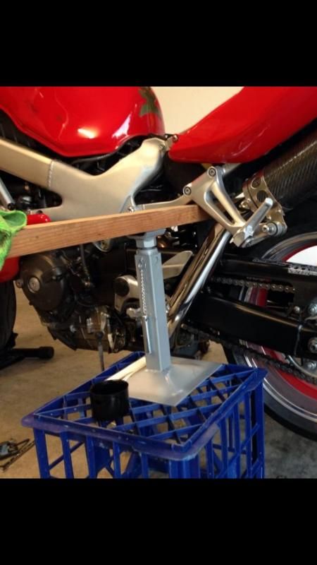

Or it could be as simple as raising the rear of the bike, lifting the front and pacing some bricks under the sump (watch the exhaust pipe though) then lower down and remove lifting devices. My personal preference is an Abba stand jacked off the engine mounts.
How to Lift/Jack up the Bike
http://www.vtr1000.org/phpBB3/viewtopic ... nd#p331788
