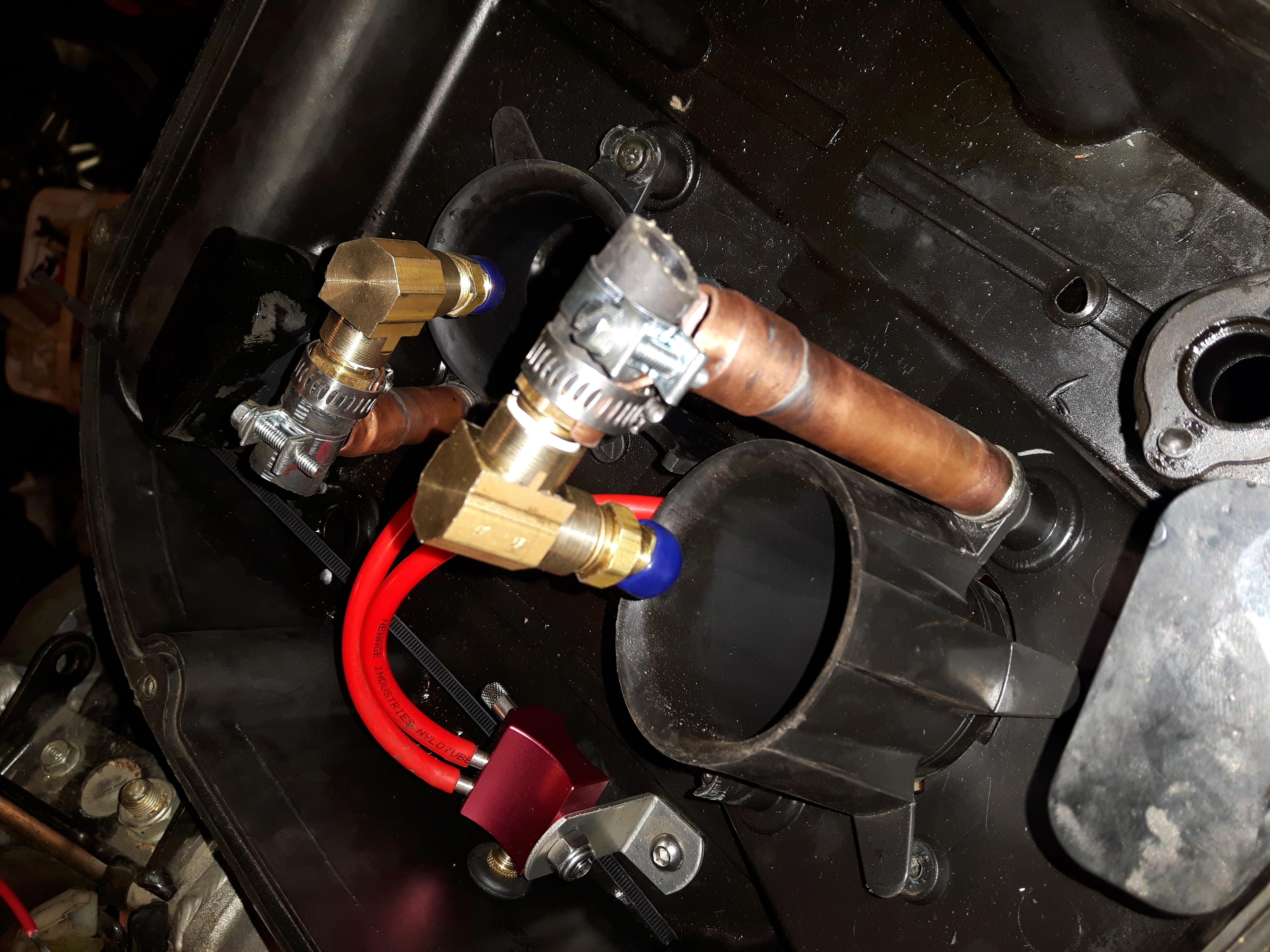

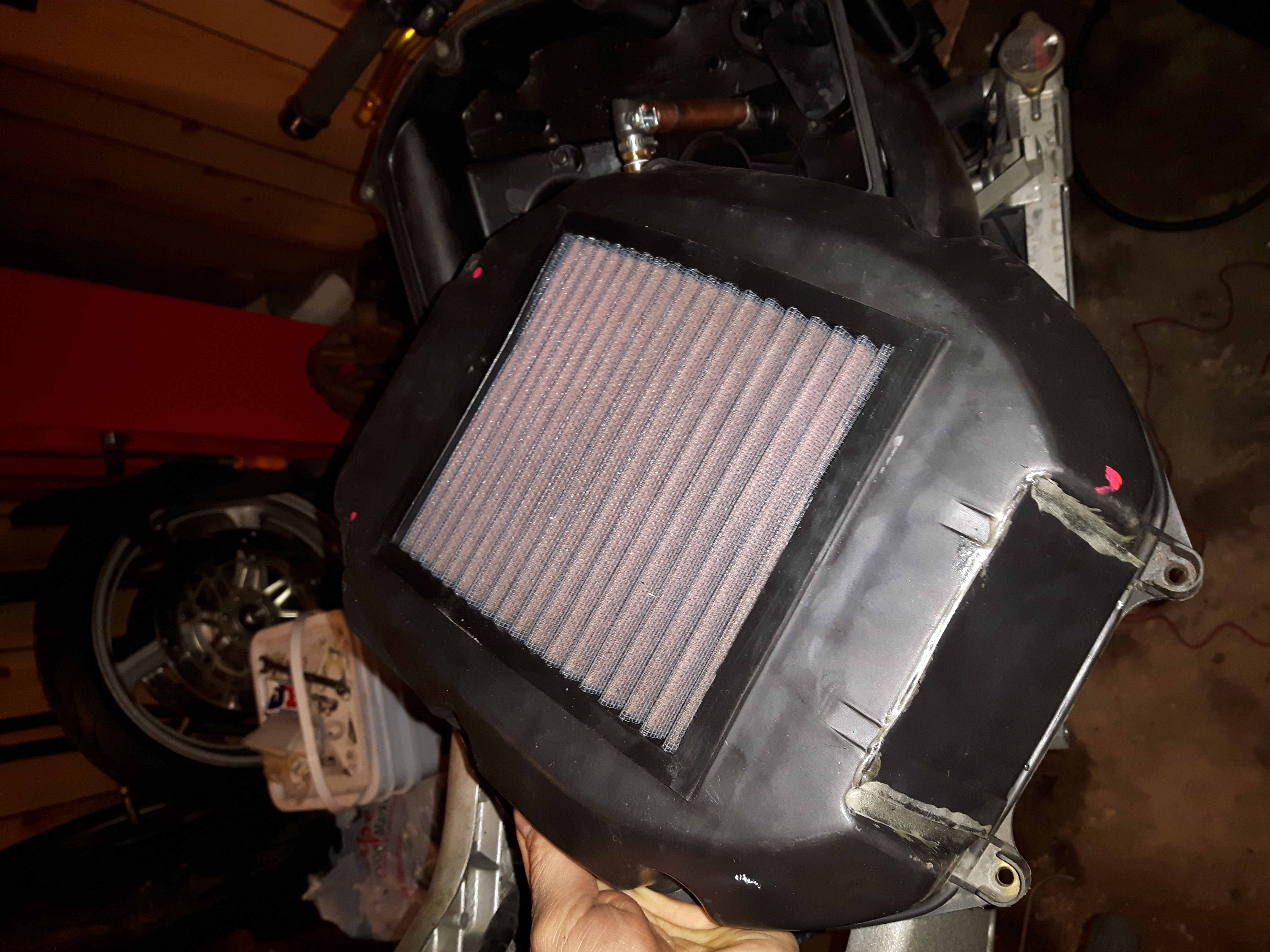

I put the air filter in the lid of my airbox to make room.. pretty sure i saw you did the same thing somewhere on here?? Then installed a injector over each velocity stack.
I will probably just inject water, and use washer fluid when it gets colder outside.

you saw correctly, am on my 3rd edition of the filter-in-lid (actually, 3.2 as I just did another revision over the winter). works very well once you get it jetted...

Nice! I just covered over the snorkel and cut a square in the lid that the filter fits in.. I can't understand what they were thinking with the oem design...seems the filter was awfully close the the stacks, but maybe its a bit quieter..

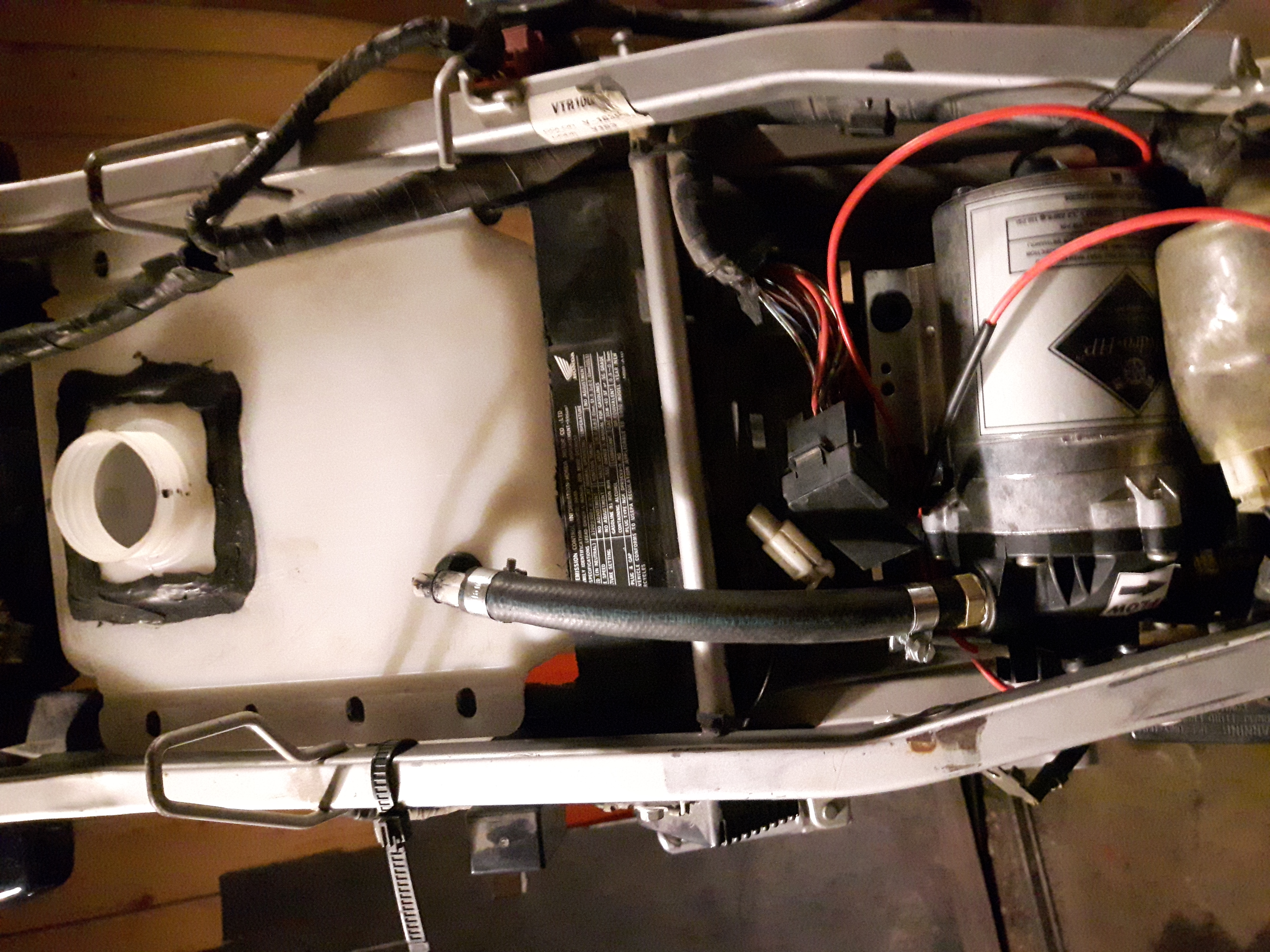

Heres what I have so far. Thats a 1 gallon tank fit into the tail, I had to put the pump in the battery box, and a lithium battery fits under it. The injection pump is controlled by a adjustable vaccum switch and relay.

Thanks for posting up the photo's, you've been rather busy :)
Re: Methanol injection
Interesting plumbing (cue Jamie) - can't wait to see dyno chart on what it churns out.

Haha i used copper pipe for the brackets if that's what you mean by interesting plumbing :lol: Just trying to use what I have around here

like the look of that filter in lid idea??
