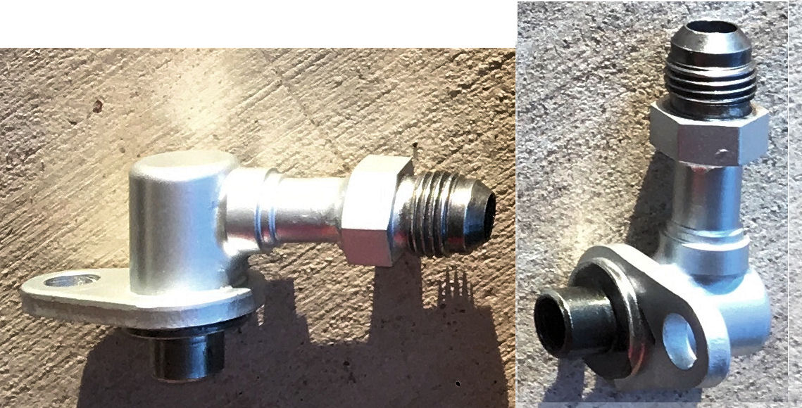

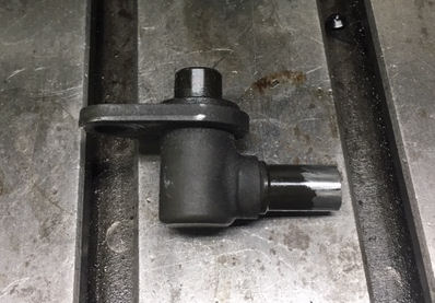

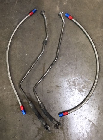

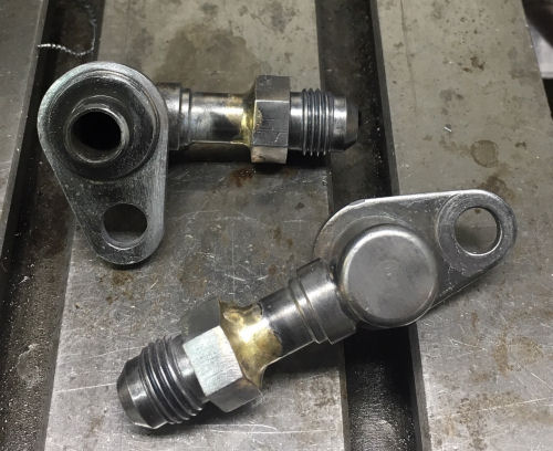

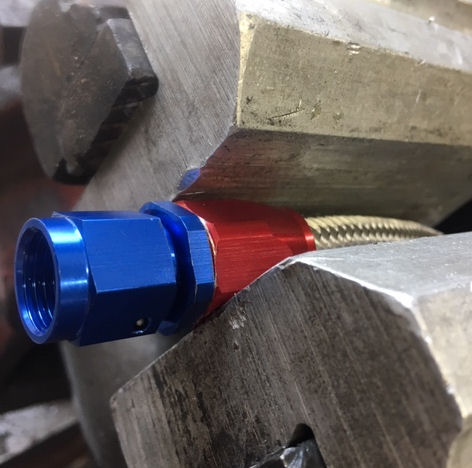

Im guessing you long ago worked out your oil lines..But if not or you want other options>>>
I did a larger front cooler swap a bit ago, http://vtr1000.org/phpBB3/viewtopic.php ... 8d#p465614
and made stainless steel braided lines using AN fittings>
The stock lines provided the funky motor fittings as a base. They were modified and had steel weld on male AN fittings braised to them
An fittings.jpg (53.79 KiB) Viewed 5409 times
oil lines new and old II.jpg (46.28 KiB) Viewed 5409 times
fitting trimed.jpg (38.91 KiB) Viewed 5409 times
stock fitting sectioned form old line, trimmed to length.
fittings un painted.jpg (61.35 KiB) Viewed 5409 times
The An male end had to be bored slightly to fit the oil line.. once done it has the same flow specs as stock.
All painted up and ready to go.
