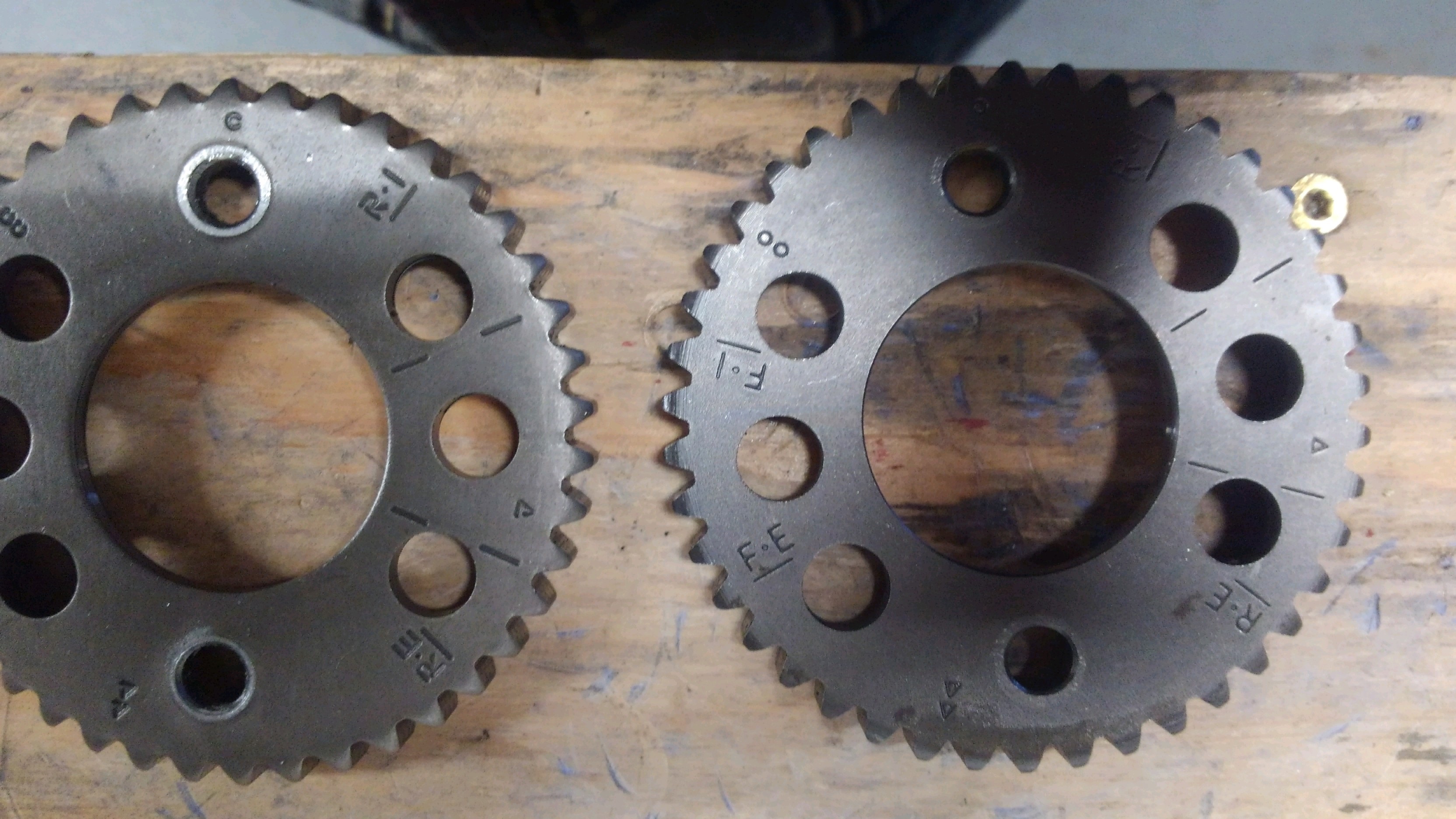

And here's the gears:
Zoom in and you'll see the difference.

Ace VenTRa wrote: Sat Mar 21, 2020 3:56 pm And here's the gears:
Bit of 50:50 here but I'm saying the one the right is the machined one. I've not experience of machining but the holes look cleaner cut and the teeth have what look like grooves in them that I'm guessing are from machine tools.
Looks like there are different markings too - two 'o's on one vs two triangles on the other.
The cam info is very interesting, thanks. On the otherhand, damn you. I was going to rebuild my spare engine as stock since cams are hard to find and expensive. But a slotting a set of gears is nowt and the cash for pistons does indeed start to look like not so much of a spend. :think:

freeridenick wrote: Sun Mar 22, 2020 6:30 pm
It would be interesting use my reground cams for intake and oem in cams for exhaust (they have slightly higher lift) - I even draw some timing for this setup. Price for two cams was good, about 130 pounds in the past, only problem is it is not probably available as of today :)
The one on the right is machined, the left is a stamped unit. If you put either one on a cam and check the timing marks there is a distinct difference in alignment. I mention that because when we time a motor we use 6 different timing marks, 2 on the crank and 1 on each cam. Plus the stretch in each chain and wear on the cam sprockets as well as the crank sprockets. Combining all those stacked tolerances leads to big differences from one engine to the next. And that is why we need to use a degree wheel and dial indicator at assembly.
