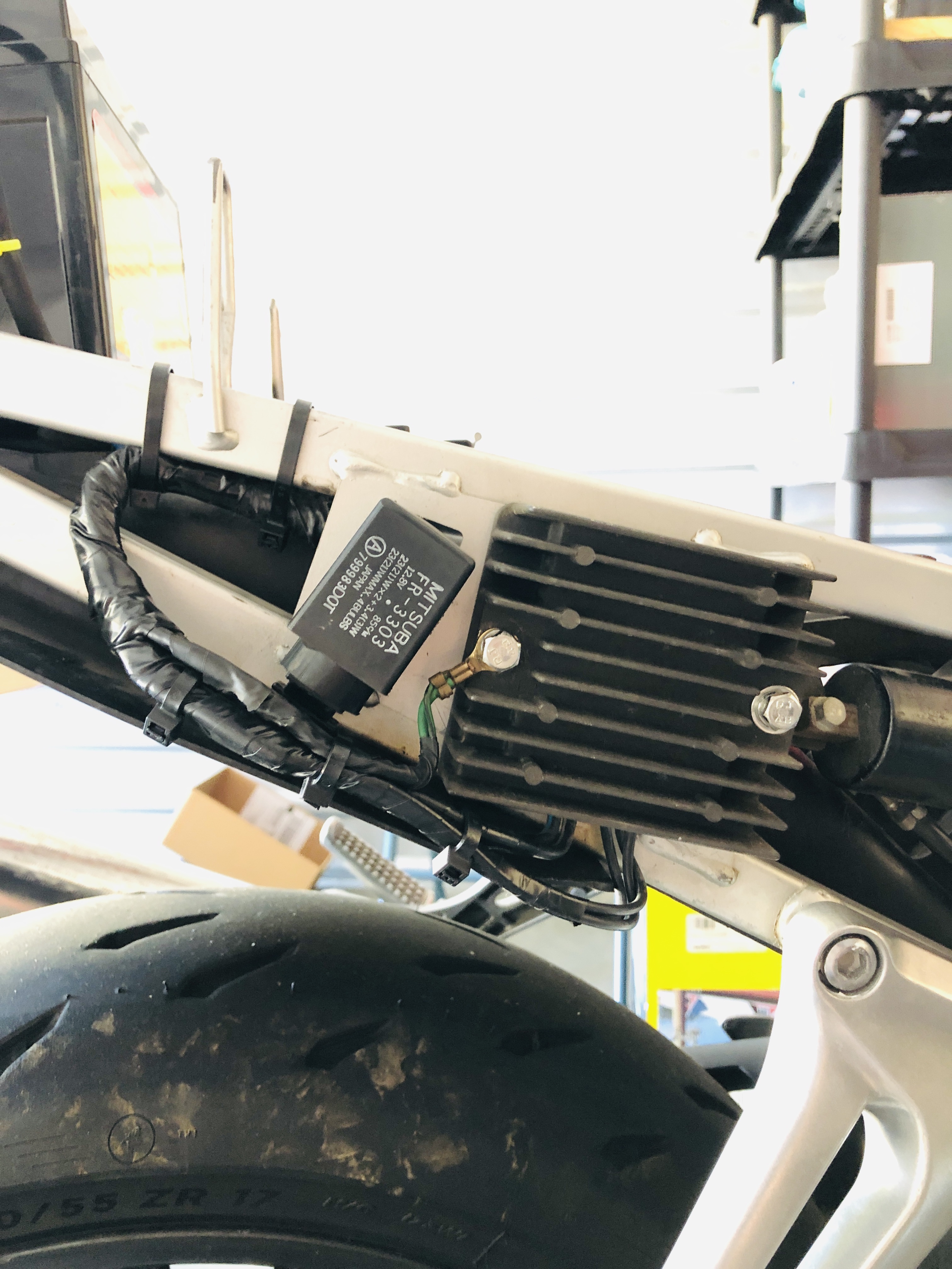

This is what I went with for my bike.
This Kawasaki unit has been recommended by many here and on the other VTR forums. 2 plug setup that I cut and spliced by soldering and heat shrinking the connections and finally tape wrapping like factory.
I mounted it with 2 nuts and bolts as seen in the picture and the seat cowl fits perfectly over the reg with no other modifications for fit. :thumbup:
You see the price I paid for it and well worth it.
