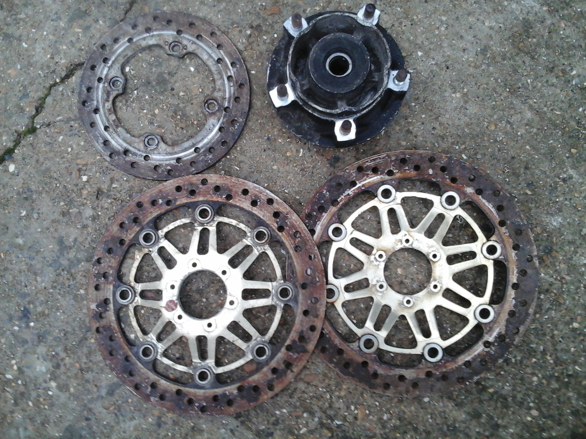

Today I won the Battle of the Disc's...
Strategically out maneuvered the dodgy disc bolts with guile, plus gas, a decent hex bit, a hammer & a breaker bar.
A bigger hammer, blow torch & a drill wer kept in reserve but stood down.
As the bolts were so rusty I had to tap the hex bit in, which probaly helped a bit.
Slight tweek up tighter, nice little 'crack' & then unwind.
100*/* surender, all out no casualties.
Won that battle but withdrew from the Battle of the Engine Bolt.
Got the castleated nuts off. Zero movement at either end.
