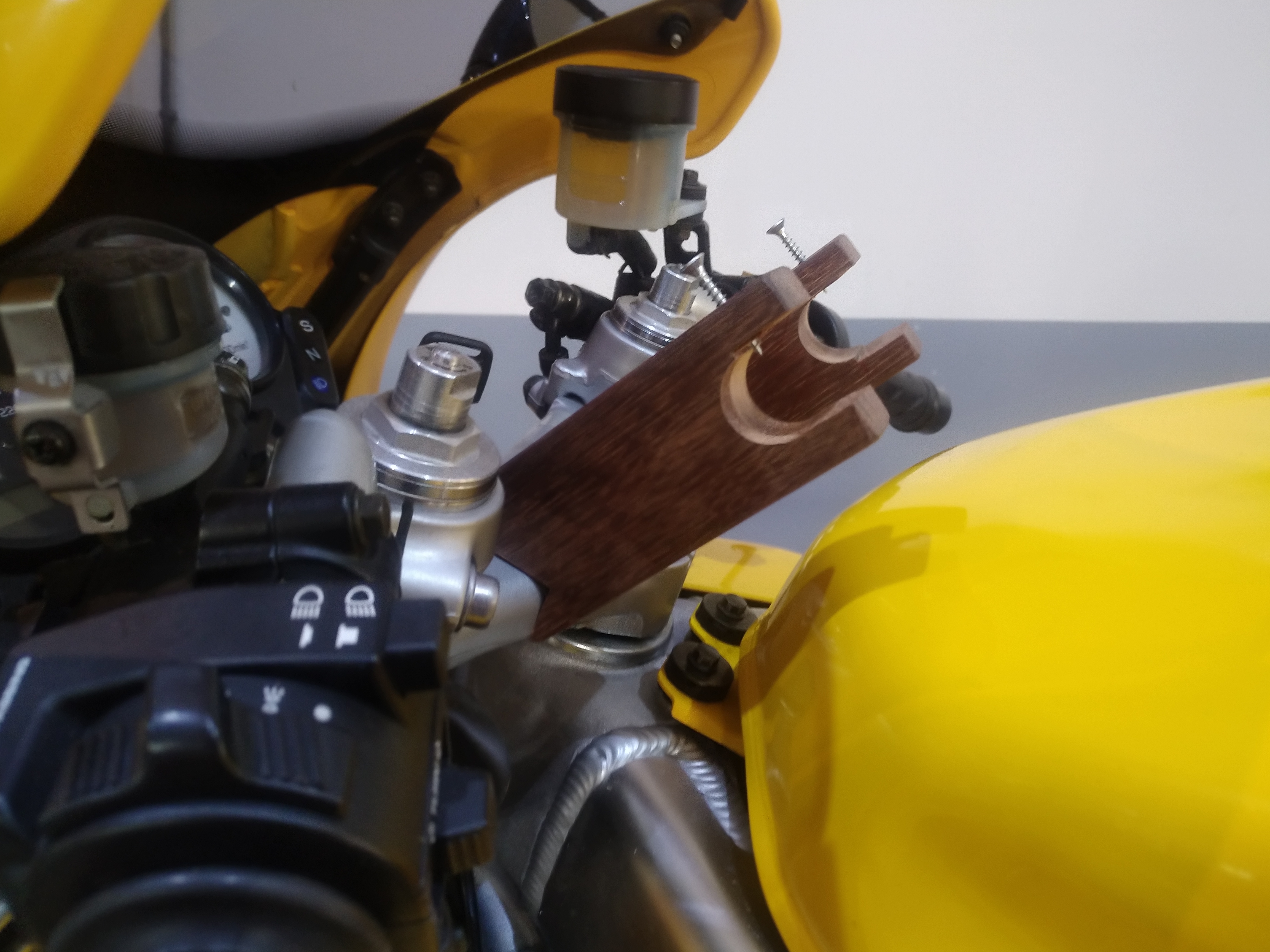

I had some nice azobe left over from a patio job, I made these, stuck them to the top yoke with double sided sticky tape. It was fine for mockup purposes (although I probably wouldn't take it on the road with bars held in place with the tape!)
Then made some nice handlebars up. Slight delay here, while I had to explain to the wife why her sweeping brush now had a somewhat shorter handle. I'm going for the "fat" bars, with a 28.6mm diameter centre section.

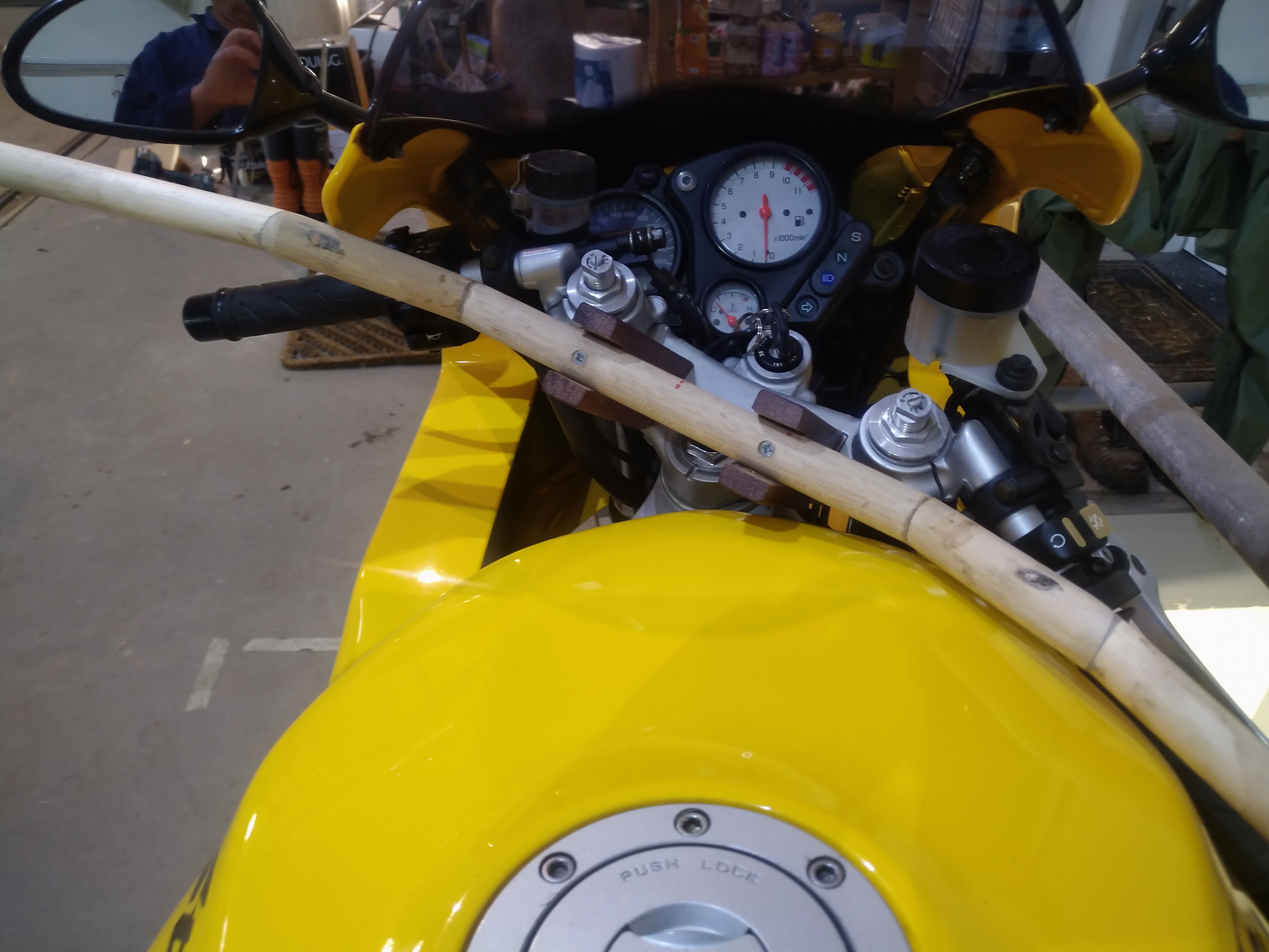

Close, but with some tweaking, should work - yes, I still need room for twist grips etc.

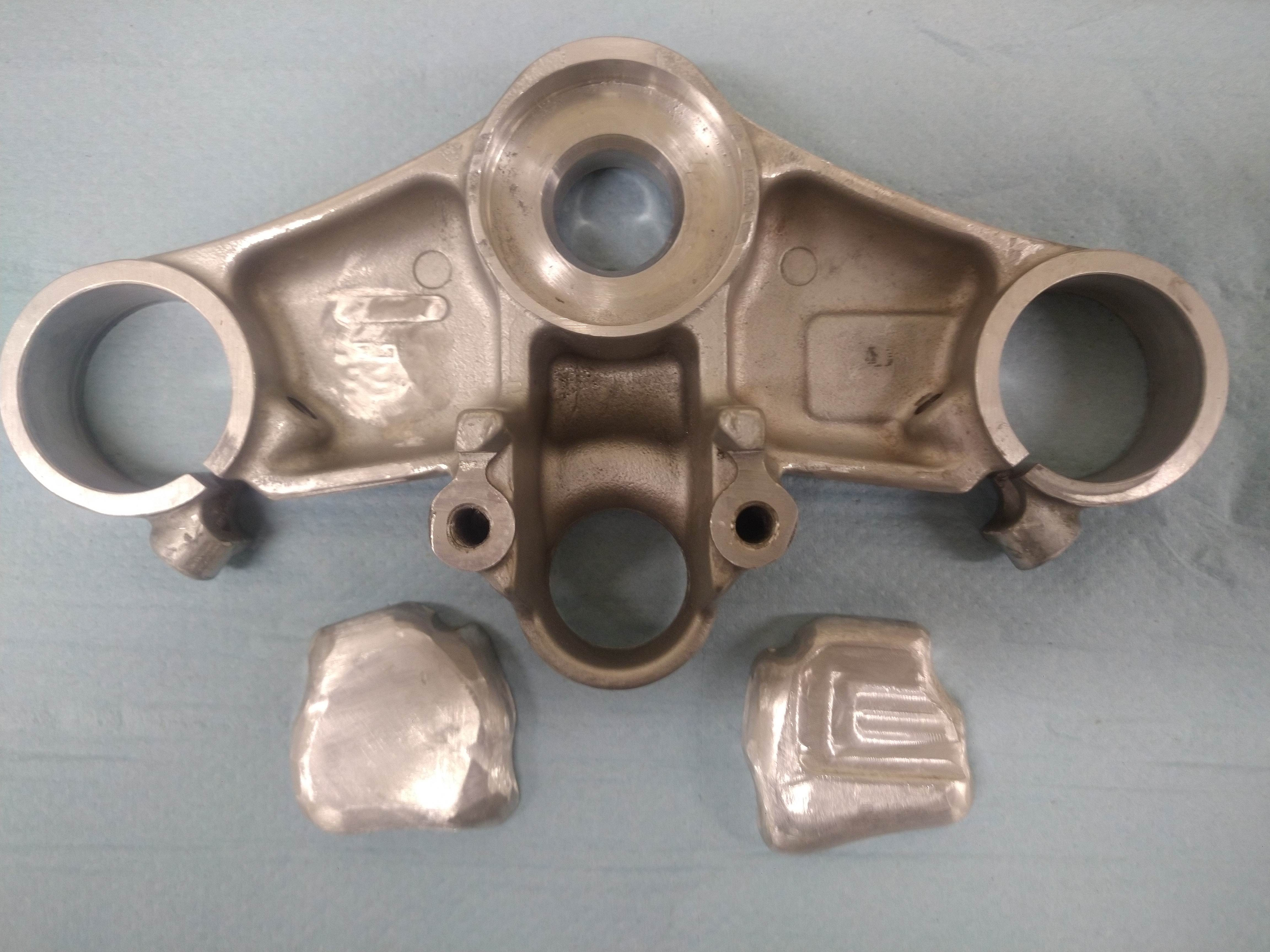

I wanted to be able to return the bike to original condition, so I ordered a used top yoke from some breakers in Belgium. A bit grubby, but fine.

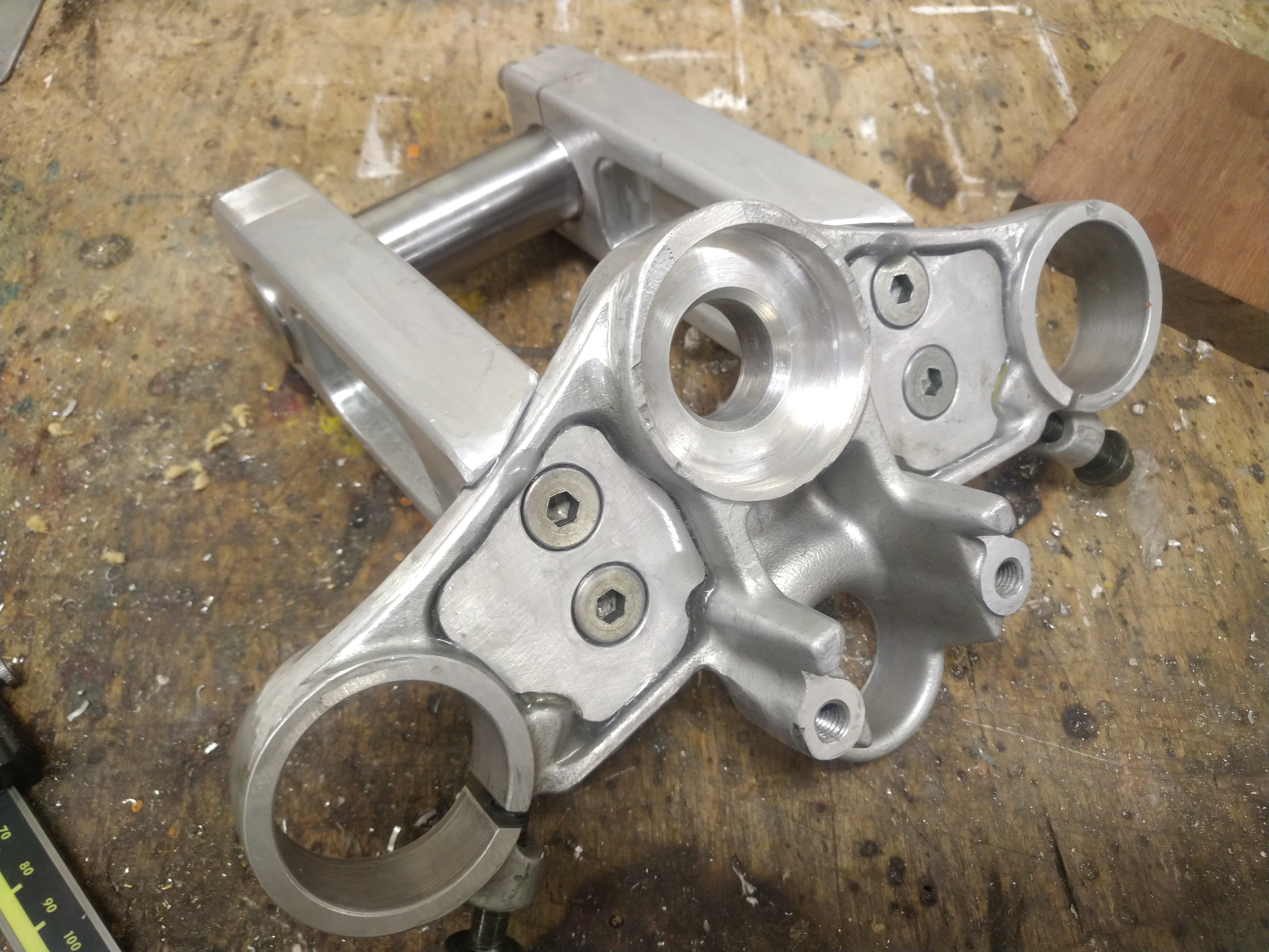

As others noted, the top yoke metal isn't that thick - I measured 4.7mm, so it needed stiffening. I had a lump - er, billet of aircrat grade aluminium in the scrap bin, 12mm thick. I cut a cardboard template, traced it onto the alloy and milled them to shape. Then spent ages sanding them to get the radiused edges. Had to mill a pocket to accommodate that little Honda badge. Finally managed it. Here they are before being epoxied in:

The top face of the top yoke was sort of flat, but a cleanup with the mill made things nicer. I epoxied a bit of alloy into the hole where the badge was, as it would get half covered. The badge was held with double sided foam tape, it levered out nicely:

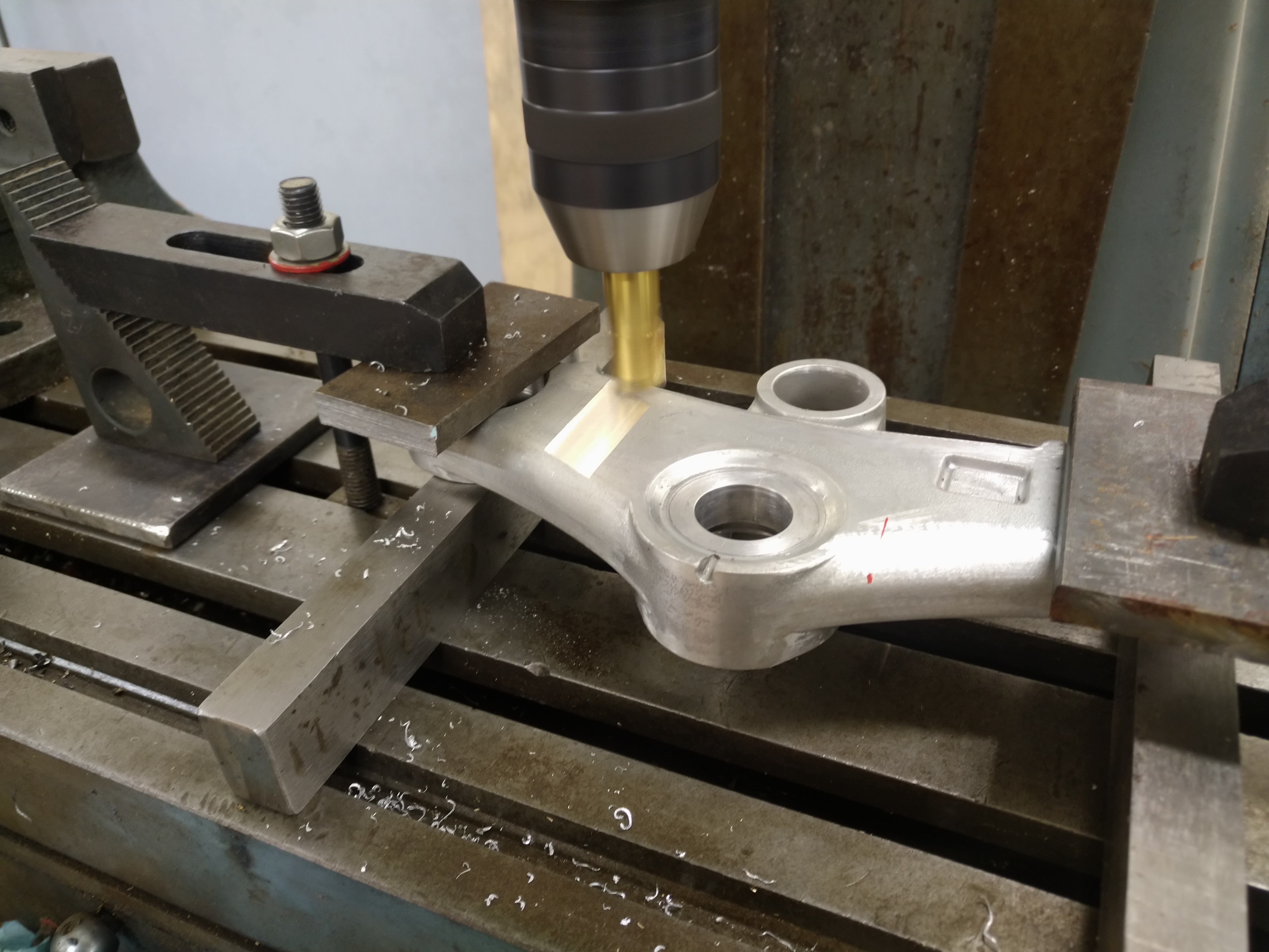

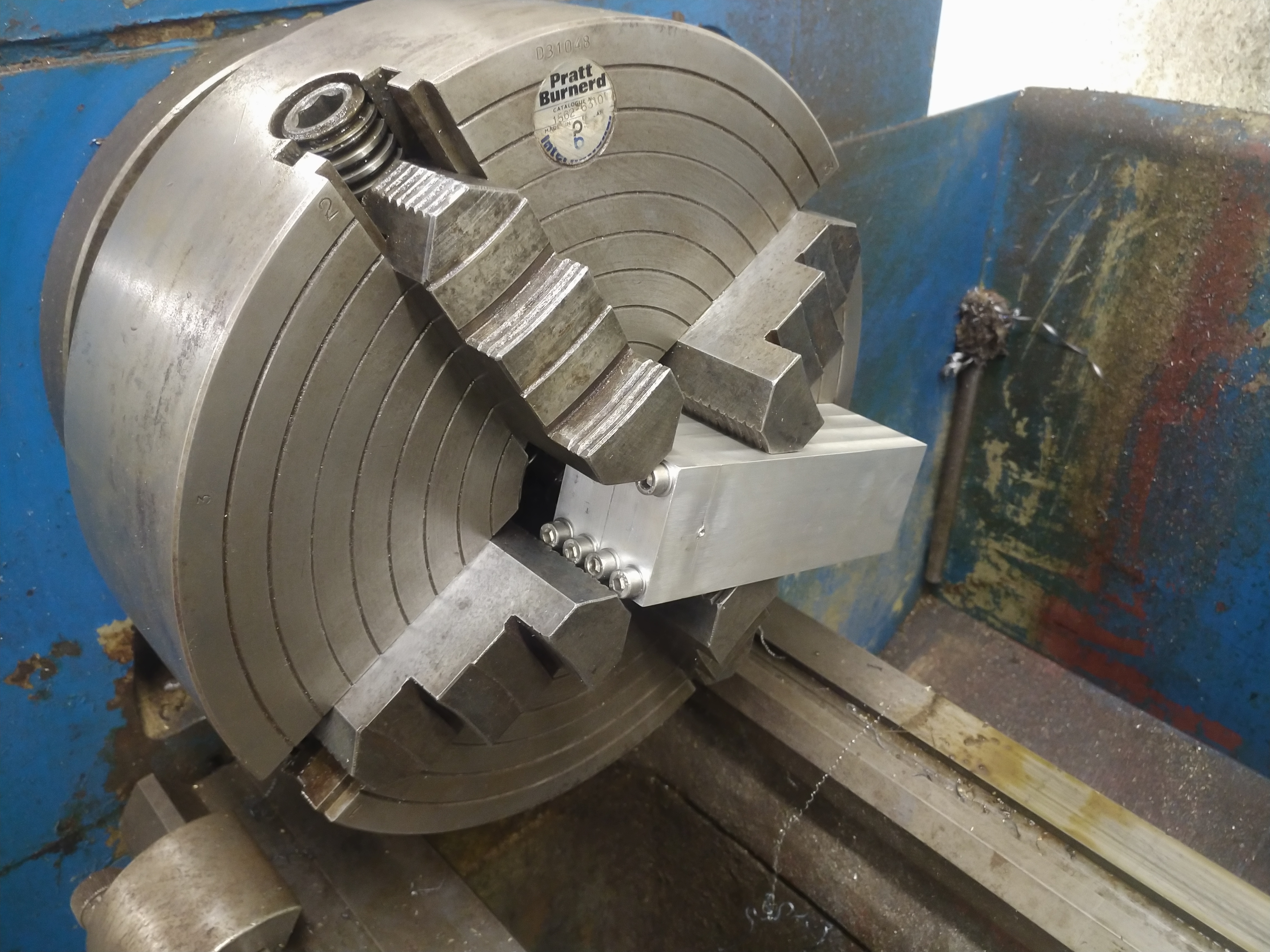

Then came the risers. They started out as a bar of alloy 50mm wide bandsawed from a sheet of 25mm thick plate. I sliced bits off the ends, these became the top caps. Drilled, tapped & counterbored them, stuck the left & right risers together with double sided tape, then bored a 28.6mm hole.
When I bolted the caps on, I shimmed the faces with bits cut from a beer can; readers of Zen and the art of motorcycke maintenance should recognise this. Beer can shim is 0.13mm thick fo reference, I used 2 layers.

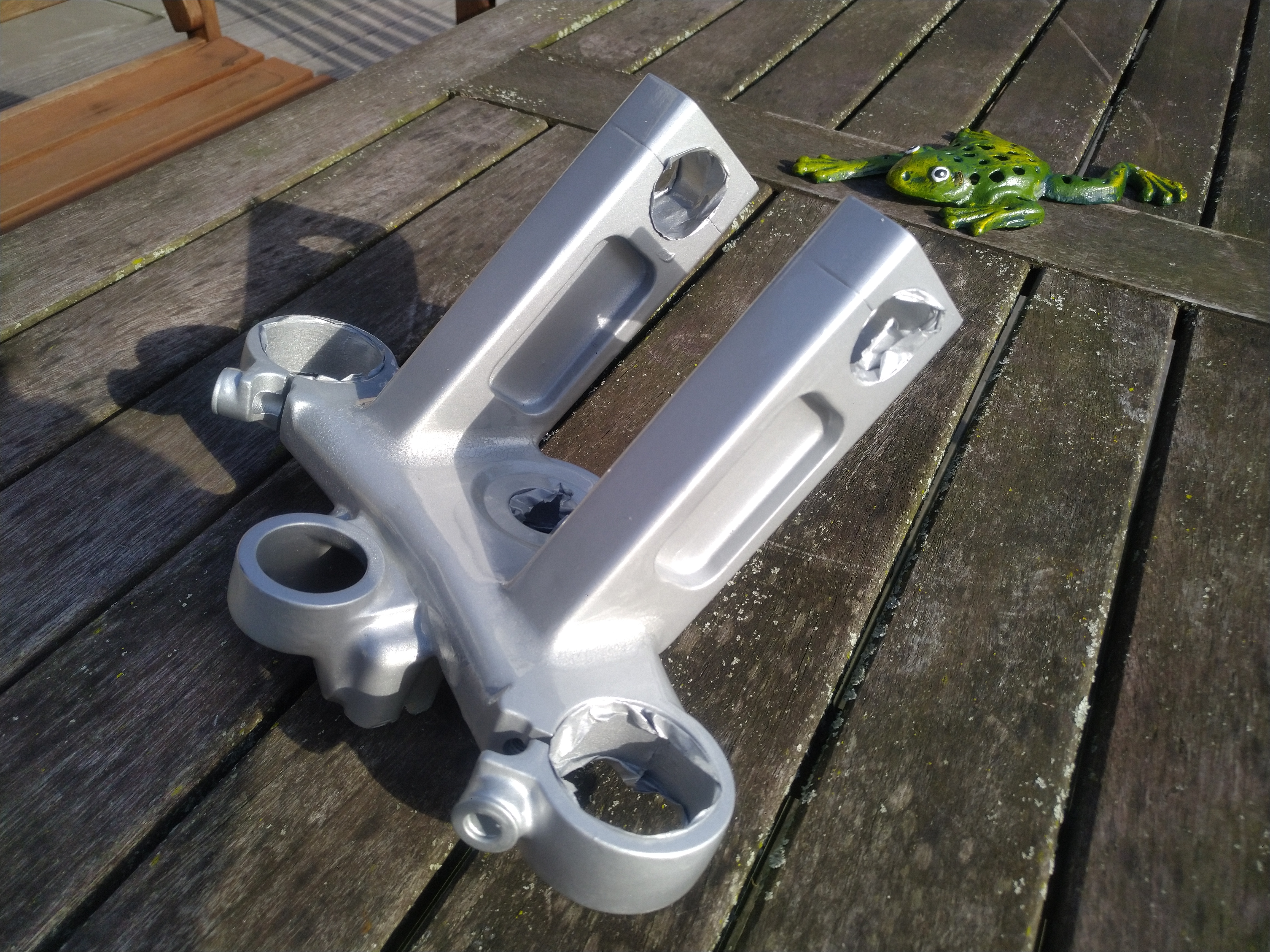

I fillered the corners to make it look nice, sprayed it silver and gave it a couple of coats of transparent lacquer. I'd also epoxied stainless washers on where the fork pinch bolts go. I'm replacing the bolts with M8 studs so that when I tighten it all up, it's steel on steel rather than steel on alloy, which I'm never too keen on.
So this is as far as I've gone so far. Next step is to swap the yokes, so I'm looking at making a bike stand.

Those pockets were milled out on my IanC milling machine - no CNC, just me twiddling the handles. Good enough for what was needed. More for appearance than actual weight saving. The whole design principle was "anything I make / add on will be at least as strong as what it's fixed to". Having the bars come off in your hands at speed would ruin the day.

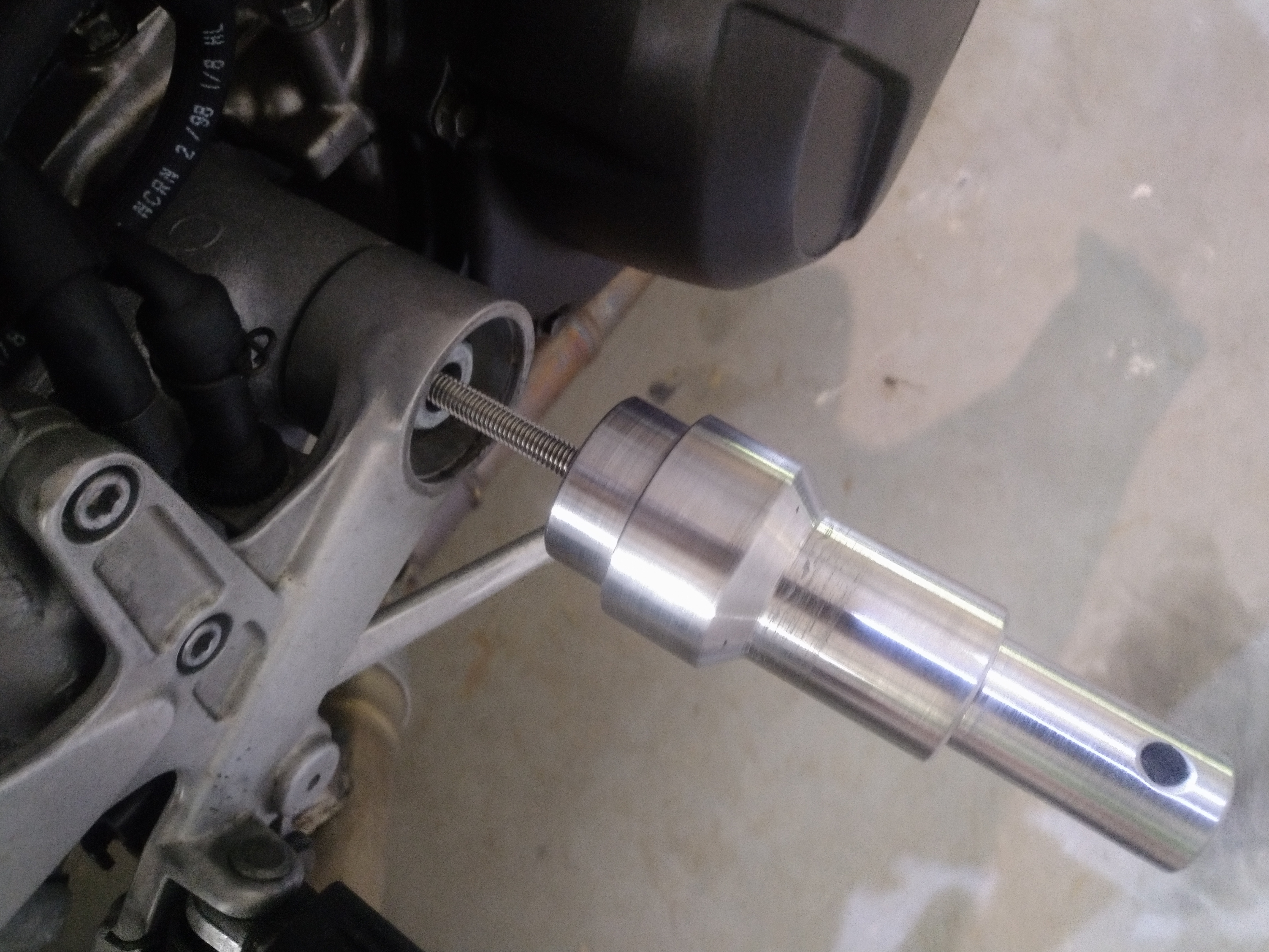

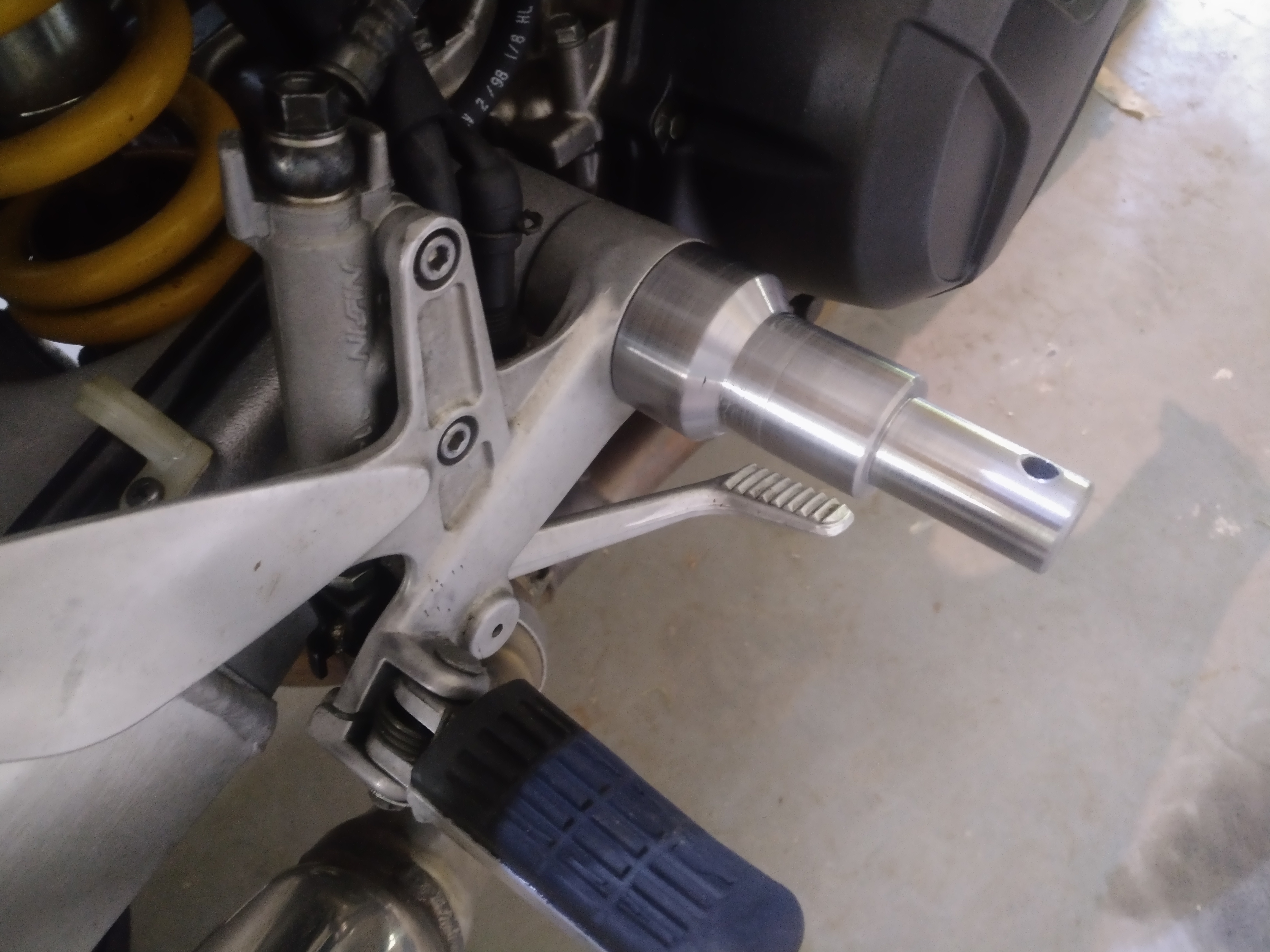

Here are the swingarm lifting pins. There's a 42mm diameter hole in the frame where the pivot bolt is - this is what the black overs snap into. I made the pins with a 42mm diameter spigot, 18mm long. Bored out to 35mm inside, to clear the pivot head / nut. The 2 pins are held in with a length of M8 threaded rod, all the way through:
