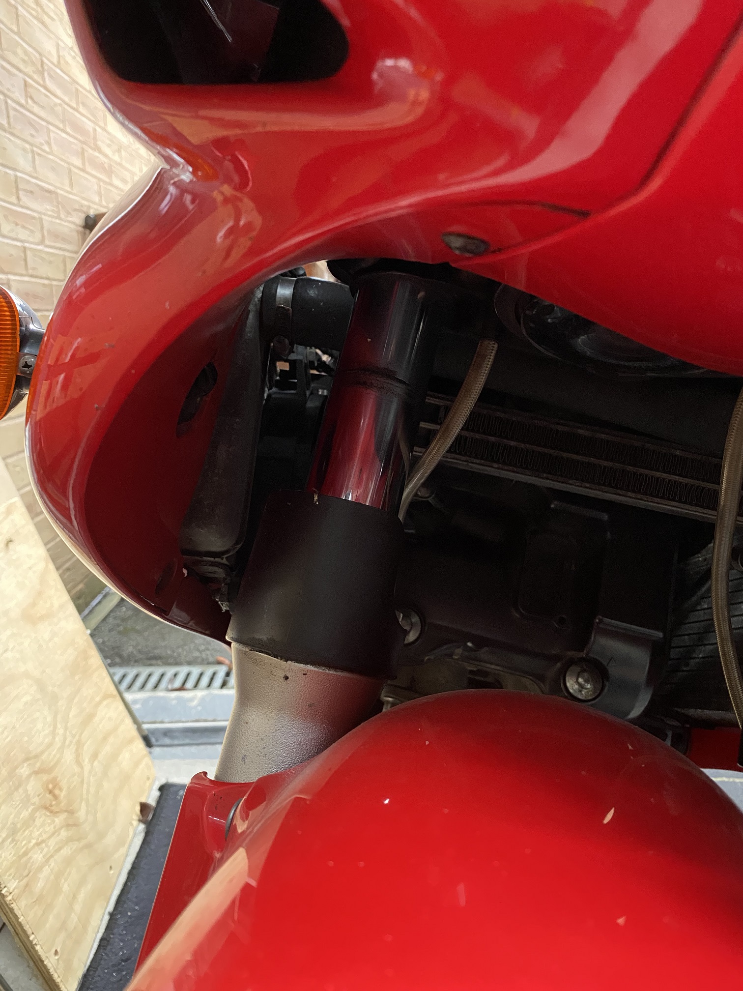

Looks like I've blown a fork seal.
My knowledge of suspension internals is sadly lacking. So is it a case of removing the fork and getting my local shop to replace it?
The forks were worked on my Roger about 4 years ago, so do i just need to tell them the oil weight and air gap provided by Roger?

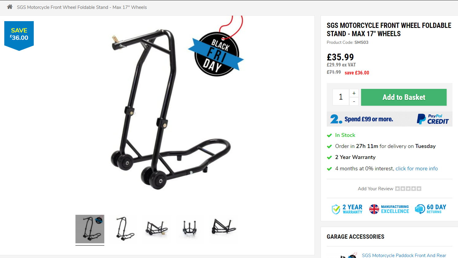

Cheers, i'll put the stand on my Christmas list to myself.
Any recommendations for the make of stand and pin size? The ones I've seen max out at 18mm, the internal diameter of the steering tube measures 22mm i think.
Lee
Posts: 21812
Re: Front fork seal
Mototrick wrote: Sun Nov 20, 2022 10:58 am Cheers, i'll put the stand on my Christmas list to myself.
Lee
https://www.vtr1000.org/phpBB3/viewtopi ... 0889&hilit
I can't say what the quality is like, but worth a look I'd say.
Black Friday deal here: https://www.sgs-engineering.com/sgs-mot ... rbEALw_wcB
I hope you're in the UK,
