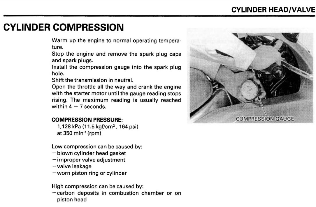

According to the Honda Shop Manual: Chris.Aly wrote: ↑Thu May 18, 2023 9:42 am thats an interesting situation to be in. You needed to put some oil in it so not to crank it dry but that oil will mask bad rings. If its not worth rebuilding you dont want to screw around with carbs and whatever else is wrong it just to find out the rings are flogged. I think id be inclined to try and wash some of that oil out with petrol and redo the comp reading. If the compression starts to drop... Anyone know the right reading for these?

Thanks Chris, but the spec'ed reading wasn't exactly my point. More that this gauge reading cant be trusted as an indicator of engine health. That its exactly on spec only shows the top might be good. Although like MK_WF mentioned excess oil will drop the chamber size - thus making extra compression and maybe compensating for leaking valves. So all in all a kind of worthless reading? I'm only harping on about this because I often struggle with diagnostics and find myself changing more parts than warranted (more cars than bikes in my case).
