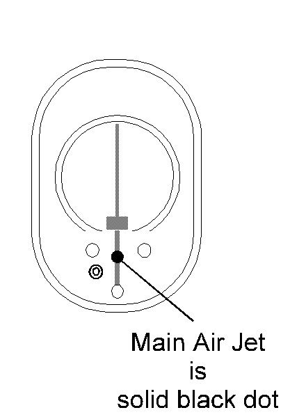

I've just been trying to take advice from Leigh of Factory Pro.
Just FYI, and build up/back ground I've included my email conversation with him, he gives some interesting points & a pic:
From: Ian GMail Acc <igriffit@gmail.com>
Sent: Mar 18, 2013 11:40 AM
To: Leigh Thomas <leigh@ix.netcom.com>
Subject: Re: UK Honda VTR1000
Leigh/Gents
I have fitted your + 4 advancer and that has gone well.
Now, I am hoping for your help: I took my jet kit (see details below) to a Dyno company to fit & tune in (Weds 12 Mar). He wasn't comfortable with drilling the carbs, but to be honest wasn't comfortable with exactly what he was supposed to drill.
Could you send some more detail about the drilling of the main air jets, maybe any pics & details of what the effects should be?
Many thanks.
Ian Griffiths.
Then:
On 18 Mar 2013, at 19:16, Leigh Thomas <leigh@ix.netcom.com> wrote:
Ian, the main air jets is located in the bellmouth(where the air enters) of the carburetor. On a Keihin carb it is the jet directly inline with the needle. There is only one directly in line with the needle. Drilling the main air jet will increase top end full throttle power by 1-2 hp. If you don't want to do it, that's ok. The kit will still work ok. Just won't hit quite as hard on top.
Regards,
Leigh
Then:
Sent: Mar 18, 2013 12:25 PM
Leigh.
Ok, thanks. Couple more Qs:
When it's drilled (I know there are 2 sized drills, front & rear), are the drills enlarging the current hole or making a fresh hole?
I will want to make sure there is no leftover metal from drilling; will I have to dismantle carbs to fully clean out? I can't imagine what I'm drilling through to? Float bowl?
Do you have a pic or link to a pic to show where needs to be drilled please?
Regards. Ian Griffiths.
Yes you are enlarging a hole that is already there. Yes you have to remove carbs and clean out any debris. I can't find a picture. Attached is a drawing of the MAJ location. You should remove everything(jets etc) from the carb and clean.
Leigh
I know it's a lot of text but I often find it useful to have detail in the requests. I also wanted to show how useful the FP guys are, over a quick email conversation!
I'm just planning my next carb fettling!!!
Hope you find above useful, because I know it isn't initially made obvious what the action of drilling the main air jet will do.
Griff.

Nice one, that's useful info, especially the bit regarding drilling right through to the carb bowl which was the bit I did not know about regarding drilling. If any drilling is to be done then make sure the diaphragm slide and needle is removed and also the float, main jet and emulsion tube from the float bowl before any drilling is commenced. I'm very tempted to give it a go on my spare carbs. :think: And note that the drill bits are different sizes for each carb just like the main jets.
I agree with Tony by adding more air it may require larger main jets to balance out the A/F ratio but not 100% convinced. It's seems logical, more air=more fuel required to balance out the A/F ratio. But the reason I am not 100% convinced is because with the HRC kit that is designed to run with no airbox (much more air) the main jet sizes are in the 150's-160's, smaller than standard. The other clue that hints that it may require small is that in the FP CRB-H77-1.7-RK kit they don't supply a 188 main as they do with the CRB-H77-1.1-TI. Just seems to be odd to me why they leave that out.
I'm not sure how drilling the main air jets only affects top end. I would have thought it would add some top end as FP say but not just top end but all the way through the range. I may be wrong as I have no experience with drilling these carbs and how it effects the jetting side of things as to whether it requires smaller or larger mains. I would like to think it would be smaller as this would save fuel or is that just wishful thinking :think: You never know you may discover a way if saving more fuel. Mmmm interesting.
Nice to see Factory Pro are being helpful and answering any questions. Thanks for sharing that. :thumbup:
And here is a pic of the Main Air Jet on our carbs.
