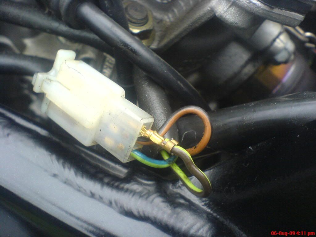

Just got it started again so I doubt its the sprag clucth. Phew! :thumbup: :thumbup:
It is struggling with fuel though. Starts fine with slight choke ticks over nicely. Then it just cuts out and wont start again.
Any suggested areas to check?

tisnt that though bud. what is it doing exactly? are you sure you didnt pop a fuse trying to frig the solenoid?
check if theres a fuel filter.
check the fuel pump is primed proper and not airlocked.
benny hedges
Posts: 6110
Location: Warrington
Re: Sorry....can I stay?
Post by benny hedges »
try connecting the fuel pump directly to the battery and see if the fault goes away.
apparently they suffer with wiring faults and dodgy connections between the fuel pump and relay.
this could still be a starter sol issue.
check the killswitch and fuel pump relays
https://www.apriliayorkshire.co.uk/cata ... l%20system
and the sidestand switch connectors. :thumbup:
to bypass the sidestand switch bridge the black & brown wires.
seems this is a common fault :thumbup:
