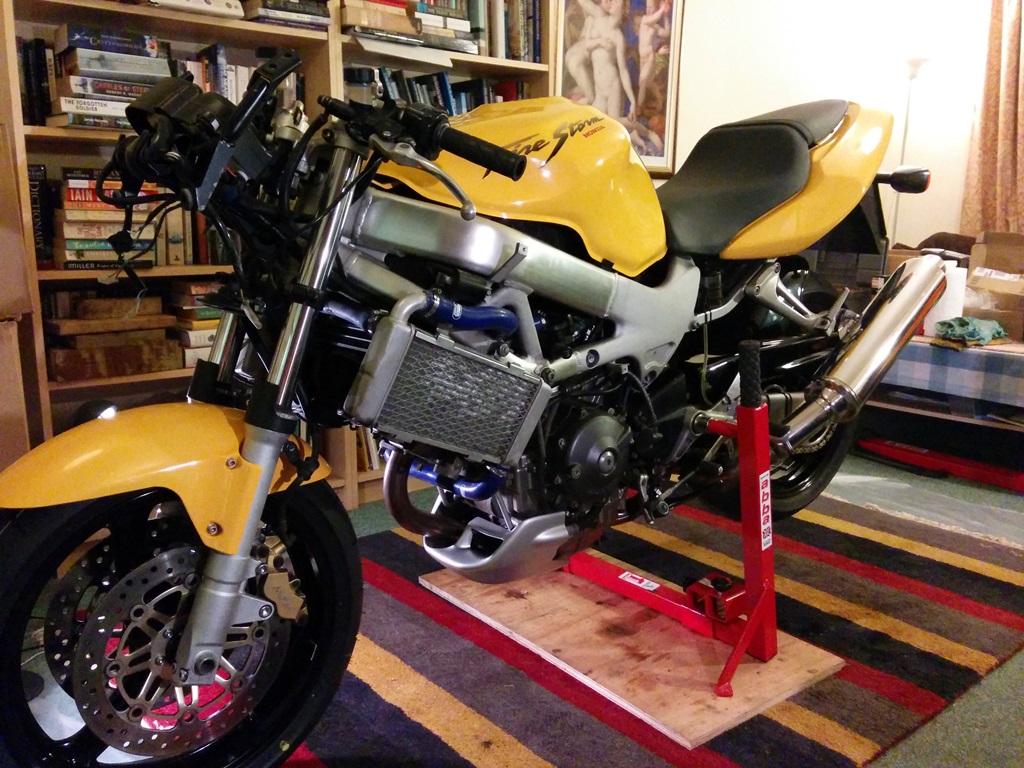

Set the TPS to 500. Was easy enough. Changed the torx bolts to allen bolts, got it close (498), did them up tight then used a drift on the top left side, light taps with a hammer and it adjusted to 500.
Did the 6mm spacer on rear shock.
Fitted sync pipe on front carb
Fitted front and rear refurbished callipers.
Fitted fuel cap (cheers Mac)
Not bike related but repaired neighbours fence that had blown down in the wind.
Hoping tomorrow to get it running for the first time in nearly two years.

Lol I hope not, hoping the carbs aren't too far out so it will at least idle so I can sync them. Once done probably have to redo tps but we'll see.

Cheers lloydie, circulated the oil today with battery, now on trickle charge, coolant filled through rad and pipes squeezed to get rid of some trapped air in system, will run with rad cap off to expel more. What's NRT? (Near running temp?)lloydie wrote:Remember Rogers start up guide after a lay up .
