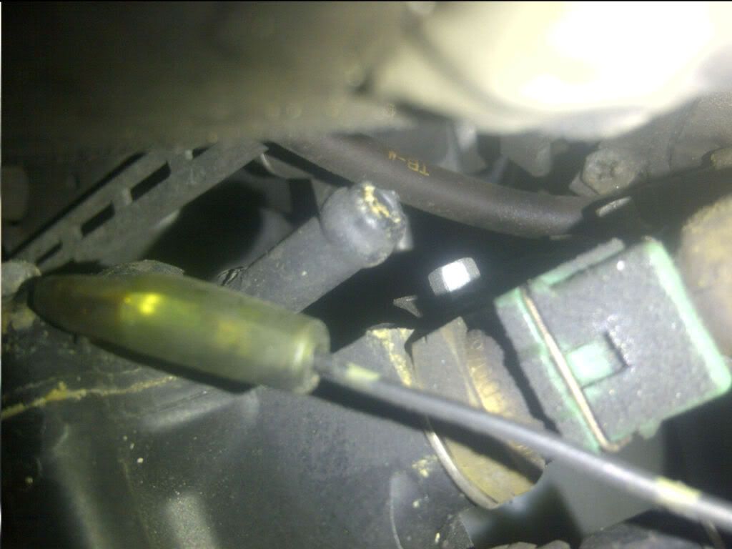

Not decided yet on whether to screw or T-pipe LOL
On the pic below of LHS carb, is that black rubber perpendicular dead end thing the screw for the scottoiler carb screw?
Re: Fitting a Scottoiler?????
that looks like the thermostat caped off pipe (leave it alone )
the front vac pipe take off is under the front inlet on the cylinder head
That's not the vacuum, I can't quite make out what that is. Near the thermostat I think. On the left hand side of the bike at the rear just below the carb rubber you will see the vacuum pipe that leads to the fual tap.
You can see it on the right hand side of this pic
That's where you want to put your Tpeice, cut the pipe and insert it along there somewhere.
