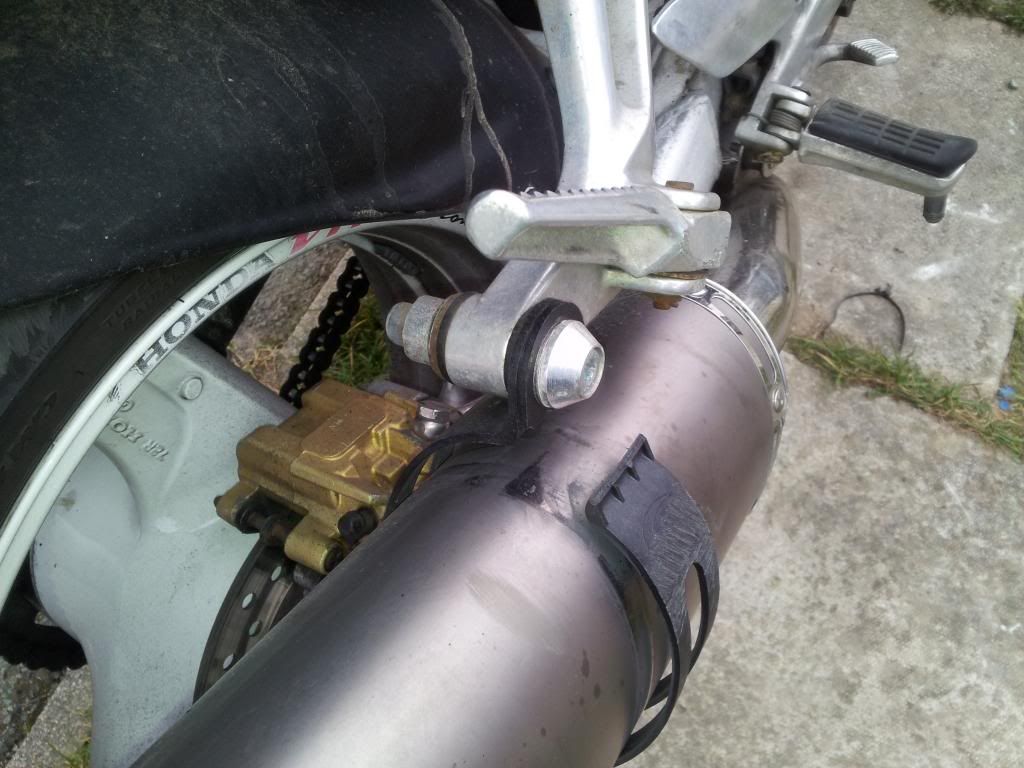

get a hair dryer or heat gun on your brake pedal, slowly heat up and graduelly bend it back into shape, slowly does it tho, heat/bend heat/bend heat/bend, repaeat this many times but only makes small adustments each time to avoid the pedal snapping..... :thumbup:
Re: Clutch case.
I see what you mean about the hanging straps now. Strange that they are made of plastic.
