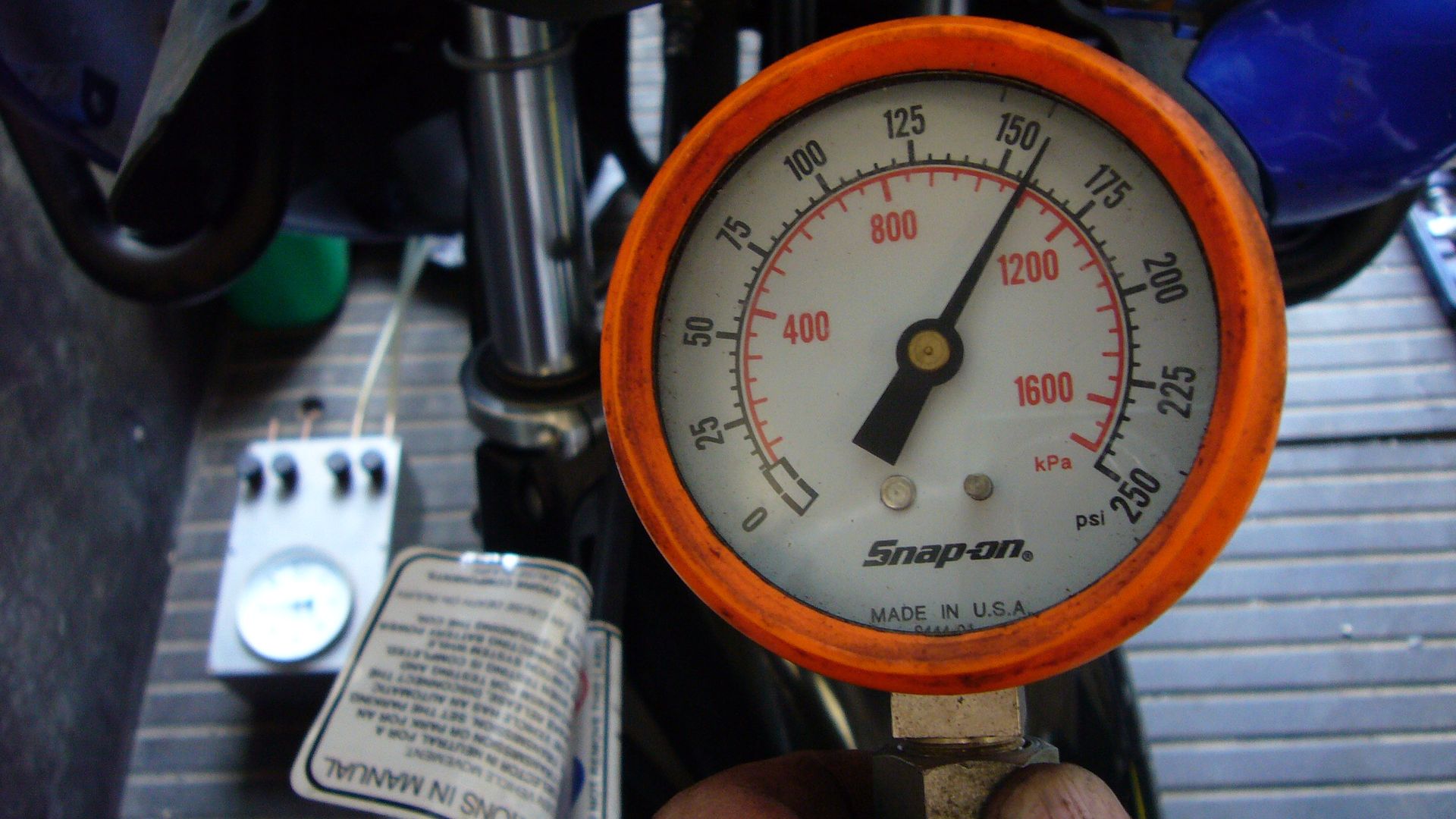

Latest on the search for the problem is a compression test.
I removed the plugs & connected the compression tester to the cylinders, front first, then rear.
I never applied oil or any spray lube into the cylinders to aid sealing. For both tests I held the throttle wide open & hit the starter for around 5 seconds each.
Front.
Rear.
Thank god it looks okay, well to me anyway :D
I was worried I had burnt out an exhaust valve due to my lean low-midrange home made filed needles :roll:
Looks as if it could be electrical & I'm not too good with electrics :sad2
As usual, any advice, help or Tips really appreciated guys :thumbup:
