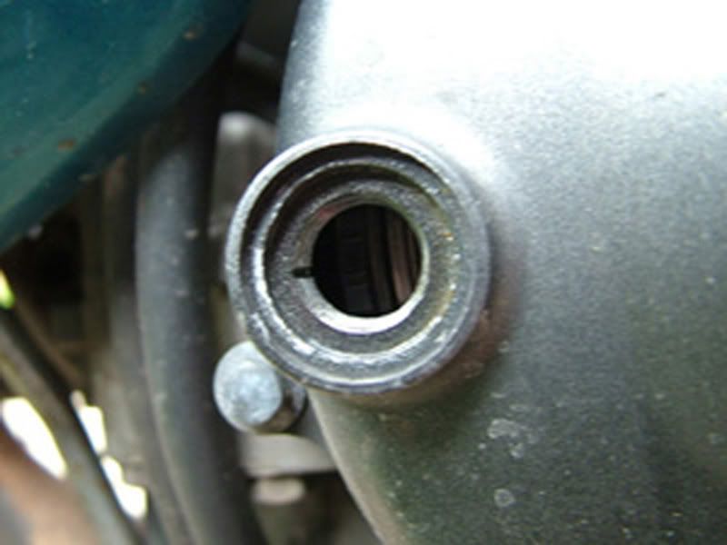

Damo shame you could not make it. I felt a bit like you regarding the CCT's but now I have watched it being done it has given me that bit of extra confidence.
Here's some pics that may be of help.
Timing mark for rear cylinder TDC on the compression stroke.
Note the alighment line next to the RT lettering.
And this is the position for the cam lobes on rear cylinder.
The rear cylinder is simple as you will have the rocker cover off and can visually/pysically check the tension on the camchain once the adjustment has been made on the new CCT.
Once the rear cylinder is done, turn the engine 1 and quarter turns anti clockwise untill you see the FT mark line up.
Sorry this pic is not as clear!
With regards to the tension on the front cylinder, as the rocker cover wont be removed, unless you want to spend an extra 3 hours stripping the front end down. you have to do it by feel. The manual CCT need's to be tightened up untill you just start to feel the tension (finger tight) be carful as it is easy to go past this point as the tension you feel is not hard (as the chain is loose) and it's easy to go beyond this point. Once your are happy that you can just feel the tension, unscrew it half a turn. Maybe put a bit of paint on one side of the bolt on the thread, so as you turn it, you can judge half a turn more precisely.
