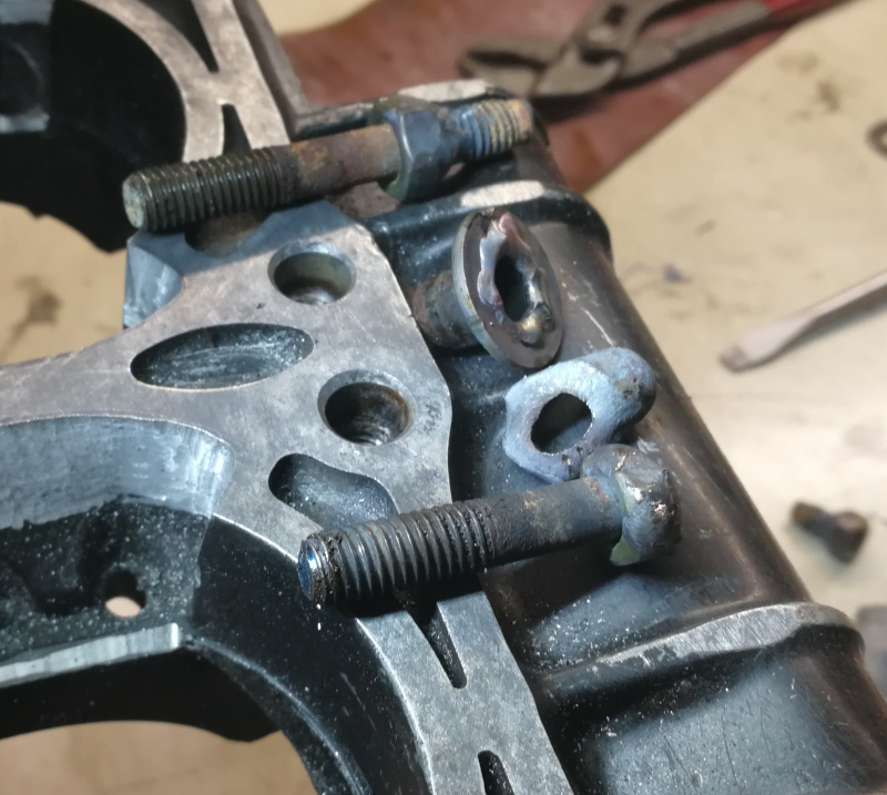

Man how I hate rusty old stuff!
Front center studs on the RD350YPVS case were rusty and fitting sleeves screwed up.
Usual methods for removing failed, so welded a nut on each stud. Tried the first with the rattle gun - not a good idea. It broke off immediately.
Tried the second one with a spanner and an old RD stanchion as an elongation which worked as intended.
After welding a second nut on the first stud the above method was strong enough to separate the nut from the stud...
So I tried a third run of welding and wrenching which finally worked.
I wasn't really surprised that one of the fitting sleeves was stuck, too. So I welded a washer on the upper edge and got it off with a chisel.
I guess I'll leave the other 6 studs as is....
