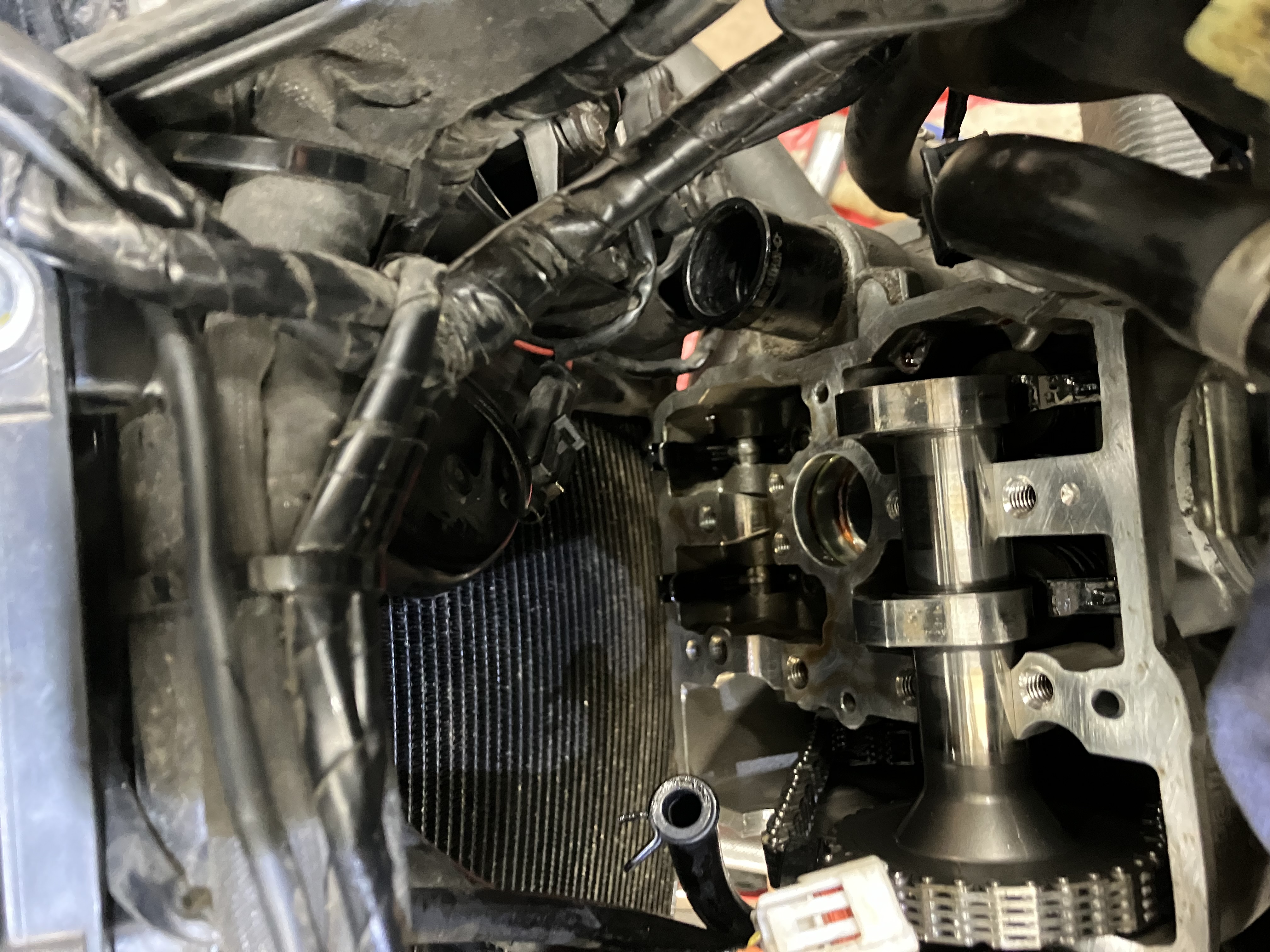

When i checked the KTM valve clearances all 4 exhaust valves were pretty tight on the 0.25mm feeler gauge, which is bottom spec, and I had told myself that it would be fine till next service and was going to to build it back up when the 4 spark plugs arrived.
Bad move having too much thinking time!!!!!! It is a sh1t load of hassle to get this far into the guts of the beast, and for a bit more work I could get the clearances up to top limit…. So that’s what I have started!
Front cam out and now waiting for the new shims so I can reset them, then it will be onto the even tighter constraints of the rear cyl head.

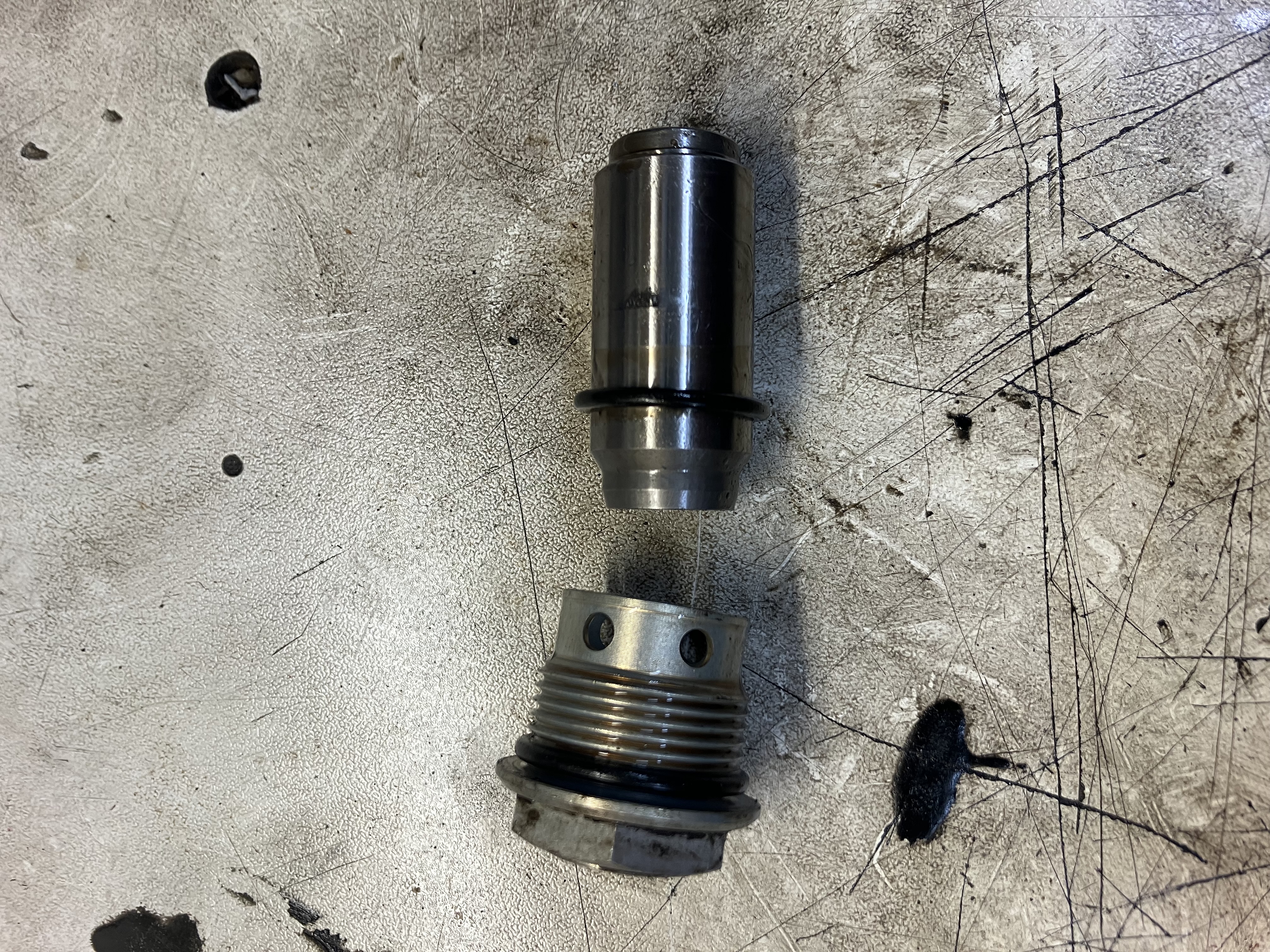

This is what a KTM oil & spring powered CCT looks like.
KTM CCT
KTM CCT
The front head
Front head
Front head

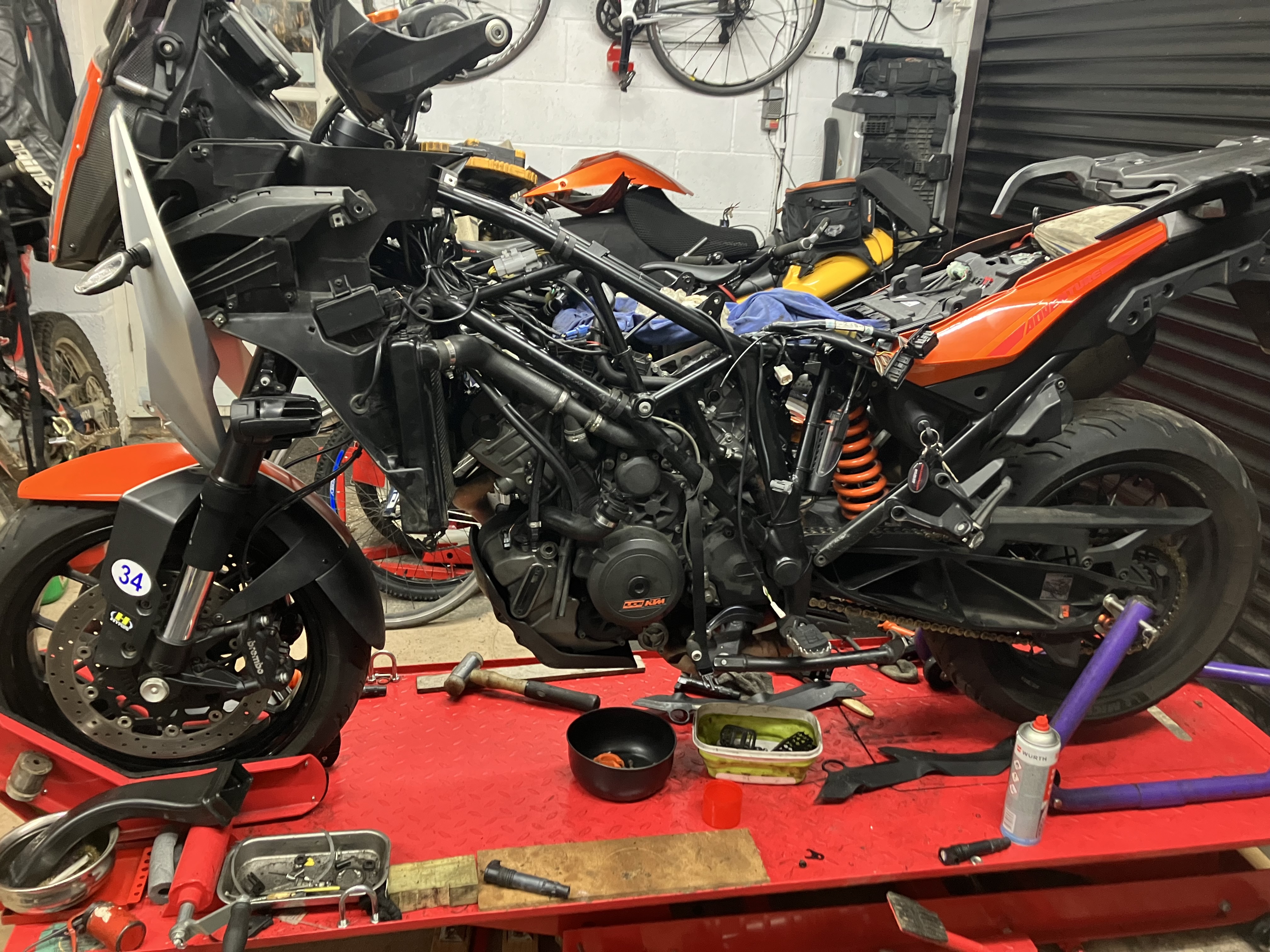

Looks slim without the tank
Naked
Naked

Flippin' 'eck man nothing holding you back Al :lol:
Some profile on those cam lobes 8O 8)
I can see though why you have decided to do the valve clearances while you're that close :wink:
I hope it all goes to plan :thumbup:
