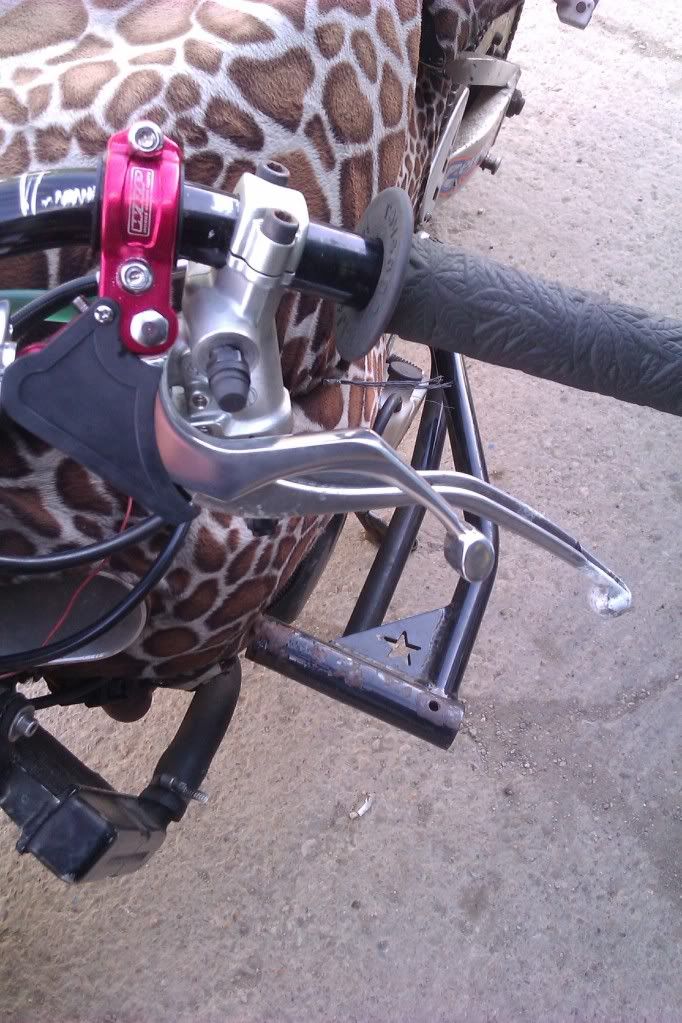

thumperslaw, Do you think I could get away with a modified VTR Clutch Master Cylinder + a Junction valve

Clutch lever don't have the right ratio of pull.
You need a radial m/c under the clutch lever. You can run line then to rear m/c but I don't think they are that good.
Later cbr,gsxr,aprill,r1,r6 all good for the job.

geodude wrote:I have been pointed in the direction of http://www.demon-tweeks.co.uk/motorcycl ... -lever-kit
HOW MUCH!!!![]()
I only need the Junction valve and I could do the rest myself.
There sh1t and don't work.
Easy pull clutch is good idea to helps arm pump stop
Dual brake set up is the only way

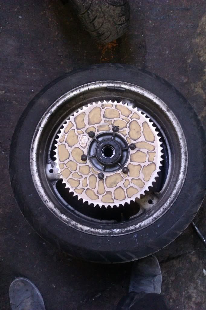

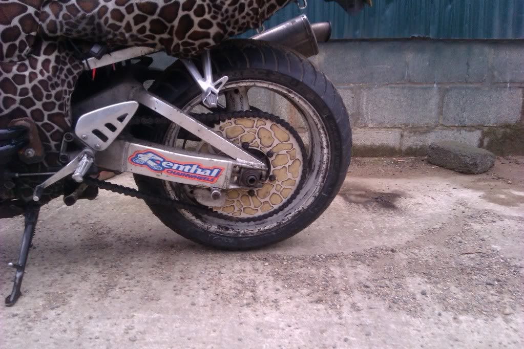

This is my sprocket set up

Re: Wheelies
Without counting, 55tooth?

Re: Wheelies
60t

Re: Wheelies
Did you jump straight onto 60t?thumperslaw wrote:60t

Re: Wheelies
Started on std gearing then went to 55t to get used to it. After that 60t
