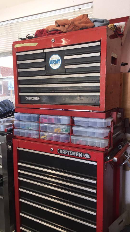

Varastorm wrote: Thu Mar 14, 2019 1:04 am Atm, I'm struggling with the wiring. I've said it was the battery box, but I was lying. it's the fecking wiring that I've been dreading.
It fecking interesting to me the things one builder dreads is one of the things I look forward to.
Envisioning a layout, planning a run, looking at it a a mechanic will in 5 years, where should there be a connector, should that wire run go there,,,,no here, oh wait that wont work, then the bars turn it will not have room.
There are metric sh1t ton of tools to do it right...and that actually appeals to me..as I like buying tools.
This old roll cab and top box is filled JUST with wiring tools and supplies
The supplies are low cost compared to other supplies and parts I buy daily. And I find it interesting and fun to solve a problem be it how to install something or diag and fix something else.
