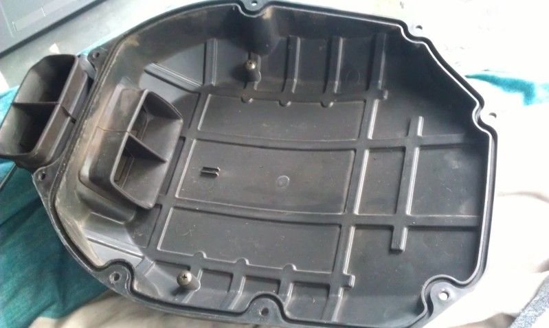

You know those ridges in the airbox lid
Would it be advantages to sand them down and smooth them out,
Also in the snorkel can you remove the plenum / divider inside it

I started to remove all the ridges from the lid and will finish it in winter then polish it smooth :-)

lloydiecbr wrote:http://www.vtr1000.org/phpBB3/viewtopic.php?t=23855
What are they there to do in the first place? is it to slow air flow on the wall of the airbox as it will be travelling faster than the air closer to that ridge that was inside the box?
Also why did Honda have that divider inside the airbox only allowing a few cm gap for air to pass over to the filter element in the first place
Was reading an article with regards to air flow dynamics and speeds etc and got me thinking about all the ridges and strange bits inside it
MCN said the straighter you can get the intake tract / snorkel the better and faster / smoother air flow to the box makes a significant improvement with regards to tuning, it went on to say this is why new bikes have such small tanks to get the intake as straight as possible underneath it
Re: Airbox modding
Sounds like you answered your own question .
Some say the ridges are their for strength but I think they are their to slow dawn air flow .
And to direct it .
The tuners now remove all lumps and bumps in the air box they spend weeks trying to make it as slippery as possible .

lloydiecbr wrote:Sounds like you answered your own question .
And to direct it .
Not trying to answer my own question mate that was my theory which to be fair are often way off the mark,
was just wondering if someone knew knew what they was genuinely there for on the roof of the lid, cant see it being strength as its not supporting the tank etc
